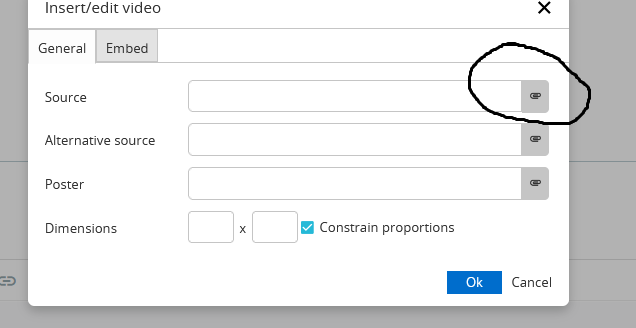

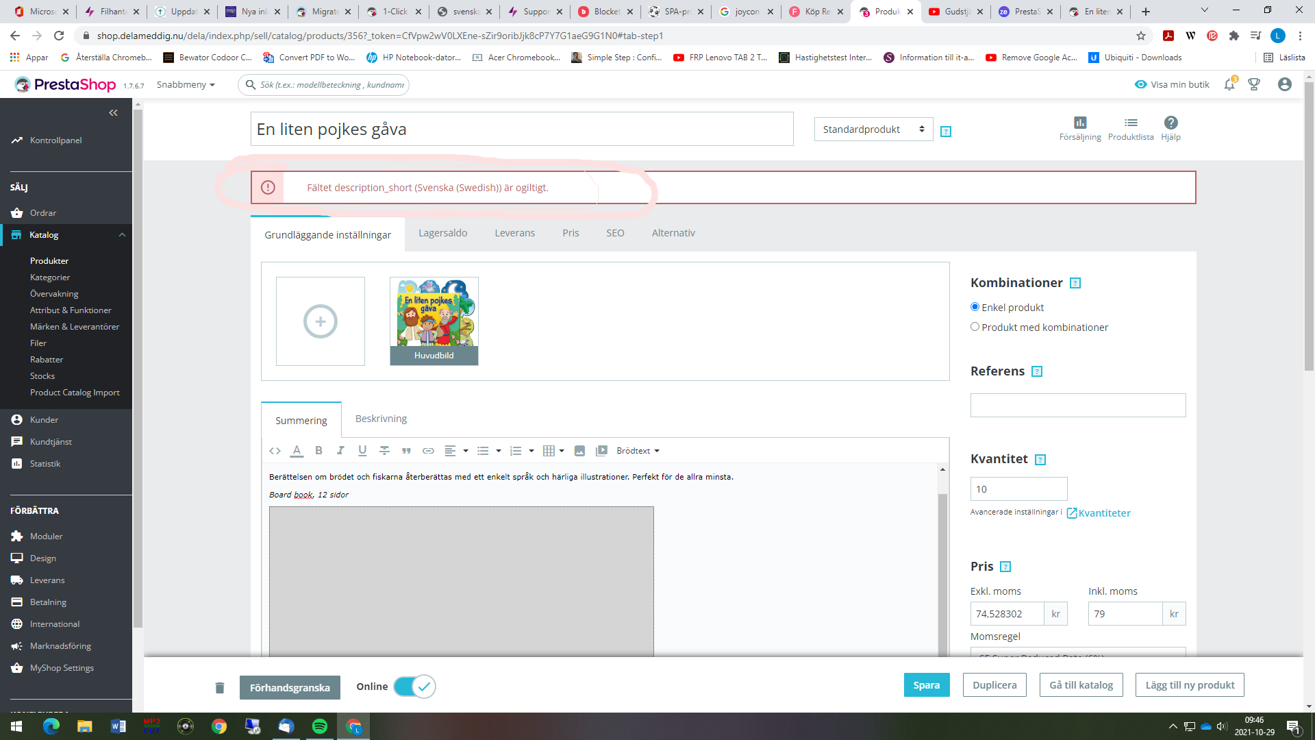

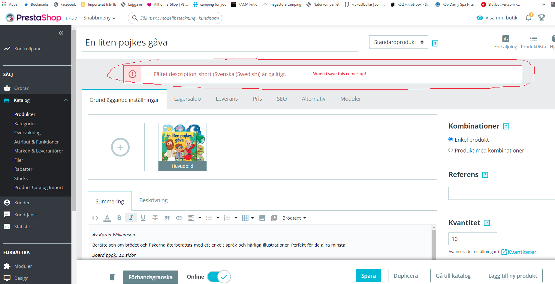

lasseboy Posted October 29, 2021 Share Posted October 29, 2021 When I try to insert a video in a product, I get this error message and it is not possible to save or move on. Someone who knows what the error is or is there any other way to get a video from eg youtube error: "The description_short (Swedish) field is invalid." Se pic Link to comment Share on other sites More sharing options...

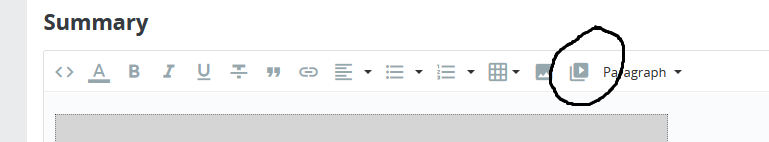

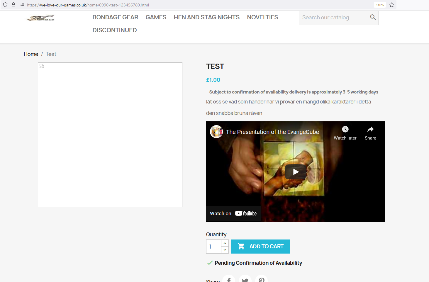

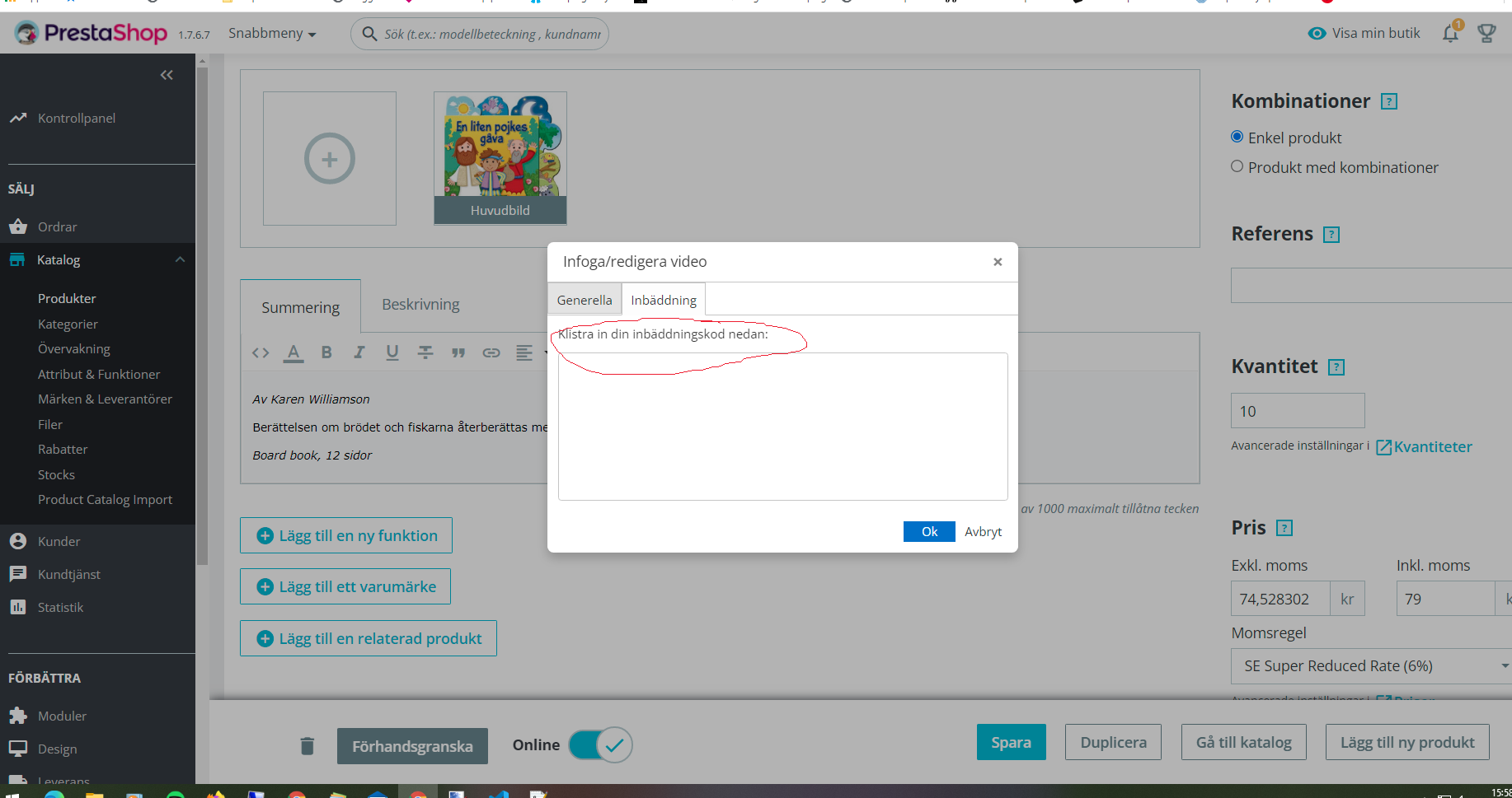

justmeagain Posted October 31, 2021 Share Posted October 31, 2021 Hi Not sure why it is not working for you - I tried your code and it worked for me Using this for the source code (found top right corner of summary - <>) <p>låt oss se vad som händer när vi provar en mängd olika karaktärer i detta</p> <p></p> <p>den snabba bruna räven</p> <p></p> <p><iframe width="560" height="315" src="https://www.youtube.com/embed/zETUh50u8Vs" title="YouTube video player" frameborder="0" allow="accelerometer; autoplay; clipboard-write; encrypted-media; gyroscope; picture-in-picture" allowfullscreen="allowfullscreen"></iframe></p> As for another way to do it try this In summary bar go to the Video tab Select Embed tab and paste it there click Ok and Save and hopefully it will work Good luck 1 Link to comment Share on other sites More sharing options...

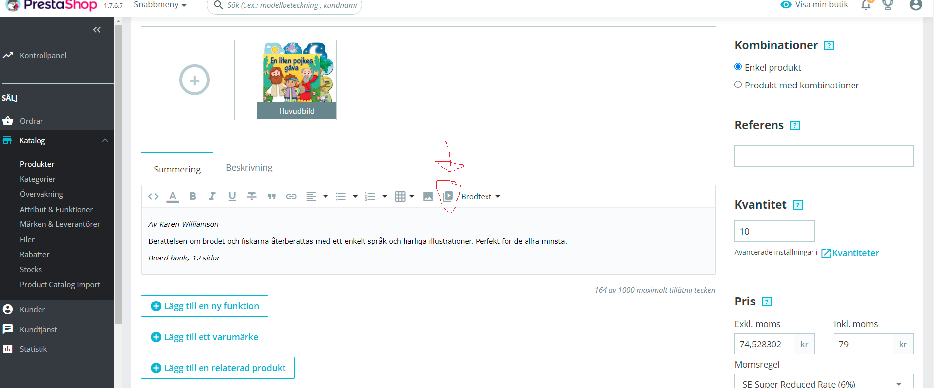

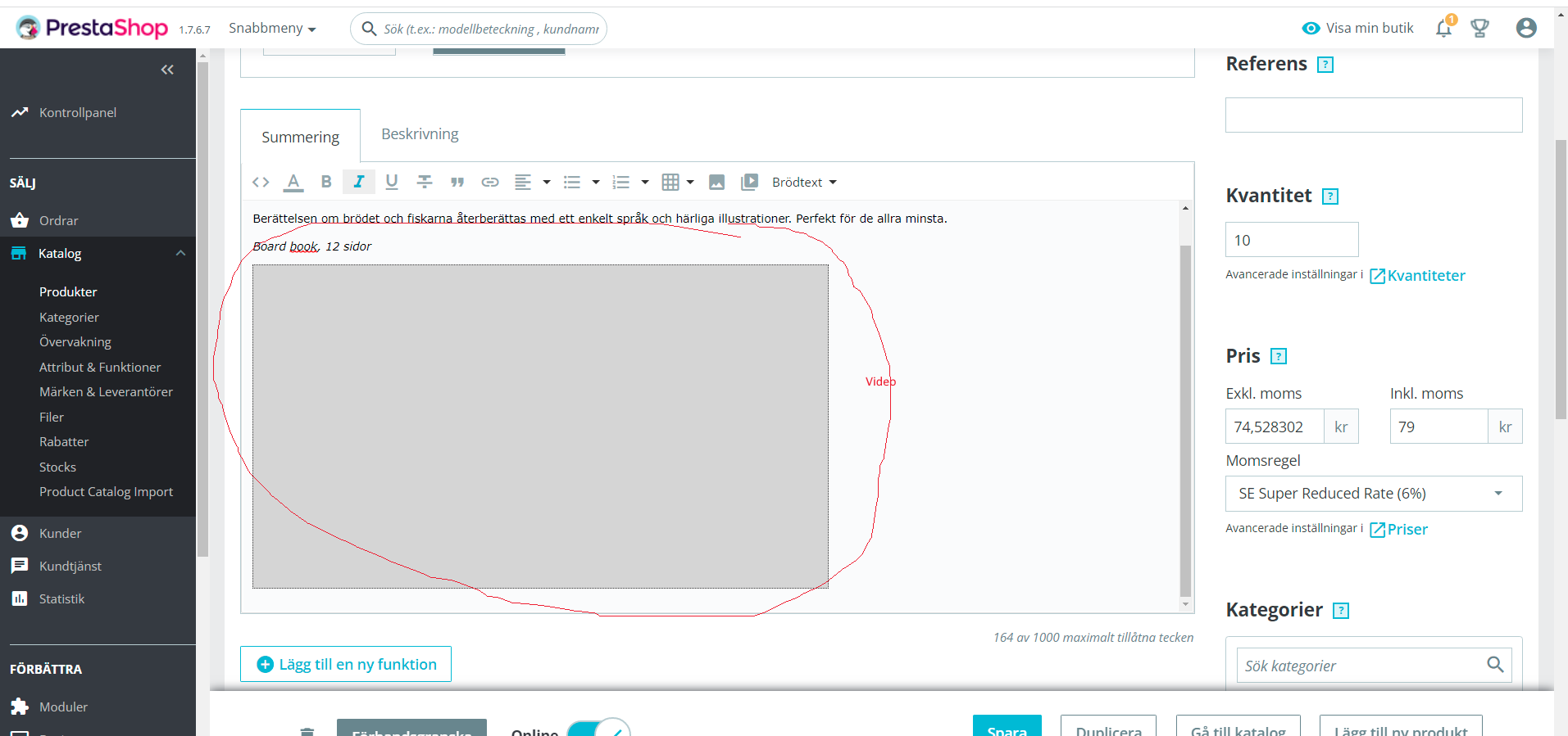

lasseboy Posted October 31, 2021 Author Share Posted October 31, 2021 This is how I do it and it will be wrong " The error message is The description_short (Swedish) field is invalid. Must be wrong in the classic theme, which file is what creates the text in the box and the movie embedding may be enough to replace it with a fresh file. Link to comment Share on other sites More sharing options...
lasseboy Posted October 31, 2021 Author Share Posted October 31, 2021 Oops the pictures came in the wrong order. the first image is at the bottom and then up!"😄 If you did not do as I did, how did you enter the code? Link to comment Share on other sites More sharing options...

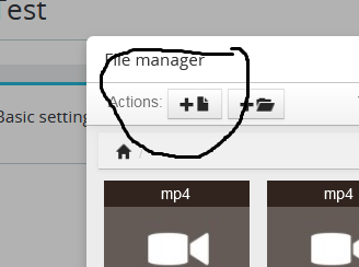

justmeagain Posted October 31, 2021 Share Posted October 31, 2021 I too use the classic theme so not sure why the description saves but not the video Have you tried just the video on its own without the text? Anyway - couple more options (then I'm out of ideas - sorry) Try making the listing again under a different ID - no idea if makes any difference but worth a try. Alternatively - assuming you have the video on your PC/laptop (or can download it) Try the sequence of photos, navigate to video - wait for ti to upload - click it to add the source code - set the dimensions and save - and fingers crossed Link to comment Share on other sites More sharing options...
