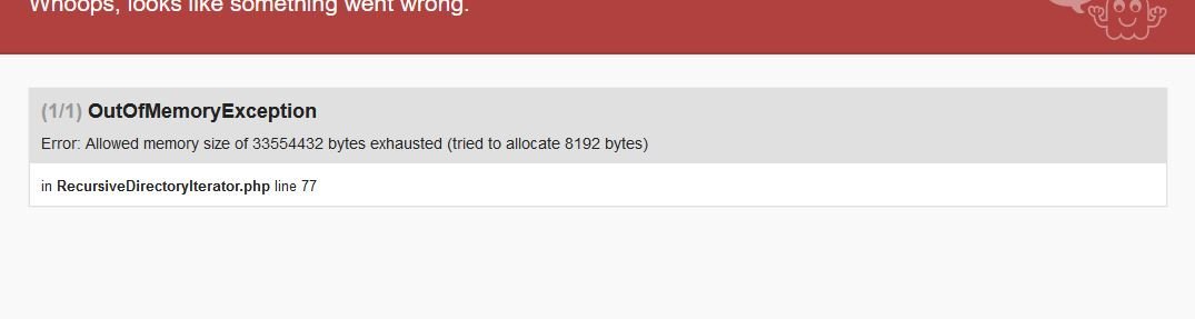

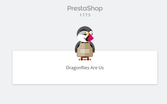

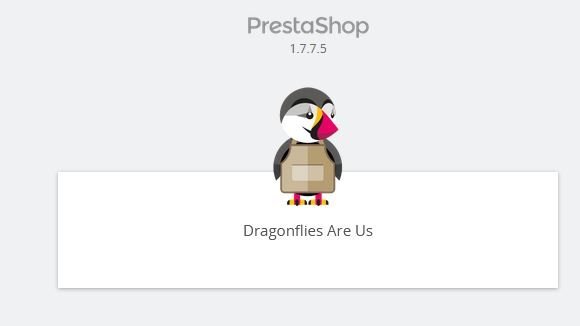

rmturner Posted August 5, 2021 Share Posted August 5, 2021 (edited) I've been searching and can't find anything that has worked so far. I installed the new version 1.7.7.5 and everything worked fine for two weeks. I had six categories and had filled one of them with 40 products and another with 30 products before everything went dead. Weirdly, the two categories that have all the products in them are "empty" but the basic page loads. Thanks in advance.... https://www.dragonfliesareus.com/4-dragonfly-earrings Categories that have nothing in them seem to work: https://www.dragonfliesareus.com/5-dragonfly-necklaces The home page is blank and I can't login to the backend. I'm attaching screenshots Edited August 6, 2021 by rmturner (see edit history) Link to comment Share on other sites More sharing options...
Rhobur Posted August 6, 2021 Share Posted August 6, 2021 What is the max_memory_limit on your server and what memory reports Advanced Preferences->Performance? Judging from the screenshot you don't have enough memory available. Link to comment Share on other sites More sharing options...
SmartDataSoft Posted August 6, 2021 Share Posted August 6, 2021 @rmturner Please try to increase the memory limit to 512mb then try. Thank you Link to comment Share on other sites More sharing options...
rmturner Posted August 6, 2021 Author Share Posted August 6, 2021 Thanks guys. I had been looking all over for my php.ini and couldn't find it. I called my host and they said that it hadn't been set as a feature in my account. He said that the php.ini had been set at 32M, which was the whole problem. Now it's at 256M and the site is working fine. Thanks so much. I'm sorry, I have forgotten how to mark this SOLVED. Link to comment Share on other sites More sharing options...

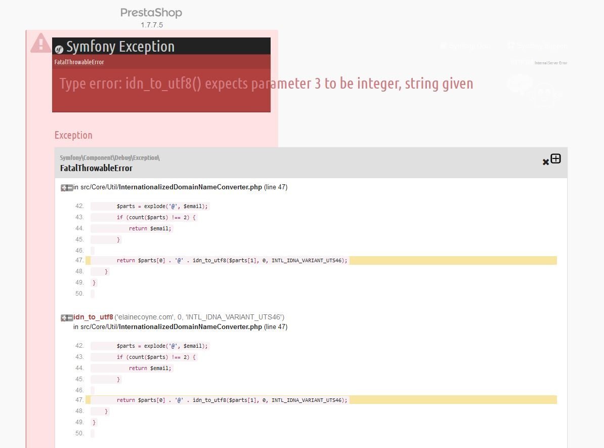

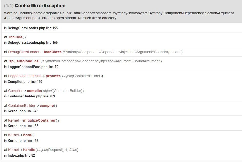

rmturner Posted August 6, 2021 Author Share Posted August 6, 2021 I spoke too soon. Now the site works fine but I can't get into the backend. Debugging shows this: Strangely, I don't have those files anywhere. I also checked the prestashop 1.7.7.5 files I have on my hard drive. Link to comment Share on other sites More sharing options...
SmartDataSoft Posted August 6, 2021 Share Posted August 6, 2021 Hello, are you using php 7.3 or it is above. Clear the cache from /var/cache/dev and /var/cache/pro Manually via ftp and check again Thank you 1 Link to comment Share on other sites More sharing options...

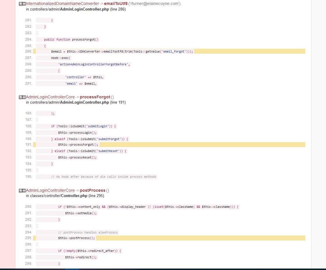

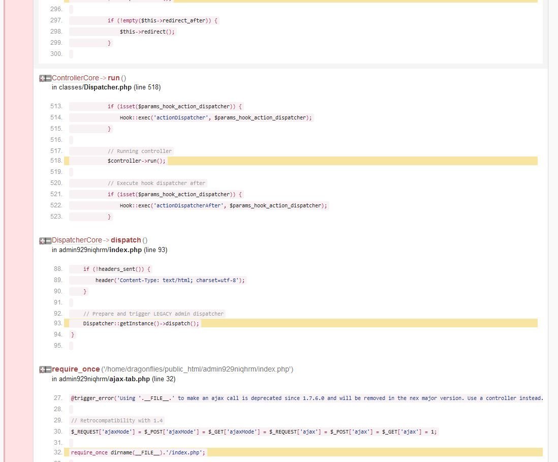

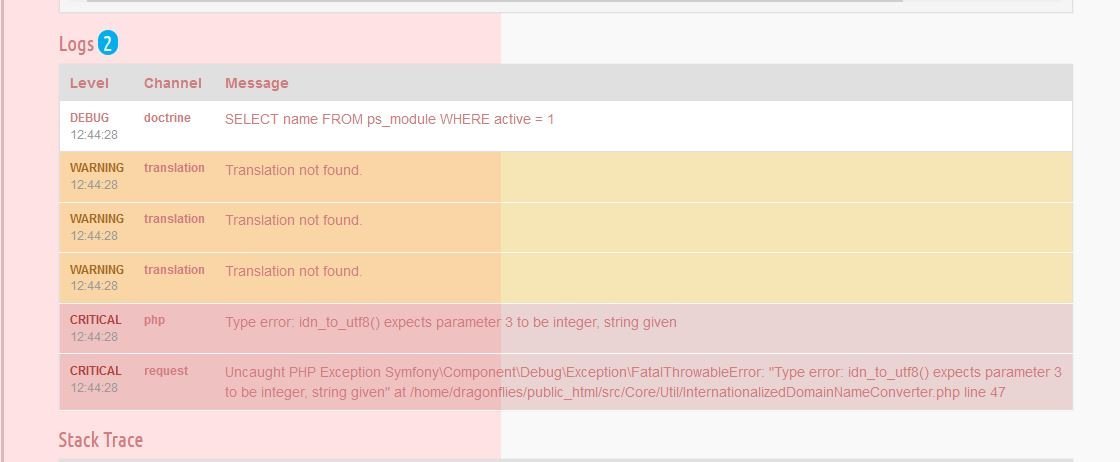

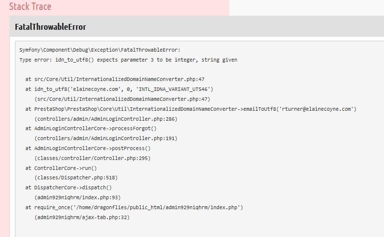

rmturner Posted August 6, 2021 Author Share Posted August 6, 2021 Thank you. The php version is 7.1 My admin URL is https://www.dragonfliesareus.com/admin929niqhrm/ I couldn't reproduce any errors trying to login, as it just didn't login. But when I clicked on "Don't remember password" I got a ton of Symphony errors: Link to comment Share on other sites More sharing options...
rmturner Posted August 6, 2021 Author Share Posted August 6, 2021 SOLVED.....I renamed my .htaccess to .htaccess_backup and I then was able to login to my back office. I went to Shop Parameters/SEO and URLs and recreated a new .htaccess by turning Friendly URLs off, saving and then turning it back on. Thank you SmartDataSoft for all your help! Link to comment Share on other sites More sharing options...
