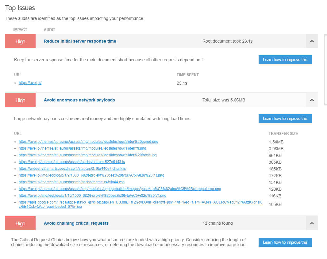

Hello! After import (although the import itself did not affect it immediately), according to GTMetrix, the loading time of the home page takes 27.2 seconds. I would like to add that there are 4300 products on the page, and all other pages are loading acceptable (about 3.6 seconds)
I attach a photo from GTMetrix

those 3 .png pictures inside your full page slide are nonsense. Avoid to use .png. Find an appropriate image compression format.
Then you have problems with facebook/facebook embed things. The content is prohibited from being displayed within an IFRAME due the Content Security Policy being set, check browser console.

First reduce the image sizes which improves the website speed. Also check the third party installed modules but one by one (disable one and check the speed again). Hopefully you find the module which decrease the speed.
If you are not able to found the solution, you just share you page.
