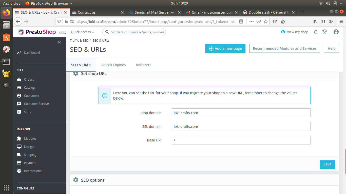

The first page to look is Settings -> SEO&Urls.
I found the block in the picture, deleted the "/" in the "Base URI" and it came back. Nothing on the 2 domain lines.

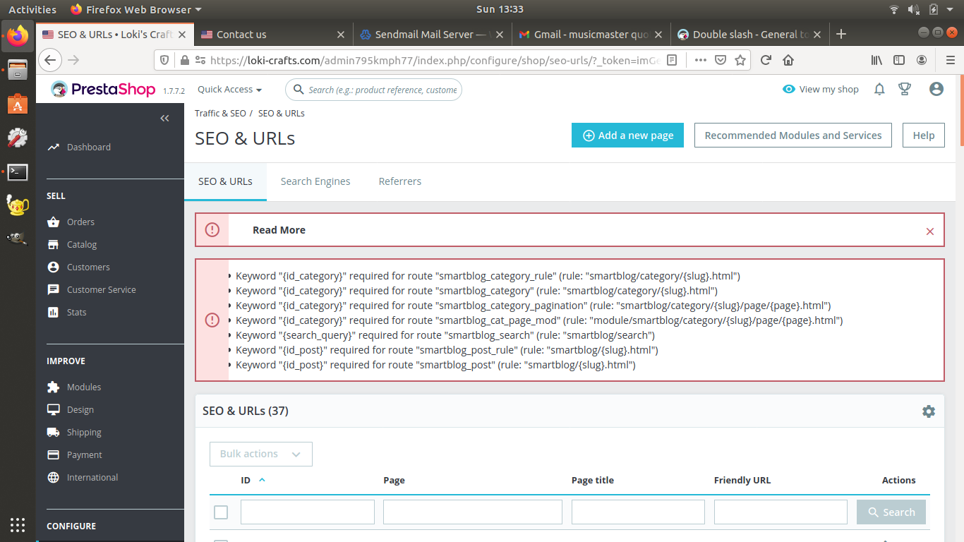

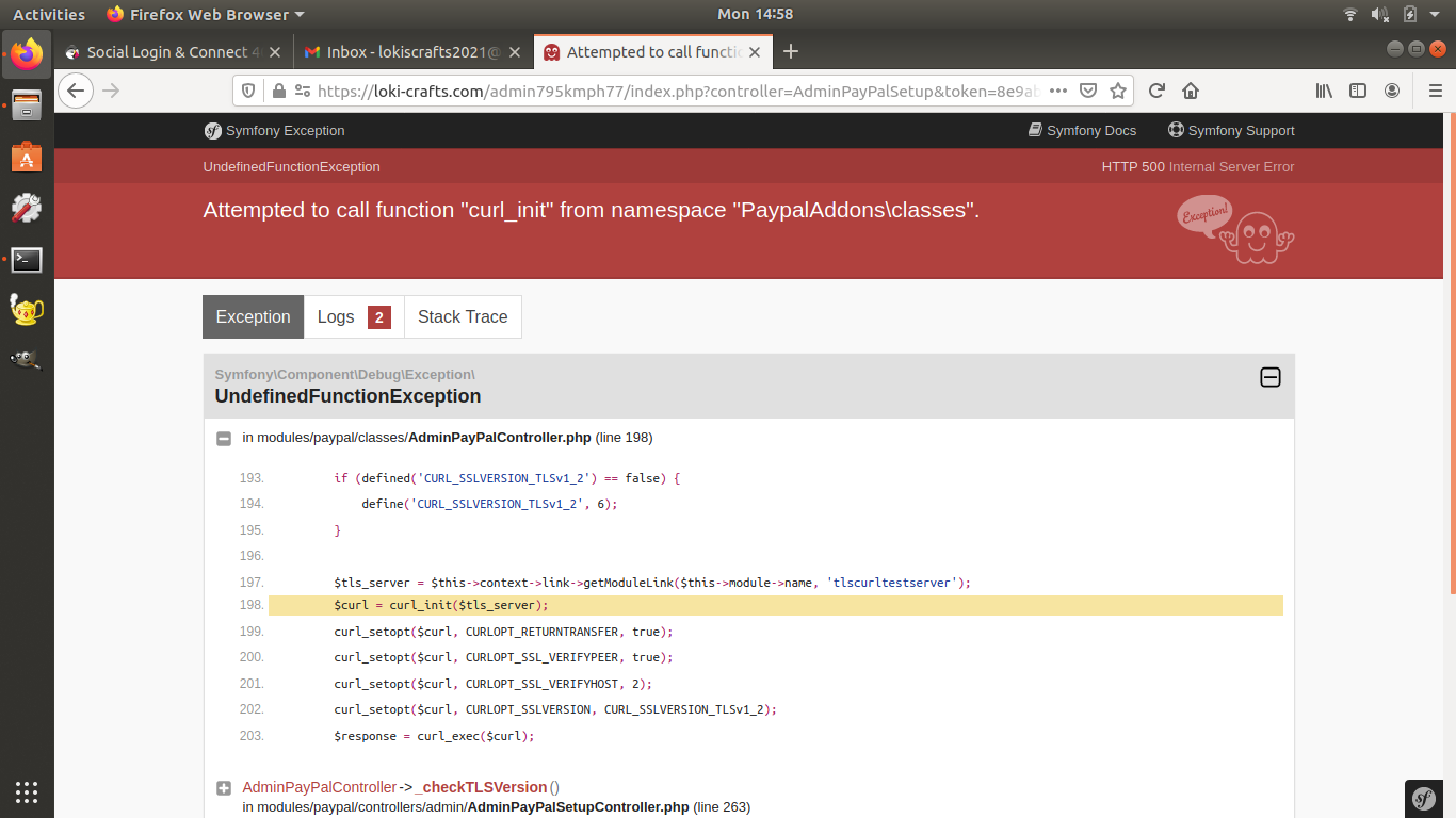

It seems that it upgraded php to version 8 and now I have errors all over the place. The latest is the PayPal lost the curl.
Prestashop 1.7.7 isn't even fully compatible with PHP 7.4. So trying 8.0 is a waste of time.

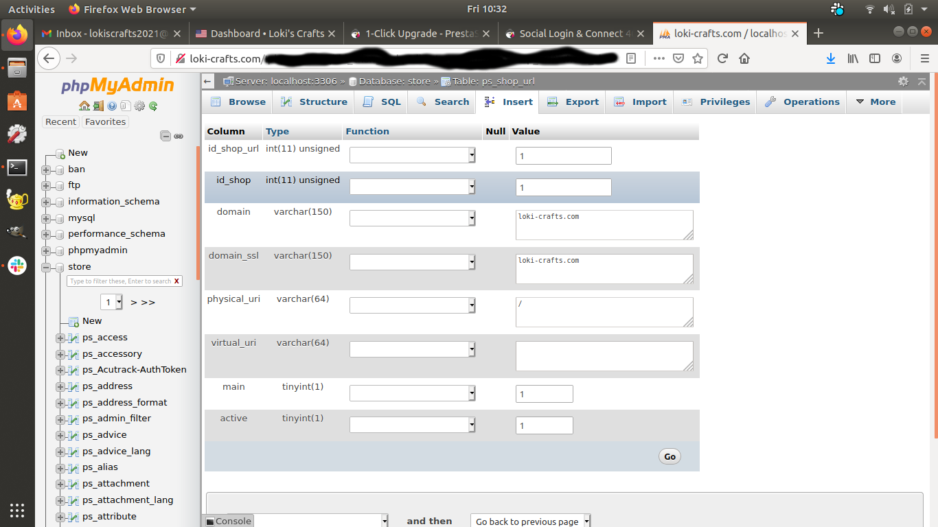

Problem was solved at long last. In the ps_shop_url the database had an extra slash. Many thanks goes to Pululu K for the fix that toke less time then to install Slack. For anyone else that has this problem, remove the / from virtual_uri.
