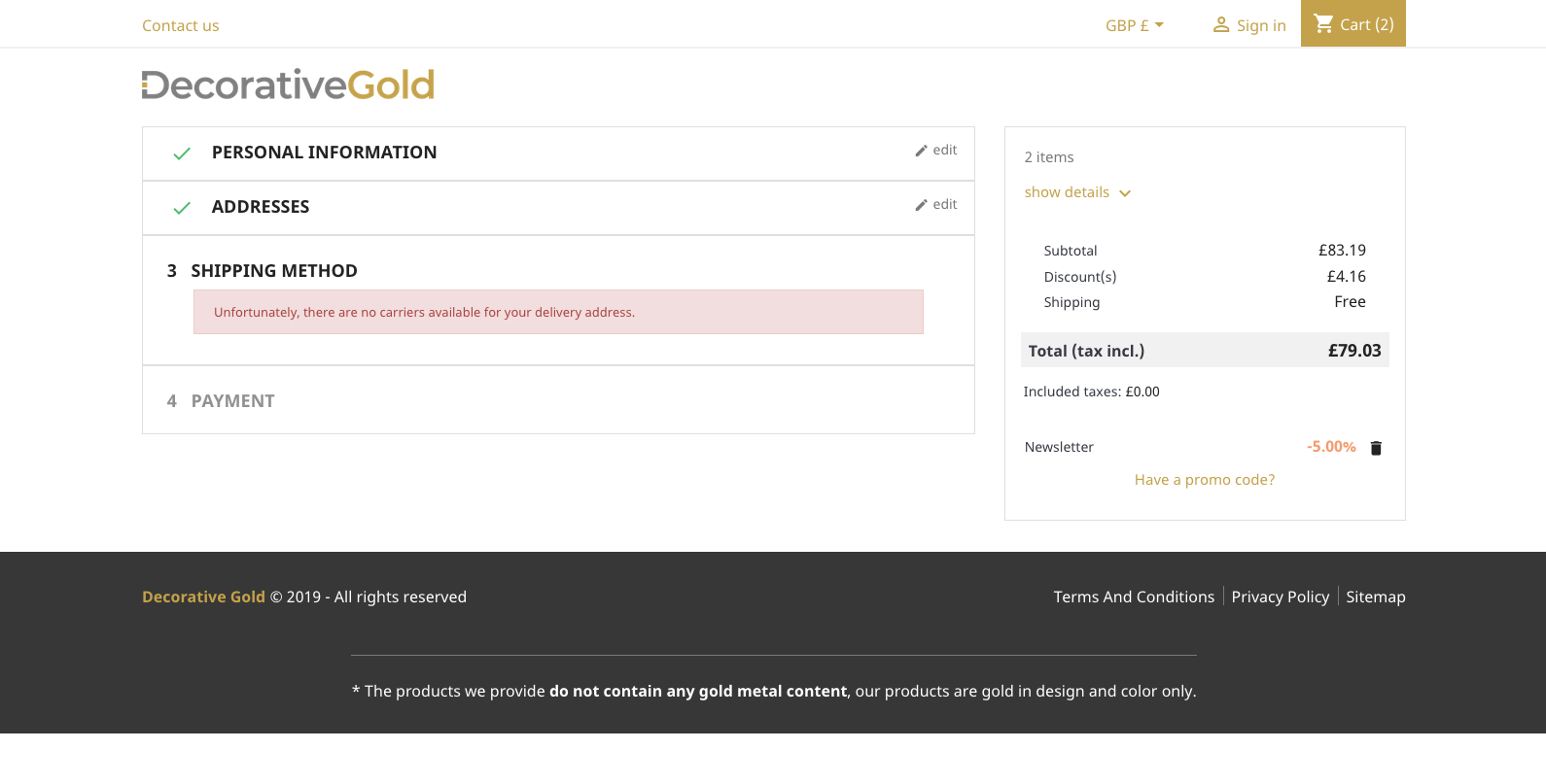

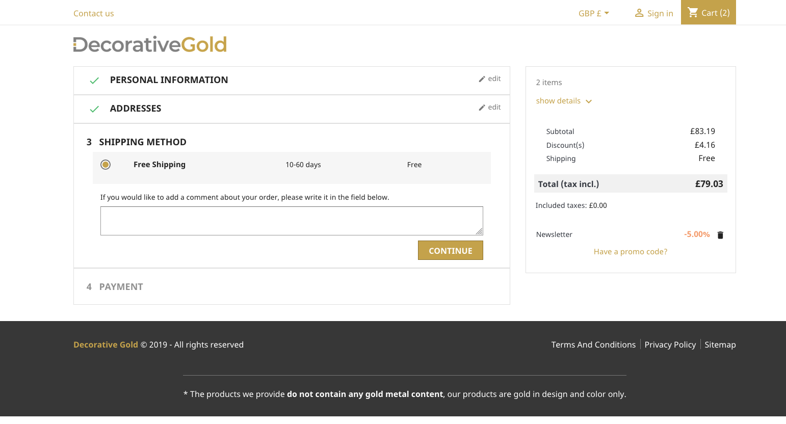

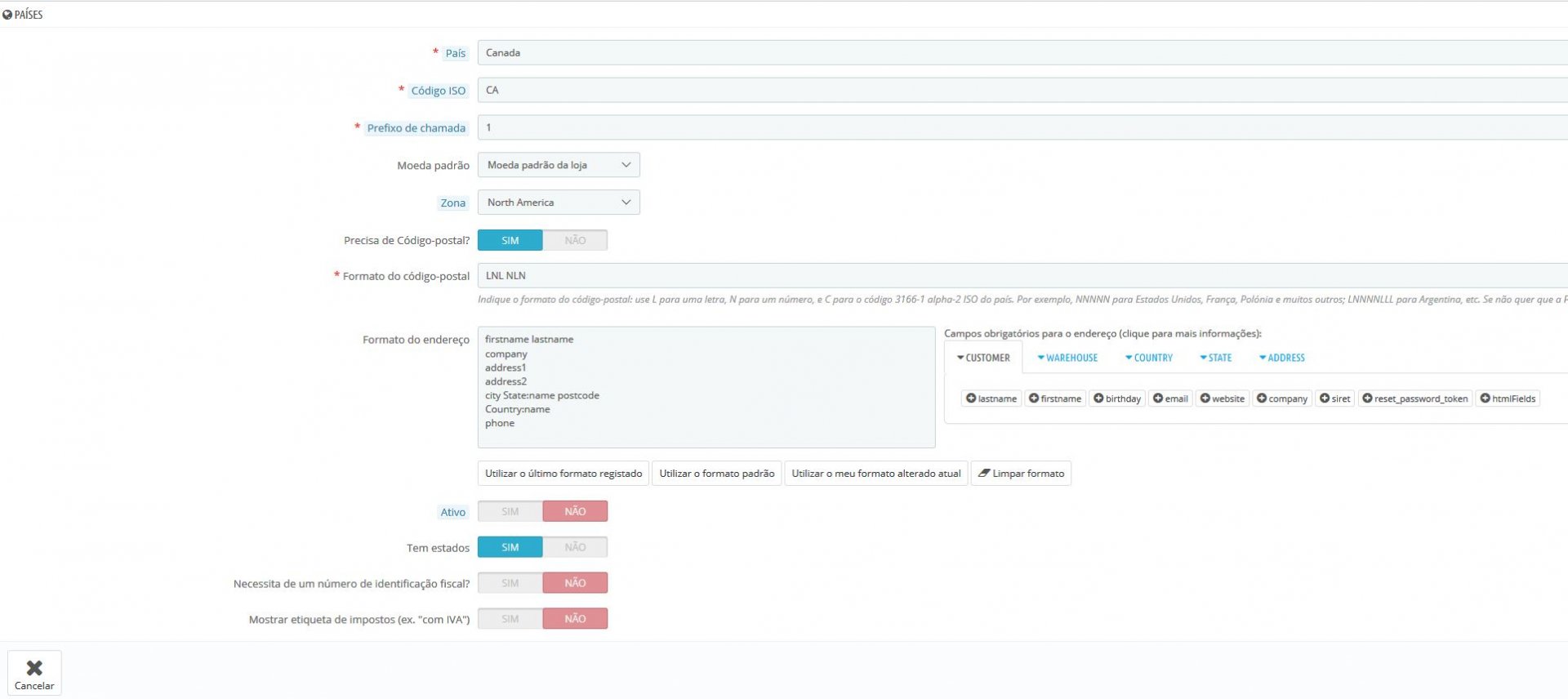

zomex Posted November 18, 2019 Share Posted November 18, 2019 Hello everyone, I have about 30 countries activated on my prestashop and 1 carrier which is free shipping. Every country is working apart from Canada & Australia. Both countries show the error: Unfortunately, there are no carriers available for your delivery address. I have made sure these countries are activated and that the area is assigned to the carrier without luck. Screenshots attached for a working country and Canada which shows the error. Any assistance is greatly appreciated. Thanks, Jack Link to comment Share on other sites More sharing options...
PCQUATRO Posted November 18, 2019 Share Posted November 18, 2019 Have you tried changing the zone of those countries or resave them? Best regards 1 Link to comment Share on other sites More sharing options...

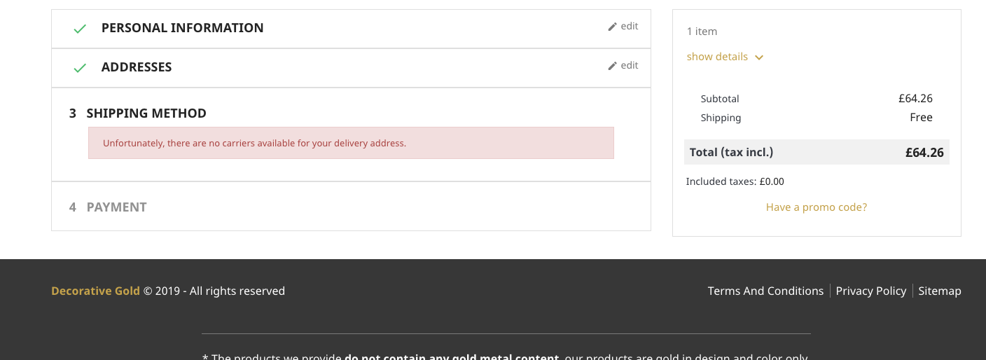

zomex Posted November 19, 2019 Author Share Posted November 19, 2019 (edited) 47 minutes ago, PCQUATRO said: Have you tried changing the zone of those countries or resave them? Best regards Hello my friend, I have just tried this and the same issue remains: - went to international > locations > deactivated and re-activated the zone - went to international > locations > countries > changed the zone and de-activated/re-activated Thanks Edited November 19, 2019 by zomex (see edit history) Link to comment Share on other sites More sharing options...
PCQUATRO Posted November 19, 2019 Share Posted November 19, 2019 Is the address you are using correct!? Have you tried to delete and recreate the country?? each country has it´s own settings, have you tried to replicate the settings of a working country, and that change one field at a time to see what´s the problematic one?? could it be that that test could only be done on those countries!!! Best regards Link to comment Share on other sites More sharing options...
zomex Posted November 19, 2019 Author Share Posted November 19, 2019 12 hours ago, PCQUATRO said: Is the address you are using correct!? Have you tried to delete and recreate the country?? each country has it´s own settings, have you tried to replicate the settings of a working country, and that change one field at a time to see what´s the problematic one?? could it be that that test could only be done on those countries!!! Best regards I have just tried a real address, same issue. I don't see the benefit of deleting and re-creating the country as this could create more problems. Nothing has changed within Prestashop but it is strange that it only effects these 2 countries. I have also tried deleteing and re-creating the carrier. Link to comment Share on other sites More sharing options...

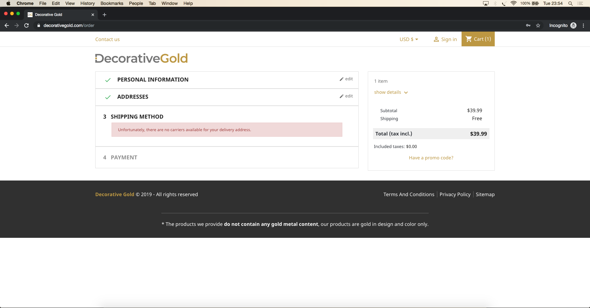

zomex Posted November 19, 2019 Author Share Posted November 19, 2019 (edited) 1 hour ago, El Patron said: please disable the use of native geo location, only enable if you know what you are doing, when you know what it does you would not then use it lol then use incognito window (no cookie or other cache) and retest. Thanks for the suggestion. I have turned off geo location and re-tired in incognito mode and the same issue remains 😢 Edited November 20, 2019 by zomex added image (see edit history) Link to comment Share on other sites More sharing options...

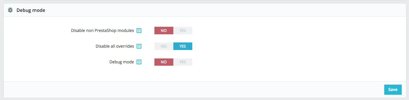

zomex Posted November 21, 2019 Author Share Posted November 21, 2019 8 minutes ago, MichaelEZ said: Sorry to hear that, i know it can make u feel flustrated.. Can u try disabling overrides in? Well we hade similar problems with ps, so we deceded to go for TB. No regrets so far. I have tried disabling overides but same issue (see attached). What is TB? I have been considering Magento but that is very complicated and bloated software. PrestaShop is a real shame, I put so much time into building this website only to find that there are so many issues with the software. I have experience developing for and using a lot of different software (WordPress, WHMCS, Blesta, Clientexec, vBulletin, MyBB) and PrestaShop is by far the worst in terms of bugs and reliability. It's a big shame because there is a lot of positives to Prestashop, it's very nice and easy to use, not bloated, good community and use. There just seems to be more focus on selling modules than there is providing a bug free base product. Link to comment Share on other sites More sharing options...

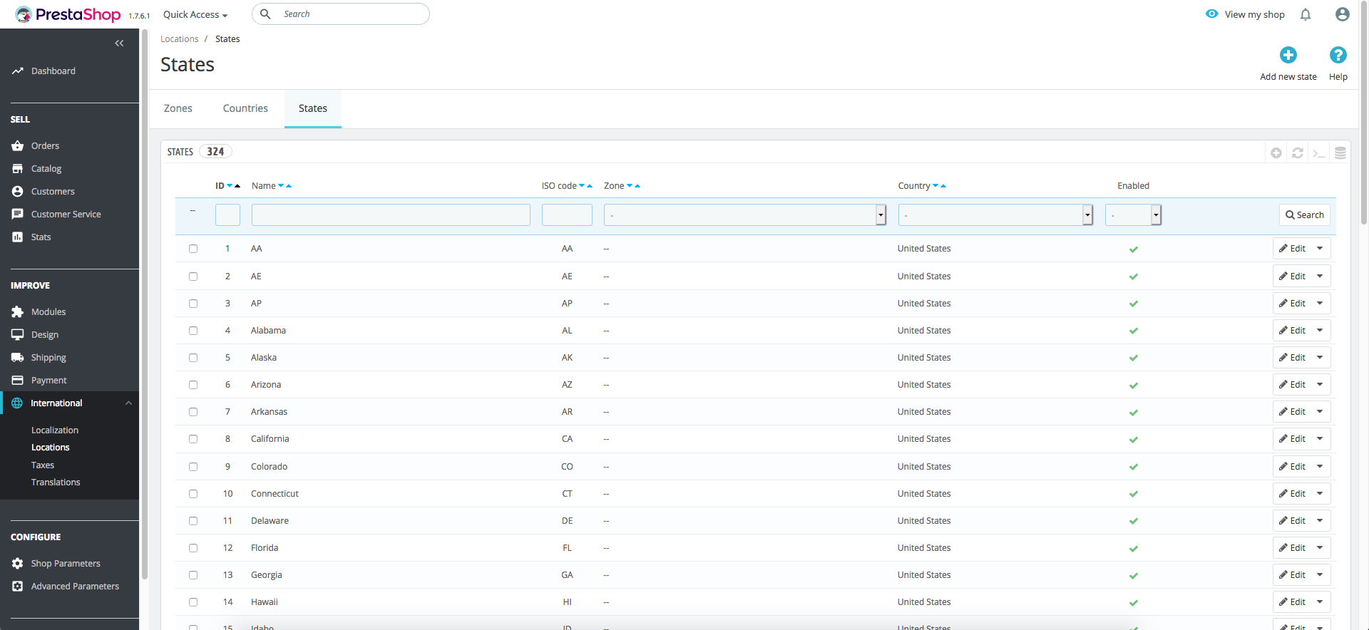

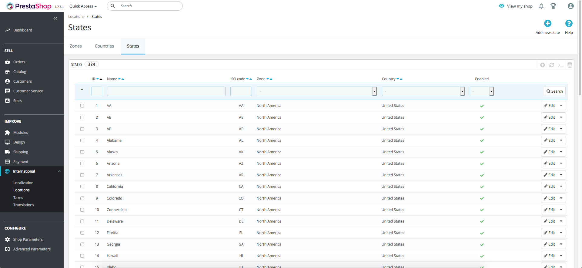

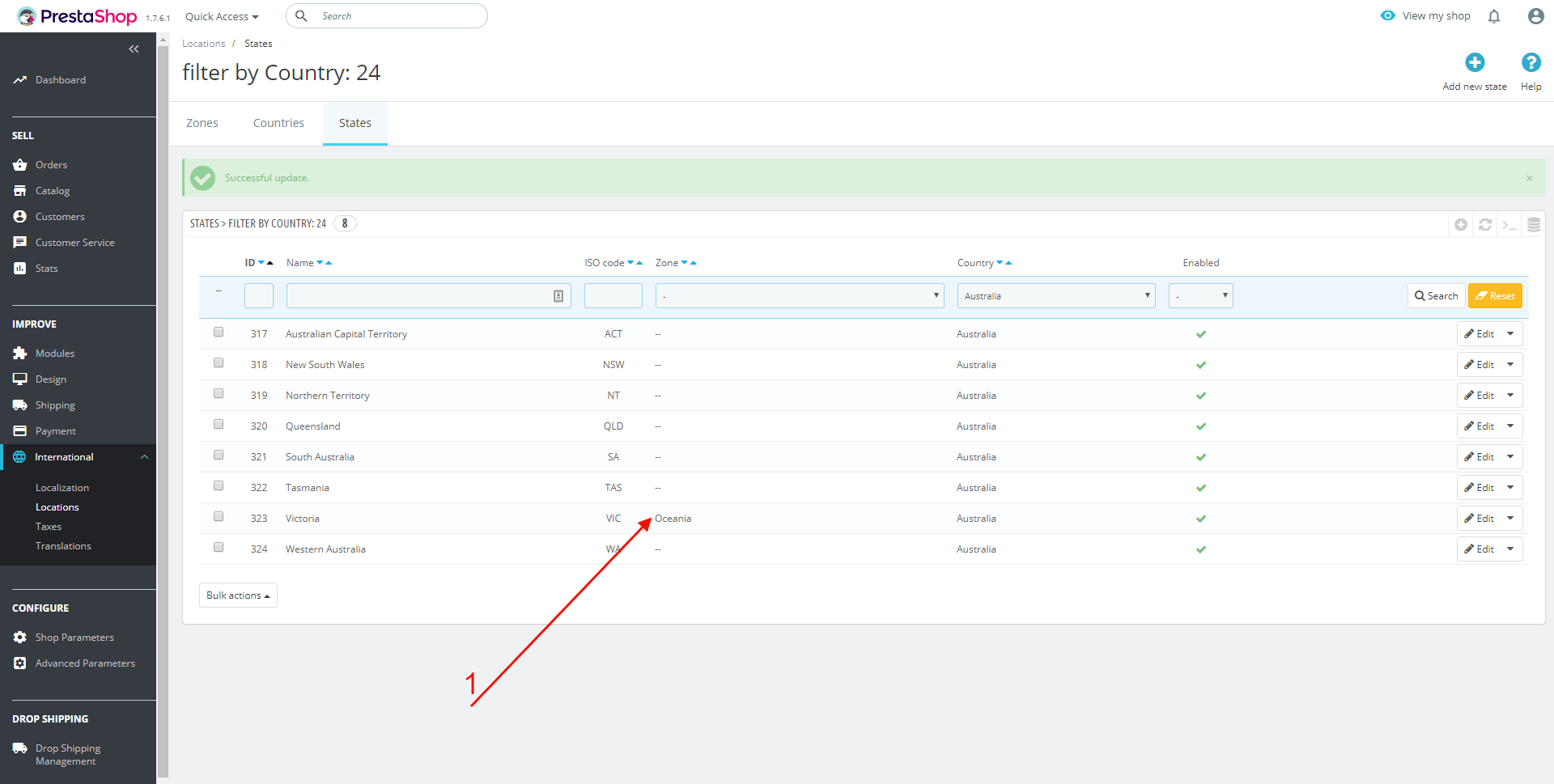

razaro Posted November 21, 2019 Share Posted November 21, 2019 Hi you need to apply zone to each state of Canada and Australia. That is something that should have been set by default maybe a bug. I changed just one state that I have set test address. Hope this helps. 2 Link to comment Share on other sites More sharing options...

zomex Posted November 21, 2019 Author Share Posted November 21, 2019 7 hours ago, razaro said: Hi you need to apply zone to each state of Canada and Australia. That is something that should have been set by default maybe a bug. I changed just one state that I have set test address. Hope this helps. Many thanks! I manually set the zone for all states and the carrier is working for all countries! 1 Link to comment Share on other sites More sharing options...
