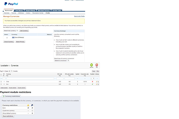

YanK1973 Posted July 24, 2014 Share Posted July 24, 2014 (edited) Using Prestashop 1.5.4.1 and Paypal 3.7.1 module Website Payments standard. Issues: 1) Shop's default currency is EUR but costumer sees Paypal order summary in USD. Settings in attached image. 2) After payment costumer is not redirected back to shop. In Paypal account settings auto return is off and there is not a return URL set, is this the reason for it and if yes what would be the return URL? 3) In Back office the order status stays Pending payment confirmation.or some other message but certainly not payment confirmed or accepted, i get informed about payment from Paypal emails only, not from Prestashop and then manually change order status to payment accepted. Thank you in advance. Edited July 26, 2014 by yanc (see edit history) Link to comment Share on other sites More sharing options...
bellini13 Posted July 25, 2014 Share Posted July 25, 2014 Issues: 1) Shop's default currency is EUR but costumer sees Paypal order summary in USD. Are you sure the customer has selected EUR currency during checkout? This has nothing to do with the currencies in your paypal profile. 2) After payment costumer is not redirected back to shop. In Paypal account settings auto return is off and there is not a return URL set, is this the reason for it and if yes what would be the return URL? You will need to provide a screen shot showing what the page looks like after the customer has paid using paypal. If auto return is off, then the customer has to click a link to return to your store. 3) In Back office the order status stays Pending payment confirmation.or some other message but certainly not payment confirmed or accepted, i get informed about payment from Paypal emails only, not from Prestashop and then manually change order status to payment accepted. It will remain this way unless the customer returns to your store, so if you address issue #2, then this issue should go away Link to comment Share on other sites More sharing options...
YanK1973 Posted July 25, 2014 Author Share Posted July 25, 2014 Hello Bellini13 and thanks for answering. 1) There is no other currency option in website available to costumers, everything is set to EUR. 2) As costumers reported is just a blank page after payment. Link to comment Share on other sites More sharing options...
bellini13 Posted July 26, 2014 Share Posted July 26, 2014 If the customer is seeing a blank white page, that means they are being redirected back to your store. You need to enable debug mode so that you see an error message instead of the white page. you can search the forums for how to accomplish that Link to comment Share on other sites More sharing options...
