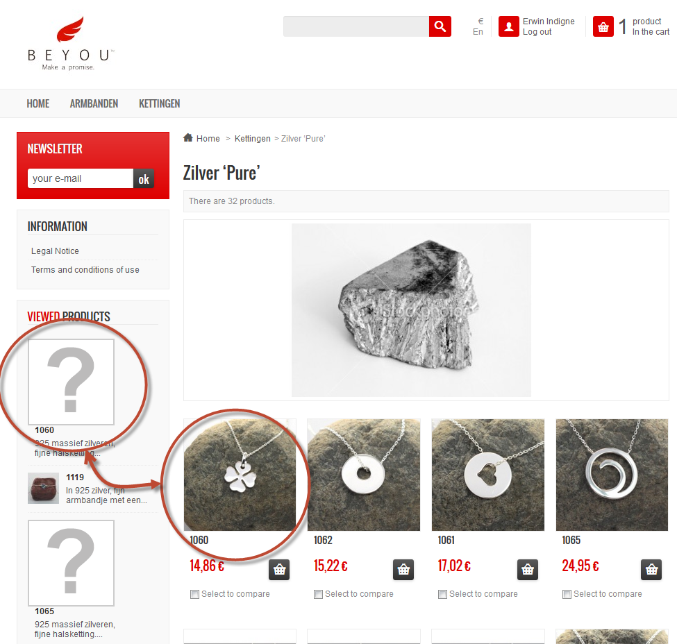

I'm running PS 1.5.4.1, and I just bumped into a strange problem.
If I upload 2 or more pictures per product, then for some products (not all of them) they show a question mark in the module.
I cleaned smarty cache already and img temp. regenerated the .htaccess file (by switching multistore on and off)
But still no luck.
I have the impression that certain pictures dimensions cause this problem, but i can be totally wrong here.
Strange part is, when I switch both pictures (from cover priority) then it works properly, but if I switch back I get the question mark back. Deleting and reloading pictures does not help either.
Problem is, I'm talking about a lot of products that suffer this problem.
Anyone an idea how to resolve this?
See attached files:
Edited by kmxorbit (see edit history)
Can you check where the missing image points to? (I.e what is the URL of the missing picture?)
Also, when you change the order of the pictures as you mentioned above and the picture shows correctly, what is then the URL of the shown picture?
You site isn't live yet, right? If it is, please provide link.

Hi,
It's a live site for a client and he discovered it just now.
I also have a test site (on subdomain of it) which encounters the same problem.
http://test.beyoujew.../en/6-kettingen
Please visit some products, then check the viewed products.
Some will show question marks.
The strange part is, although all pictures are squares, they did not have the same pixel size. Can that be a reason for this behaviour?
The links for each picture seem to show the correct links. I just don't get it...

Actually I just found a solution on Issue Tracker (http://forge.prestas...owse/PSCFV-8973). If you have the same issue try changing line 108 of blockviewed.php from
LEFT JOIN '.DB_PREFIX.'image i ON (i.id_product = p.id_product)'.
to
LEFT JOIN '.DB_PREFIX.'image i ON (i.id_product = p.id_product AND i.cover = 1)'.
Edited by gkorolkov (see edit history)

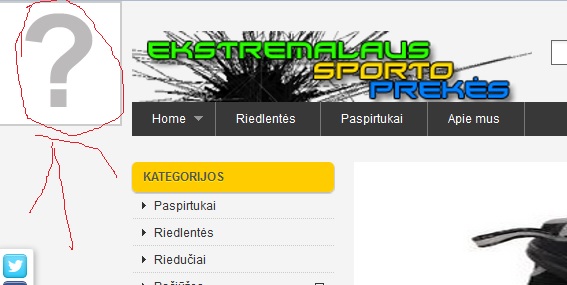

Ok... My code is in line 295 and not in line 108 but that doesn't matter (I think).
As I can se i have ...AND i.cover = 1)... but it's not working.
PLUS!
In BO/Modules/Floating viewed.../Configuration - works only number of products to display. Enable/disable and Position is not working/no effect.
- Float Enable - in LiveEdit I can move block only up/down on left side of column (if I chose position - nothing)
- Float Disable - I choose position - nothing.
HELP? :(
