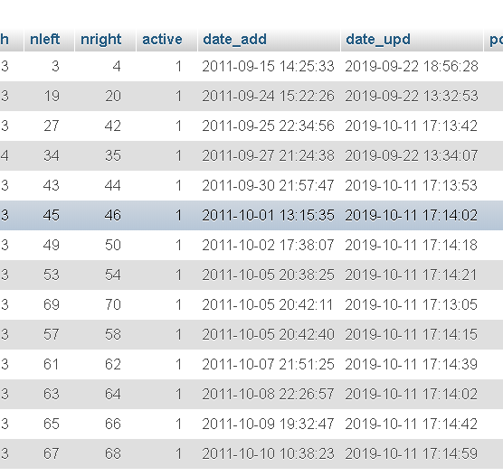

stsoft Posted November 30, 2019 Share Posted November 30, 2019 Problem can be caused by invalid date format in ps_category columns date_add and date_upd Link to comment Share on other sites More sharing options...

stsoft Posted January 24, 2020 Share Posted January 24, 2020 Provide screenshots of your ps_category table? It will be good if in screenshot we can see the category you try to edit. Link to comment Share on other sites More sharing options...
