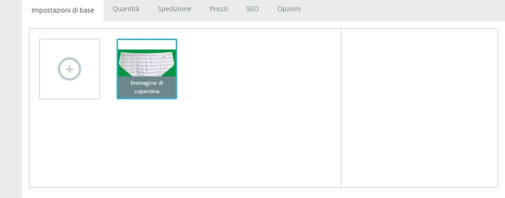

rb10 Posted November 5, 2018 Share Posted November 5, 2018 Hi, in my prestashop version 1.7.4.2 not have a button and form in image product for delete image. I have always reload all admin folder files, but problem persist, do u have any solution? thanks Link to comment Share on other sites More sharing options...

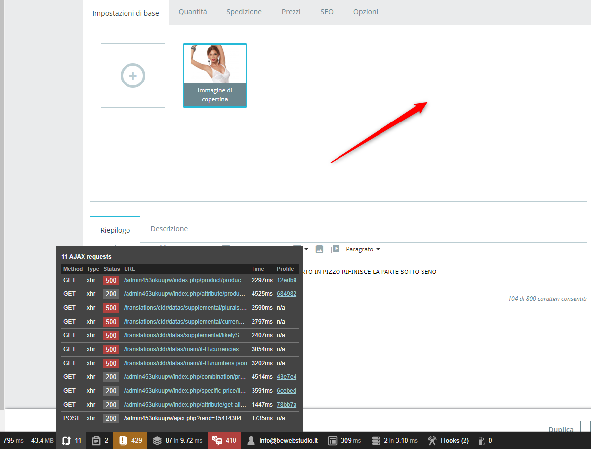

rb10 Posted November 5, 2018 Author Share Posted November 5, 2018 58 minutes ago, JBW said: Clicking on the image should open a new menu on the right side with options to set the description and deletion button. If this does not appear when you click the image can you check in you browsers console if there are any javascript errors? when i click on image appear blank without any content inside Link to comment Share on other sites More sharing options...
PrestaHeroes.com Posted November 5, 2018 Share Posted November 5, 2018 Just now, rb10 said: when i click on image appear blank without any content inside enable PrestaShop debug mode, search if you are not sure how. then the blank screen should have error message. Link to comment Share on other sites More sharing options...

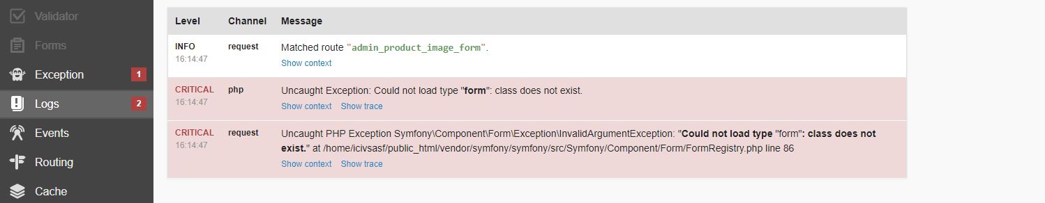

rb10 Posted November 5, 2018 Author Share Posted November 5, 2018 3 minutes ago, El Patron said: abilita la modalità di debug di PrestaShop, cerca se non sei sicuro di come. quindi lo schermo vuoto dovrebbe avere un messaggio di errore. here the screen of debug mode Link to comment Share on other sites More sharing options...
PrestaHeroes.com Posted November 5, 2018 Share Posted November 5, 2018 6 minutes ago, rb10 said: here the screen of debug mode that is enough for me to debug, could you debug with that info? enable debug mode to see if we can get better info. you may need to post in job section so someone can actually look at issue. Link to comment Share on other sites More sharing options...
rb10 Posted November 5, 2018 Author Share Posted November 5, 2018 2 minutes ago, El Patron said: that is enough for me to debug, could you debug with that info? enable debug mode to see if we can get better info. you may need to post in job section so someone can actually look at issue. this is error just click event Link to comment Share on other sites More sharing options...

rb10 Posted November 6, 2018 Author Share Posted November 6, 2018 these are messages that have : php.CRITICAL: Uncaught Exception: Could not load type "form": class does not exist. {"exception":"[object] (Symfony\\Component\\Form\\Exception\\InvalidArgumentException(code: 0): Could not load type \"form\": class does not exist. at /home/public_html/vendor/symfony/symfony/src/Symfony/Component/Form/FormRegistry.php:86)"} [] request.CRITICAL: Uncaught PHP Exception Symfony\Component\Form\Exception\InvalidArgumentException: "Could not load type "form": class does not exist." at /home/public_html/vendor/symfony/symfony/src/Symfony/Component/Form/FormRegistry.php line 86 {"exception":"[object] (Symfony\\Component\\Form\\Exception\\InvalidArgumentException(code: 0): Could not load type \"form\": class does not exist. at /home/public_html/vendor/symfony/symfony/src/Symfony/Component/Form/FormRegistry.php:86)"} [] thanks Link to comment Share on other sites More sharing options...
