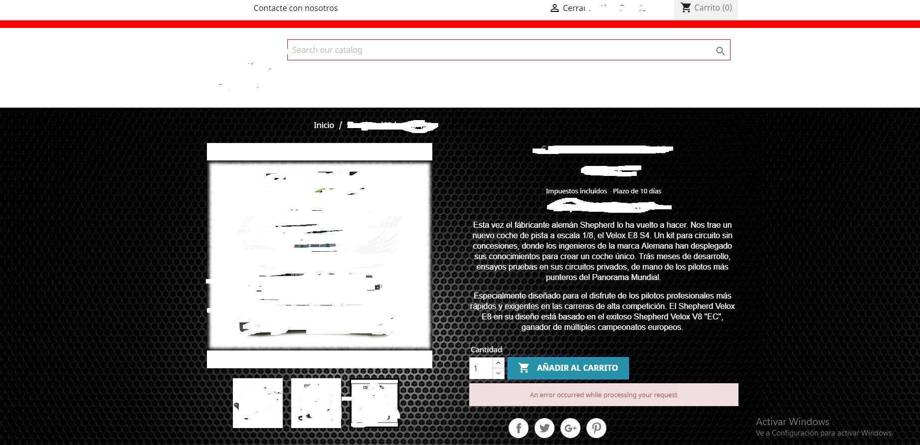

ican Posted August 31, 2018 Share Posted August 31, 2018 while I'm add to cart my product and then when i click continue shopping I'm getting error : An error occurred while processing your request Does anyone have idea how to solve it, Link to comment Share on other sites More sharing options...
Knowband Plugins Posted August 31, 2018 Share Posted August 31, 2018 Kindly check the server error log for details of the error. Link to comment Share on other sites More sharing options...
ican Posted August 31, 2018 Author Share Posted August 31, 2018 13 minutes ago, Knowband Plugins said: Kindly check the server error log for details of the error. Where to check it and how to fix it. Link to comment Share on other sites More sharing options...
Knowband Plugins Posted August 31, 2018 Share Posted August 31, 2018 Kindly check with your hosting regarding the server log file path OR there must be some option in control panel to check the error log (Location & option can be different depends upon the host) In case you are using the cloud OR dedicate server, then server error log file location will be /var/log/apaache2/error.log Copy the error from the error log & paste here to check the same. Do you know how to use the chrome developer toolbar (network panel) ? If yes, then no need to check the server log. You need to enable to debug mode in the PS & need to check the response of the add item request in the network panel. Link to comment Share on other sites More sharing options...
ican Posted August 31, 2018 Author Share Posted August 31, 2018 19 minutes ago, Knowband Plugins said: Kindly check with your hosting regarding the server log file path OR there must be some option in control panel to check the error log (Location & option can be different depends upon the host) In case you are using the cloud OR dedicate server, then server error log file location will be /var/log/apaache2/error.log Copy the error from the error log & paste here to check the same. Do you know how to use the chrome developer toolbar (network panel) ? If yes, then no need to check the server log. You need to enable to debug mode in the PS & need to check the response of the add item request in the network panel. No, I don't know how to use the chrome developer toolbar. I'm using nginx server. Link to comment Share on other sites More sharing options...
Knowband Plugins Posted August 31, 2018 Share Posted August 31, 2018 In the nginx, error log file location is either /var/log/nginx/error_log OR /var/log/nginx/error.log Link to comment Share on other sites More sharing options...
ican Posted August 31, 2018 Author Share Posted August 31, 2018 when i disable seo friendly url from back office then errors not occurs but when i enable it errors occurs again on ajax request sent either on quantity update Or any attribute update. It means friendly url not works for ajax call. All other urls works perfect with friendly url enable. Link to comment Share on other sites More sharing options...
