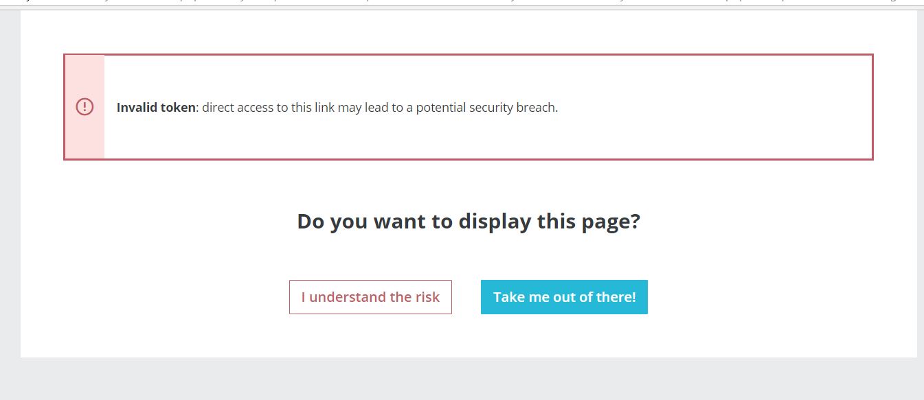

nek666 Posted March 18, 2018 Share Posted March 18, 2018 Our Prestashop site is showing this error (Invalid token: direct access to this link may lead to a potential security breach)" everytime we want to access several sections, such as create a product, view products, etc. This is the current version we are using Prestashop 1.7.3. This is a clean installation we installed a few days ago. Link to comment Share on other sites More sharing options...
Zitty Posted March 28, 2018 Share Posted March 28, 2018 I have the same issue with version 1.7.3.0 when I create or edit a product. Some ideas? Link to comment Share on other sites More sharing options...
prestag00d Posted April 8, 2018 Share Posted April 8, 2018 i have the same problem , is there is any fix for this .... Link to comment Share on other sites More sharing options...
prestag00d Posted April 9, 2018 Share Posted April 9, 2018 (edited) the solution is changing the php version to 7.0.1 on Multiphp Manger @ cpanel Edited August 12, 2023 by prestag00d (see edit history) Link to comment Share on other sites More sharing options...

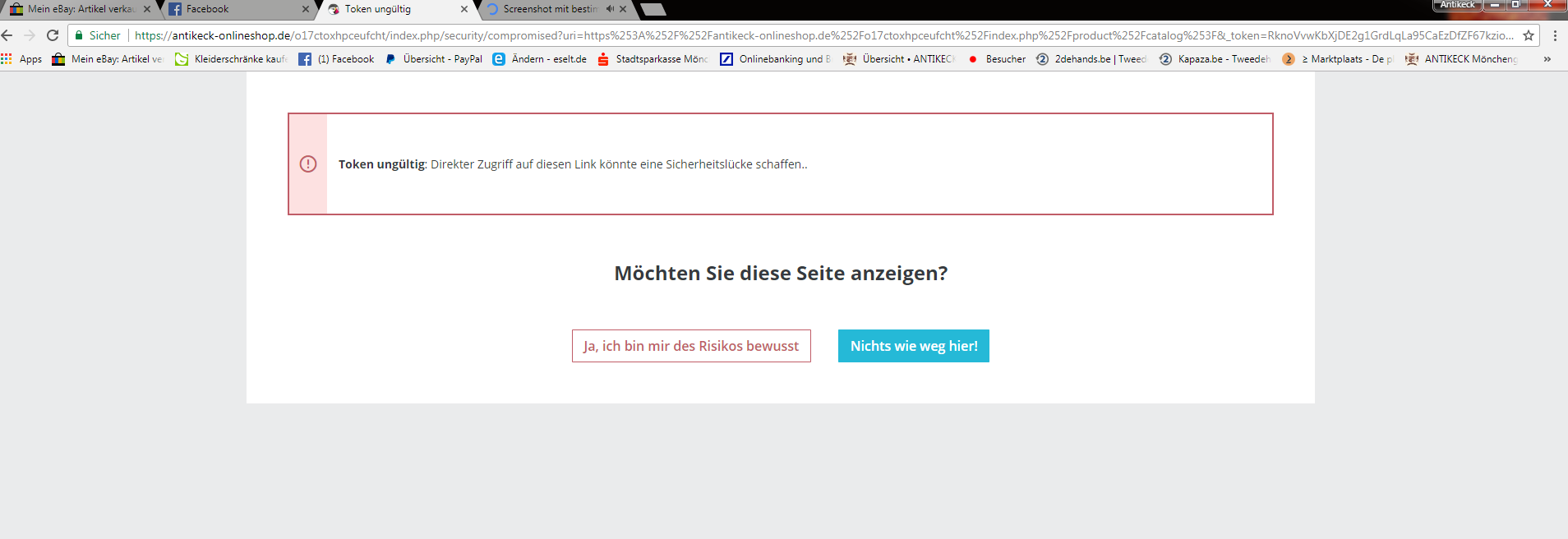

antikeck Posted April 19, 2018 Share Posted April 19, 2018 (edited) Nach dem ich 1.7.3 Update gemacht habe, ich hab das Problem auch, aber es ist nur ein Tag oder wenn man einen anderen PC oder einen anderen Tag muss mann nochmal ein geben Shop-Einstellungen-Kontakt-unter-Shops unter shop adress daten Öffnungzeitein angeben dann leuft nur ein tag. Hat jemand eine Idee, dass die ein Mal richtig eingestellt, richtig speichert Edited April 19, 2018 by antikeck (see edit history) Link to comment Share on other sites More sharing options...
