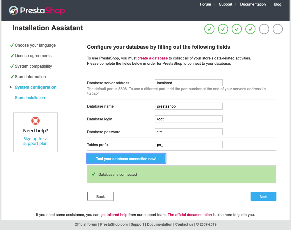

SamTTT Posted February 18, 2019 Share Posted February 18, 2019 Try using localhost as Database server address And root as Database password Works on Mac when I use MAMP. See images attached 1 1 Link to comment Share on other sites More sharing options...
