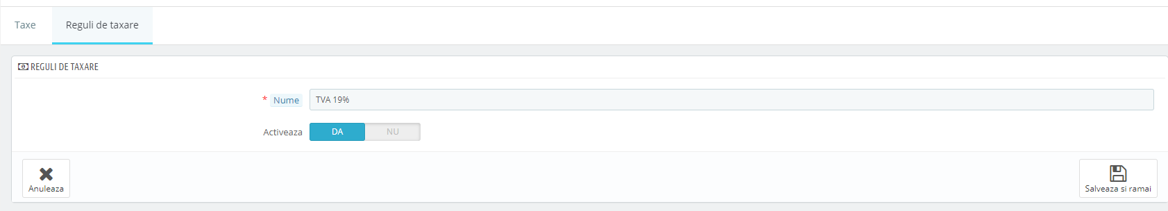

shamanu Posted February 25, 2020 Share Posted February 25, 2020 @Sorin M In the attached image you find the solution for Romania. Just enable the country, the browser language and disable "Default country by brwoser language" from Localization menu. It works like a charm. Nice day! 1 Link to comment Share on other sites More sharing options...
Sorin M Posted February 25, 2020 Share Posted February 25, 2020 6 minutes ago, shamanu said: @Sorin M In the attached image you find the solution for Romania. Just enable the country, the browser language and disable "Default country by brwoser language" from Localization menu. It works like a charm. Nice day! Thank you @shamanu We already tried but unfortunately this is not working for us. From what we have checked it can be also from TAX Rule and now we are investigating this idea. There are only 41 results. Link to comment Share on other sites More sharing options...
Sorin M Posted February 26, 2020 Share Posted February 26, 2020 For us that was the main problem. Our general Tax rule was applied only for 41 country's not ALL country's. For everyone else prices was showing without tax rule. It was very frustrating and we loose many hours searching in wrong places 1 Link to comment Share on other sites More sharing options...
Alex Nicoli Posted December 28, 2020 Share Posted December 28, 2020 On 2/25/2020 at 2:58 PM, shamanu said: @Sorin M In the attached image you find the solution for Romania. Just enable the country, the browser language and disable "Default country by brwoser language" from Localization menu. It works like a charm. Nice day! Just to share my experience and say THANK you for this suggestion. I have lost many hours investigating what could be a problem and it was this only button with unclear implications. This solved my problem. Thank you. Link to comment Share on other sites More sharing options...
