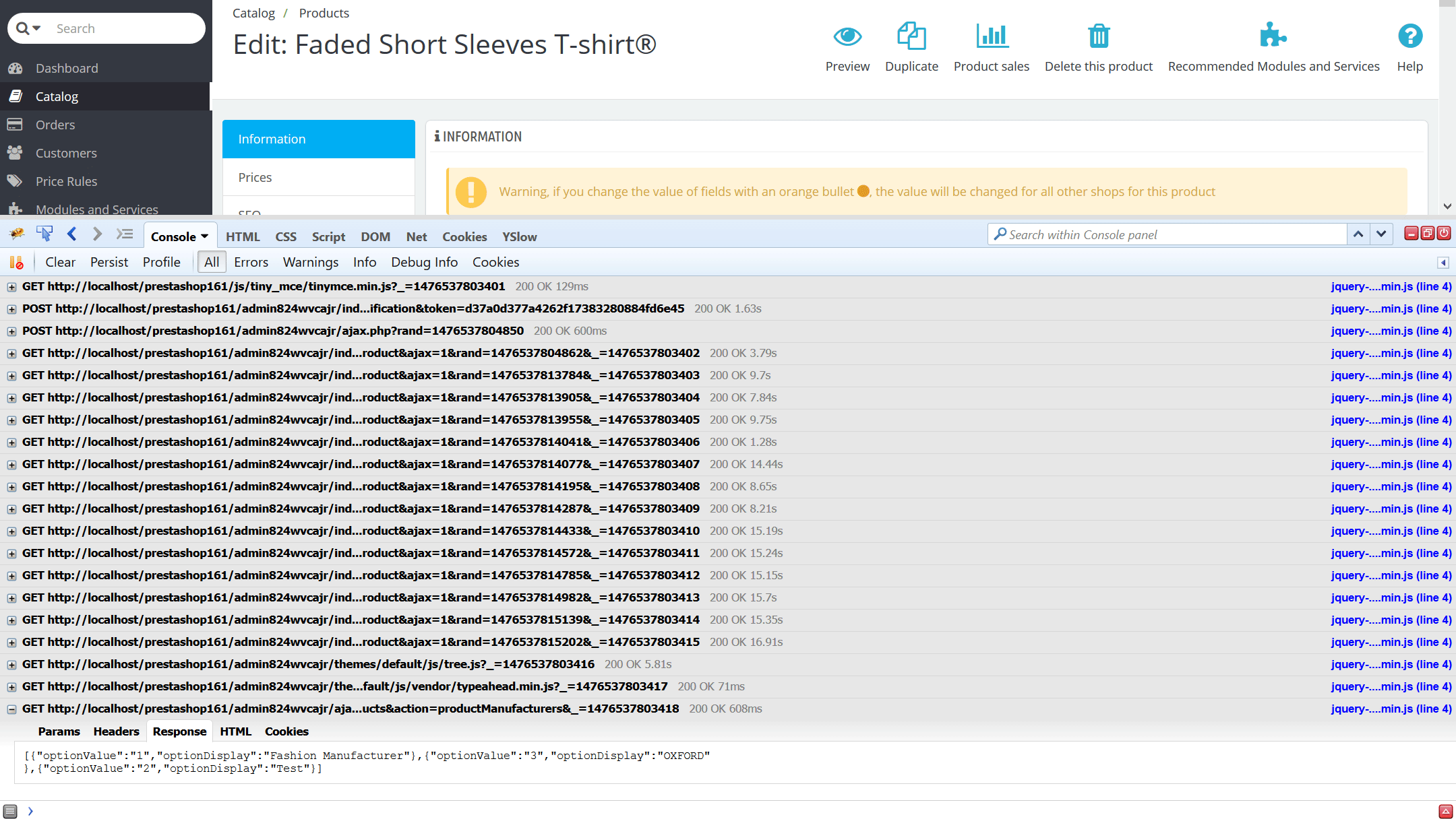

rocky Posted October 15, 2016 Share Posted October 15, 2016 You'll need to install Firefox with the Firebug extension if you haven't already and then press F12 to open Firebug. Then edit a product and you should see something like the following: As you can see, there are no errors on my PrestaShop v1.6.1.7 test site. In your case, there will be some AJAX calls that are red instead of black. Click the + icon on the left to view the error message in the Response tab. If you have enabled _PS_MODE_DEV_, there should be an error message there that can be used to debug. Link to comment Share on other sites More sharing options...
MarlboroMan Posted October 15, 2016 Author Share Posted October 15, 2016 I've added some extra text to one of my product description and clicked on save and stay. The page then refreshes without saving the new added text but all the lines in firebug are black. I've also tried adding to cart then receive a "Your shopping cart is empty." message but the firebug screen was blank. Link to comment Share on other sites More sharing options...
