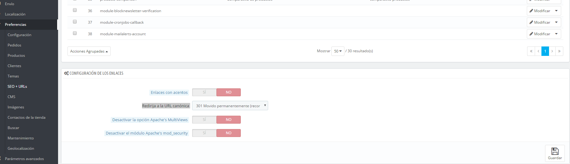

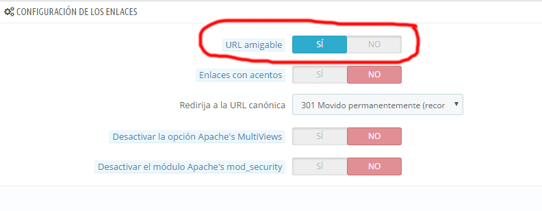

gorki75 Posted October 8, 2016 Share Posted October 8, 2016 Hello, my friendly URL disappeared option SETTING THE LINKS Do not know how to fix it Help Thanks Link to comment Share on other sites More sharing options...

gorki75 Posted October 8, 2016 Author Share Posted October 8, 2016 (edited) Odd, did you upgrade? PrestaShop version? If you upgrade to 1.6.17 yesterday, I thought it would be fine, but remains the same He has also disappeared "FORMAT OF LINKS", which is below Edited October 8, 2016 by gorki75 (see edit history) Link to comment Share on other sites More sharing options...

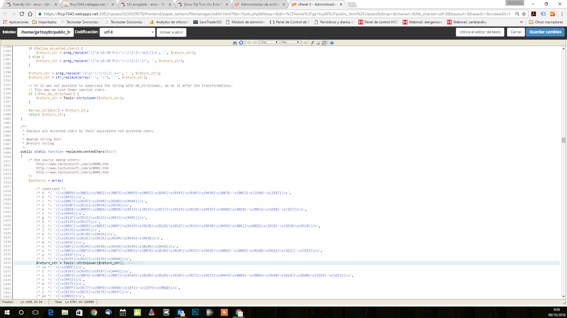

gorki75 Posted October 9, 2016 Author Share Posted October 9, 2016 I have an error...... Warning: Illegal offset type in isset or empty in /home/ge1tuy8t/public_html/classes/Tools.php on line 1397 Link to comment Share on other sites More sharing options...
