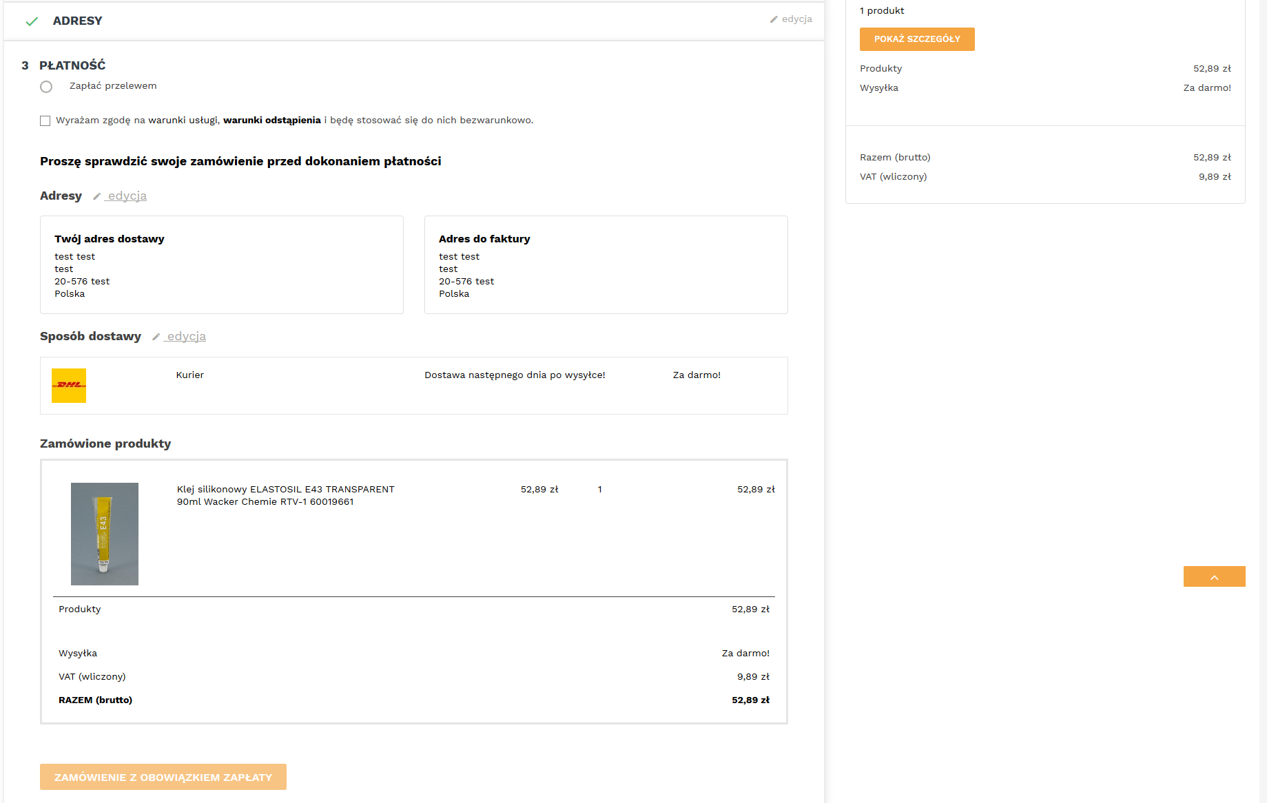

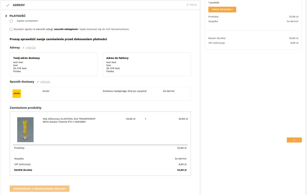

sitte Posted April 14, 2018 Share Posted April 14, 2018 (edited) I have identica situation. Disabling overrides does not help. I also removed all carriers and added them again. I tlooks like there is no carrier choosing step at all. I have prestashop 1.7.2.3, no opc modules, no /cache/class_index.php file. Any ideas? ============================ The reason for this behaviour was that tested product was virtual so there was no choice of carrier and default carrier cost was 0. Edited April 16, 2018 by sitte solution (see edit history) Link to comment Share on other sites More sharing options...
