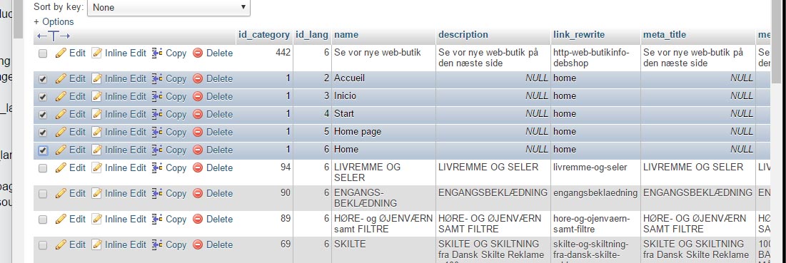

rocky Posted June 23, 2016 Share Posted June 23, 2016 Strange. I checked my PrestaShop v1.5.6.2 test site and the "Home" category has an ID of 2, so it should work. Can you check the ID of your "Home" (or "Menu") category in the ps_category_lang table? Link to comment Share on other sites More sharing options...
Zedster Posted June 23, 2016 Author Share Posted June 23, 2016 I reiterate I am not real savvy at these things but here is what I come to. Does this mean it is 1 instead of 2? My confusion level is growing. Thanks for the help Link to comment Share on other sites More sharing options...
rocky Posted June 23, 2016 Share Posted June 23, 2016 Yes, it appears your home category has an ID of 1 instead of 2 for some reason. Perhaps you used the CSV import and it replaced the root category with the home category. Anyway, the important thing is that my SQL queries should work if you change the ID to 1. Link to comment Share on other sites More sharing options...

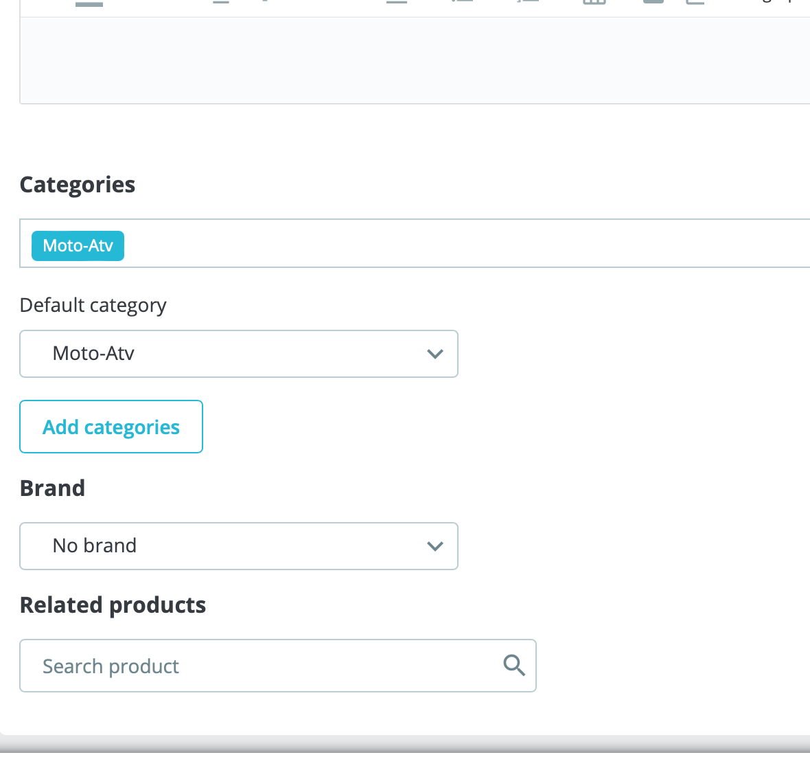

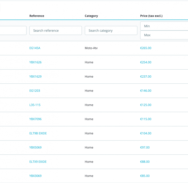

Marleon Posted January 22 Share Posted January 22 Thank you! This helped me, but unfortunately in the products section I still see HOME. But if you go into product properties, then everything is fine. Clearing cache on website and in browser does not change anything. P.S. I only did DELETE FROM `ps_category_product` WHERE `id_category` = 2; Prestashop 8.1.3 Link to comment Share on other sites More sharing options...
