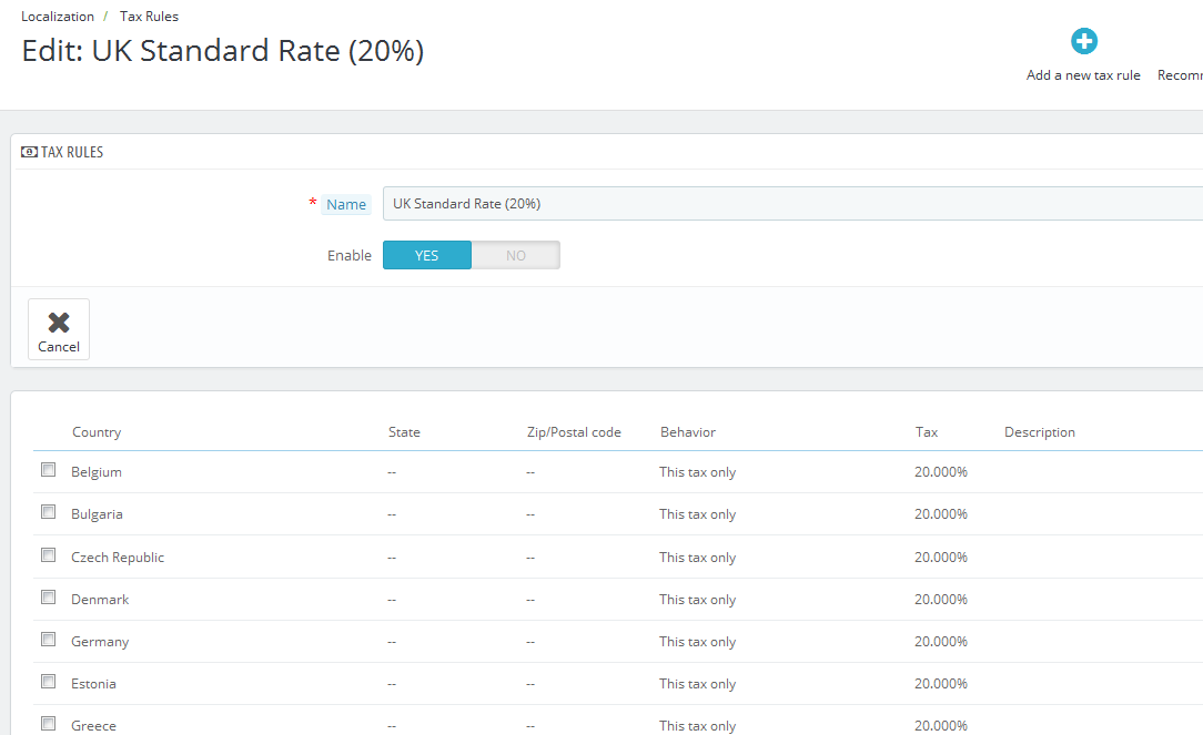

vendetta V Posted March 3, 2016 Author Share Posted March 3, 2016 (edited) You also need to set tax for all countries - in my example for all 28 EU countries. I already had the rules created for each country: Edited March 3, 2016 by vendetta V (see edit history) Link to comment Share on other sites More sharing options...
Timerider Posted May 4, 2016 Share Posted May 4, 2016 Hi folks, I am having the same problem. There seems to be is a conflict between tax rules and the per-product tax setting. When I set up the store I put 19% German tax on each product. If I remove tax from the product then even if I have a Tax Rule set up (19% for EU) no tax is charged. If I leave tax in the product then it is always charged, regardless of a Tax Rule saying "Tax free" for this country. This makes the tax rules rather redundant, doesn't it? So, we either need to ignore the per-product setting or have a priority setting 1) "tax rule", 2) "product". (if at all). I don't understand why tax is set on a per-product basis anyway as it surely always depends on the customer and seller's countries?? Link to comment Share on other sites More sharing options...
tuk66 Posted May 4, 2016 Share Posted May 4, 2016 Tax depend on products - some products can have lower tax rate (%), some higher. The country of residence, VAT registration and perhaps other rules are used to add tax or don't to the total price. Link to comment Share on other sites More sharing options...
Timerider Posted May 4, 2016 Share Posted May 4, 2016 tuk66, thanks for your quick reply, you are right of course, I forgot that since I only sell 19% products. I think I have solved it now!! In my multistore context I had removed non-EU countries from the tax rule "EU" while in context "Shop1" but failed to do this in context "All shops". Then I created another Tax Rule with "Non-EU" (global context) and listed non-EU countries and it works!! (Pity one can't add whole Zones). Link to comment Share on other sites More sharing options...
