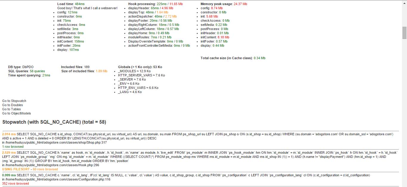

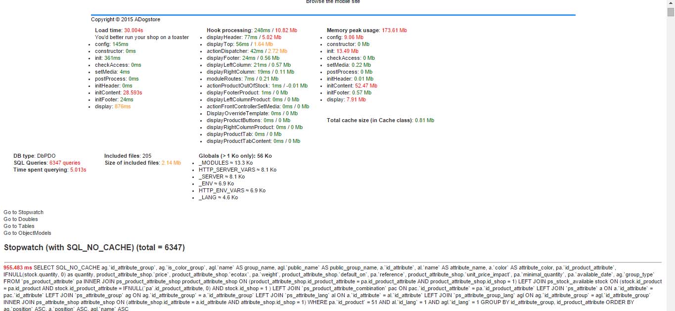

huduyudesign Posted July 17, 2015 Author Share Posted July 17, 2015 Thank you, I turned on profiling & attached are screen shots. Doesn't help me much to be honest. Cal Page Trib jpeg is primarily the slower loading page of them all. I've gotten reports of 104 errors but wasn't told which page exact. I'm leaving profiling on for now if anyone wants to take look. Link to comment Share on other sites More sharing options...

huduyudesign Posted July 18, 2015 Author Share Posted July 18, 2015 Just did all those, still grinding away. I did read somewhere that SQL Queries over a 1000 indicate something wrong, I have SQL Queries: 6385 queries Link to comment Share on other sites More sharing options...
