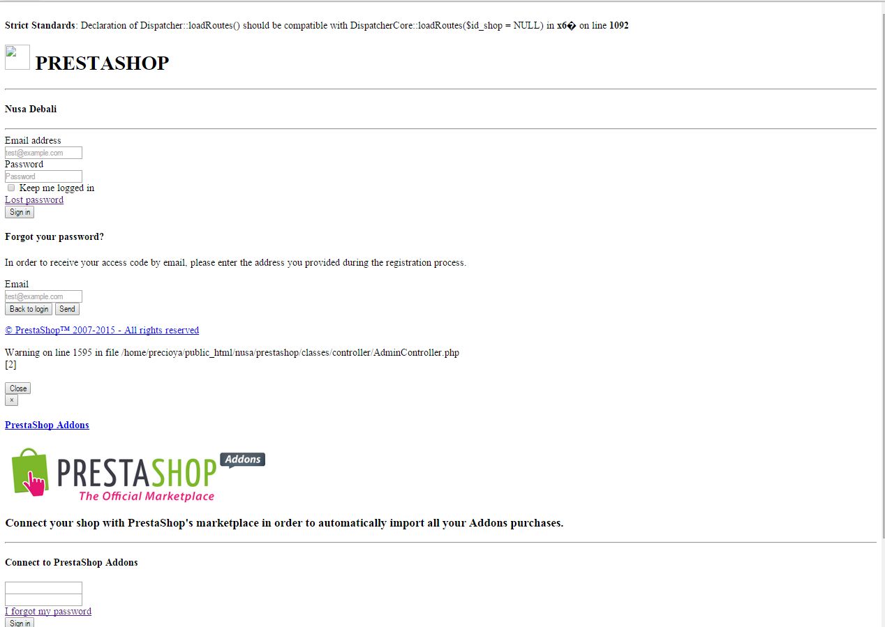

BenNusa Posted June 24, 2015 Share Posted June 24, 2015 Hi everyone, I had a problem recently. After transfering my prestashop from BO to Localhost I cannont connect anymore to the Back office admin. Error message : Strict Standards: Declaration of Dispatcher::loadRoutes() should be compatible with DispatcherCore::loadRoutes($id_shop = NULL) in x6 on line 1092 Someone as an idea ? Link to comment Share on other sites More sharing options...

BenNusa Posted June 25, 2015 Author Share Posted June 25, 2015 (edited) Hello, thank for your response, I disable the debug mode and the login page is still not completly loaded, the error is still there.As you said for .htaccess : Do I need to delete it from the folder via Filezila in prestashop/override/.htaccess ? This problem is really strange because I started establishing my online shop on the online version by adding manually products, after I went to loaclhost and now the website where I used to login is down. (See link below) http://www.prestashop.com/forums/uploads/monthly_06_2015/post-1009167-0-15090400-1435116111.jpg Edited June 25, 2015 by Ben17100 (see edit history) Link to comment Share on other sites More sharing options...
