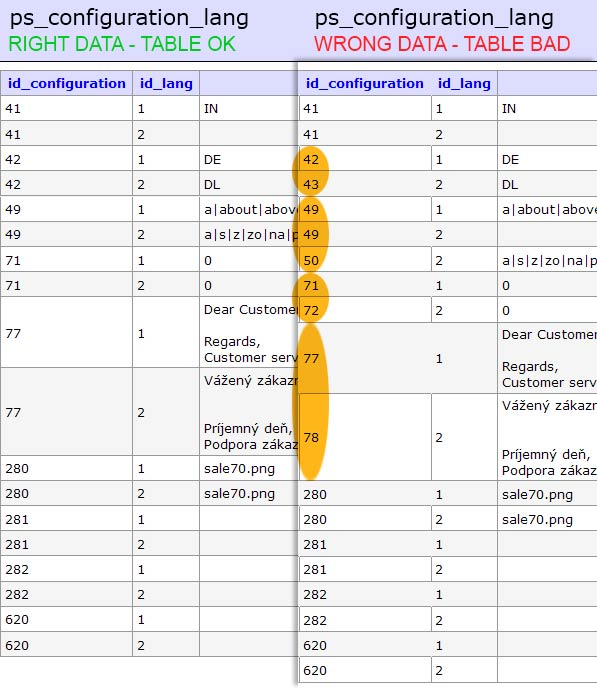

.. after looong investigation and testing:
in my case is problem in database table 'ps_configuration_lang' where localization from sql file with wrong 'id_configuration' values for second language was imported.
So it was not about version or bug in files. It was 'typo infection' if sql is used for localization of many sities   :)
So for my case is this problem solved.
But maybe not for all other written above...
For compare wrong and repaired good data table check this image:
