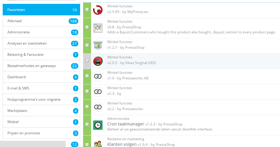

stijnmenkehorst Posted January 11, 2015 Share Posted January 11, 2015 Please help me out: After upgrading most of my modules dont have titles anymore. Furthermore they dont have any text when I "configure" a module. What to do? Link to comment Share on other sites More sharing options...

stijnmenkehorst Posted January 12, 2015 Author Share Posted January 12, 2015 hmm... investigated it a little more and I noticed something. The modules names are only missing in 2 module categories: Social Networks Shopping Functions (and then only the added modules, not the ones that came with the package) 1 Link to comment Share on other sites More sharing options...
PrestaHeroes.com Posted January 12, 2015 Share Posted January 12, 2015 hmm... investigated it a little more and I noticed something. The modules names are only missing in 2 module categories: Social Networks Shopping Functions (and then only the added modules, not the ones that came with the package) well that's something. how do those same modules look when you click 'all' modules? Link to comment Share on other sites More sharing options...
stijnmenkehorst Posted January 13, 2015 Author Share Posted January 13, 2015 well that's something. how do those same modules look when you click 'all' modules? Still the same El Patron It is a matter of the category the module belongs to, not a matter of which category is displayed. Link to comment Share on other sites More sharing options...
