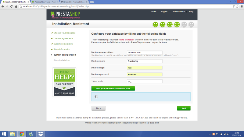

OEMPerformance Posted December 23, 2014 Share Posted December 23, 2014 (edited) Hi all, I'm new to Prestashop. It looks great and I'm hoping to use it to create a new store but I wanted to play with it on my machine using XAMPP first before going to the expensive of hosting etc. I have XAMPP installed and configured with Apache listening on port 8080. I have altered the root user password as suggested in XAMPP. I can access phpmyadmin at locahost:8080/phpmyadmin using this new password, where I have setup a database called Prestashop. I have created a folder called OEMperformance in xampp/htdocs where I copied the Prestashop install folder and where I am trying to install Prestashop. When I try to install I have a problem at the database configuration page. The database login and password entered are what I use to connect successfully to phpmyadmin. After entering the following details the page hangs up and the timer just keeps going round. I have tried hitting next and skipping the test but the installer hangs up doing that too. I've not seen any info in the documentation about the Tables prefix - what is that? I tried downloading the installer again but no different. Can anyone give me any pointers? Edited December 30, 2014 by OEMPerformance (see edit history) Link to comment Share on other sites More sharing options...
PrestaHeroes.com Posted December 23, 2014 Share Posted December 23, 2014 for db server, just use localhost and not include the port you can also use 127.0.0.1 (this is for better performance) Link to comment Share on other sites More sharing options...
OEMPerformance Posted December 24, 2014 Author Share Posted December 24, 2014 Hi, thanks very much for your reply. I tried your suggestions and it does exactly the some thing using localhost and 127.0.0.1 I tried clearing the cache and also a different browser with no luck. Pretty frustrating! Link to comment Share on other sites More sharing options...

OEMPerformance Posted December 29, 2014 Author Share Posted December 29, 2014 Thanks for the ongoing assistance. I managed to get through the database test after reverting to port 80 and using 127.0.0.1 as suggested above. I then had the install fail multiple times due to a SQL error - some table address does not exist. I am not technie enough to waste any more time trying to debug this so I have sacked of XAMPP and now downloading EasyPHP fingers crossed that goes smoothly with Prestashop already installed. wish me luck 1 Link to comment Share on other sites More sharing options...
OEMPerformance Posted December 29, 2014 Author Share Posted December 29, 2014 Success! EasyPHP was...well... Easy! Thanks for the advice. Going to have a play with it now.... Link to comment Share on other sites More sharing options...
