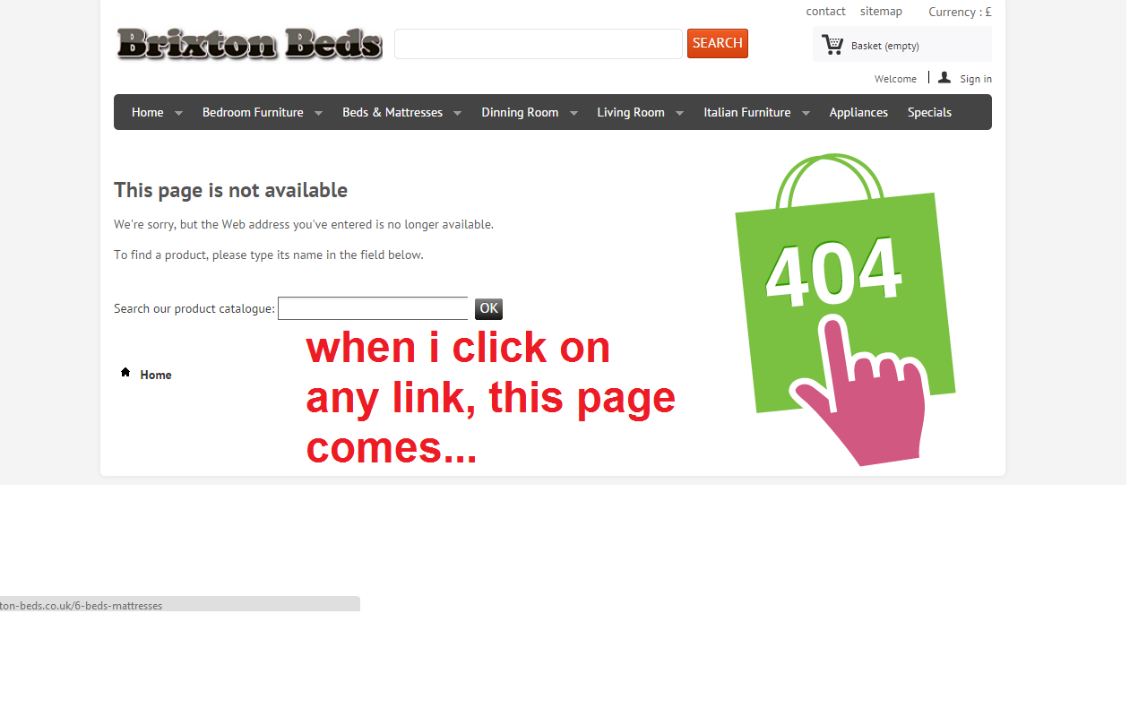

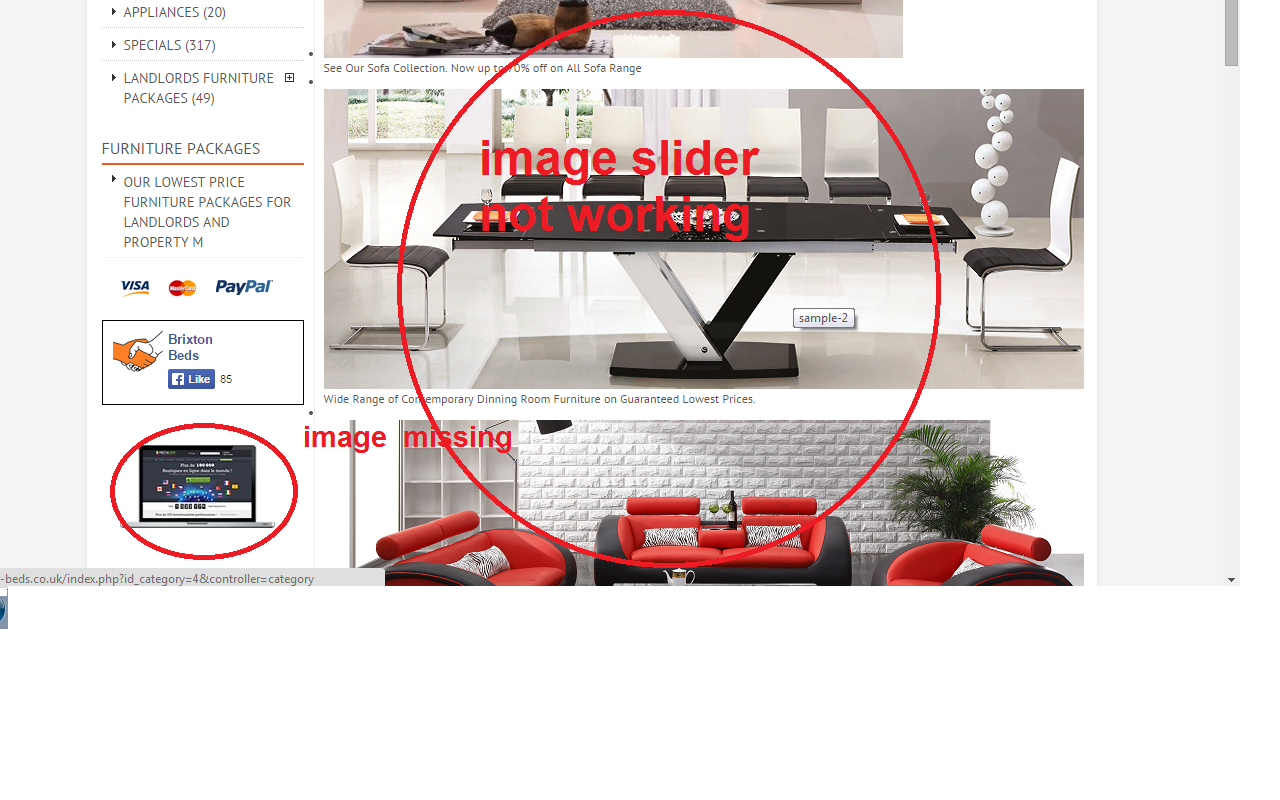

adamthomson123 Posted December 12, 2014 Share Posted December 12, 2014 hi! i have updated my website www.brixton-beds.co.uk from version 1.6.0 to 1.6.9 and after the update, my website is dead, images are not showing, links are not working, image slider is not working, please have a look on my website and guide me to solve this issue, urgent help needed, please i have attached the screenshots of the first page and the links inside not working, images are missing too. please anybody help me. thanks Link to comment Share on other sites More sharing options...

frank_jarle Posted December 13, 2014 Share Posted December 13, 2014 Can you try turning friendly urls off and turning them back on and see if that helps. I think you are on wrong track here Mr :-) turning on/off Friendly URL in IE (if thats what you are assuiming here?) would not help. If you are thinking about the feature in PS then yes you are probably right :-) This is a prestashop issue, seems to me its related to the path where the actually files is stored. The 404 error you get is because PS is pointing to a location that either does not exist or does not contain the data its looking for. I am not nearby my PS at the moment, but if i do not recall wrongly it should be possible for PS to re-generate the indexes, and the URLs. Link to comment Share on other sites More sharing options...

PrestaHeroes.com Posted December 13, 2014 Share Posted December 13, 2014 I think you are on wrong track here Mr :-) turning on/off Friendly URL in IE (if thats what you are assuiming here?) would not help. If you are thinking about the feature in PS then yes you are probably right :-) This is a prestashop issue, seems to me its related to the path where the actually files is stored. The 404 error you get is because PS is pointing to a location that either does not exist or does not contain the data its looking for. I am not nearby my PS at the moment, but if i do not recall wrongly it should be possible for PS to re-generate the indexes, and the URLs. follow dh42's advice. re-generate the ,htaccess file. then clear all browser cache and back office-->performance-->clear cache top right. then we can see where you are at with this.. Please note: you did not follow upgrade path correctly, you create upgrade separate from production, then if good your move upgraded shop to production. Hopefully you have a full back up of the files and db, if not then moving forward is only option, and put out the fires along the way. Link to comment Share on other sites More sharing options...

loulou66 Posted December 13, 2014 Share Posted December 13, 2014 Hi 1°) delete the .htacces in the root of shop 2°) you have 2 folder admin 1 =>admin123 2=>admin0419 the 1st is old admin i think delete it and change or rename the 2nd 3°) delete or rename the folder install 4°) go in your Back office wiht the name of admin renamed in 2°) 5°) go in SEO&URL re-geenerate the .htaccess 6°) go in setting=>image re-genarate all images @++ Loulou66 1 Link to comment Share on other sites More sharing options...
