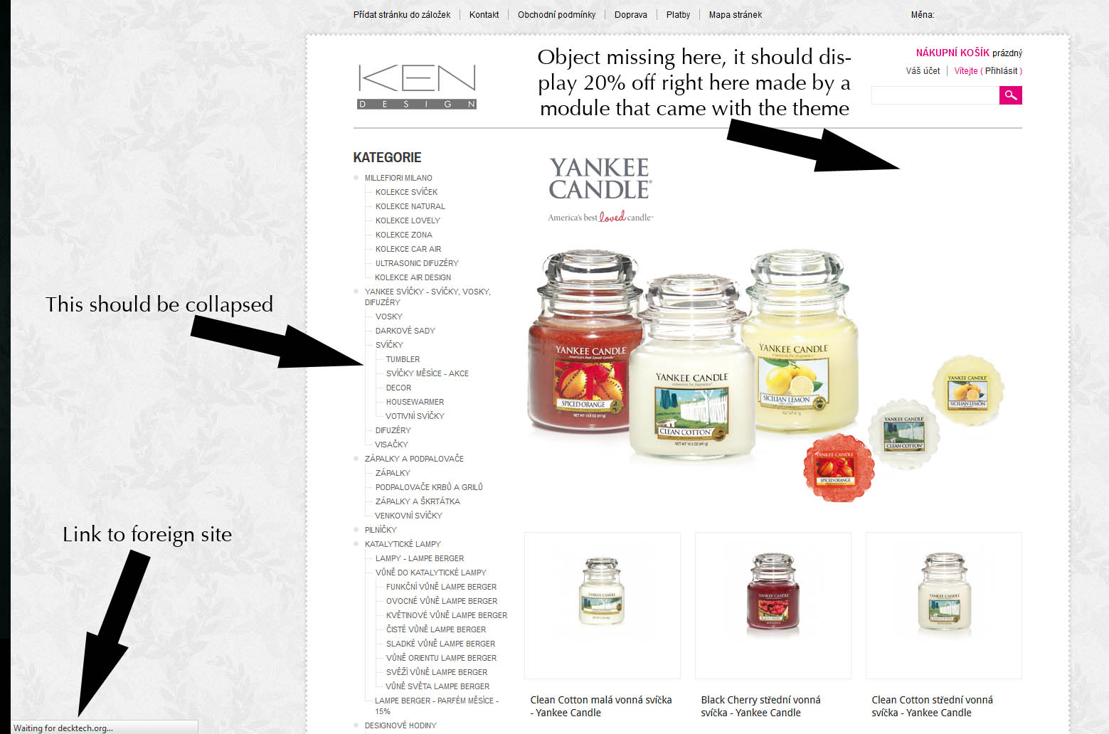

Madman_CZ Posted August 8, 2014 Author Share Posted August 8, 2014 (edited) Hi, thanks for your reply. See attachment, there are elements missing in my shop that where there before the link started to appear. Also, in the back office there are things that no longer funtion correctly, for eg. the filter under products. Something is effecting the code somewhere as there are things in my store that no longer work properly. Thanks for the GREP tip, I will try that today. I hope to find it. The link displays in your browser when you browse my store, it keeps saying waiting for decktech.org before it loads any page. Regards Pete Edited August 8, 2014 by Madman_CZ (see edit history) Link to comment Share on other sites More sharing options...
