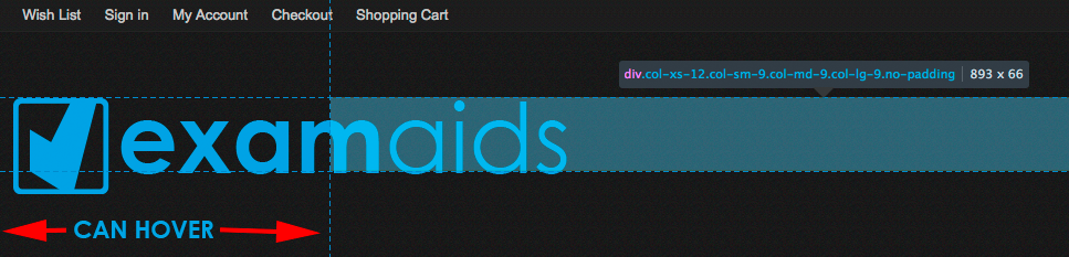

How do I change the size of the hover for jumping to the store home page by clicking on the logo? It still seems to be fixed at 287px, or thereabouts. IOW, I can click on the leading part of the logo, but not the tail (see attached).
URL: http://www.examaids.com/examaids/
Hi Walrus,
If you use the Web Developer plug-in for Chrome you'll have an easier time. Using it I found out that the "hoverable" part of your logo is a div with an ID of "header_logo". If you can find (or create) a rule for this ID in your CSS stylesheet you should be able to change the size.
Hi Walrus,
