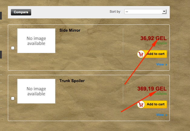

sickshot Posted March 28, 2014 Share Posted March 28, 2014 (edited) hello, so my problem is that my currency doesn't have symbol and I'm using just its name so when the language is switched form native to English currency stays untranslated. so is there any way to translate currency symbol? or any other way maybe... Edited April 3, 2014 by sickshot (see edit history) Link to comment Share on other sites More sharing options...

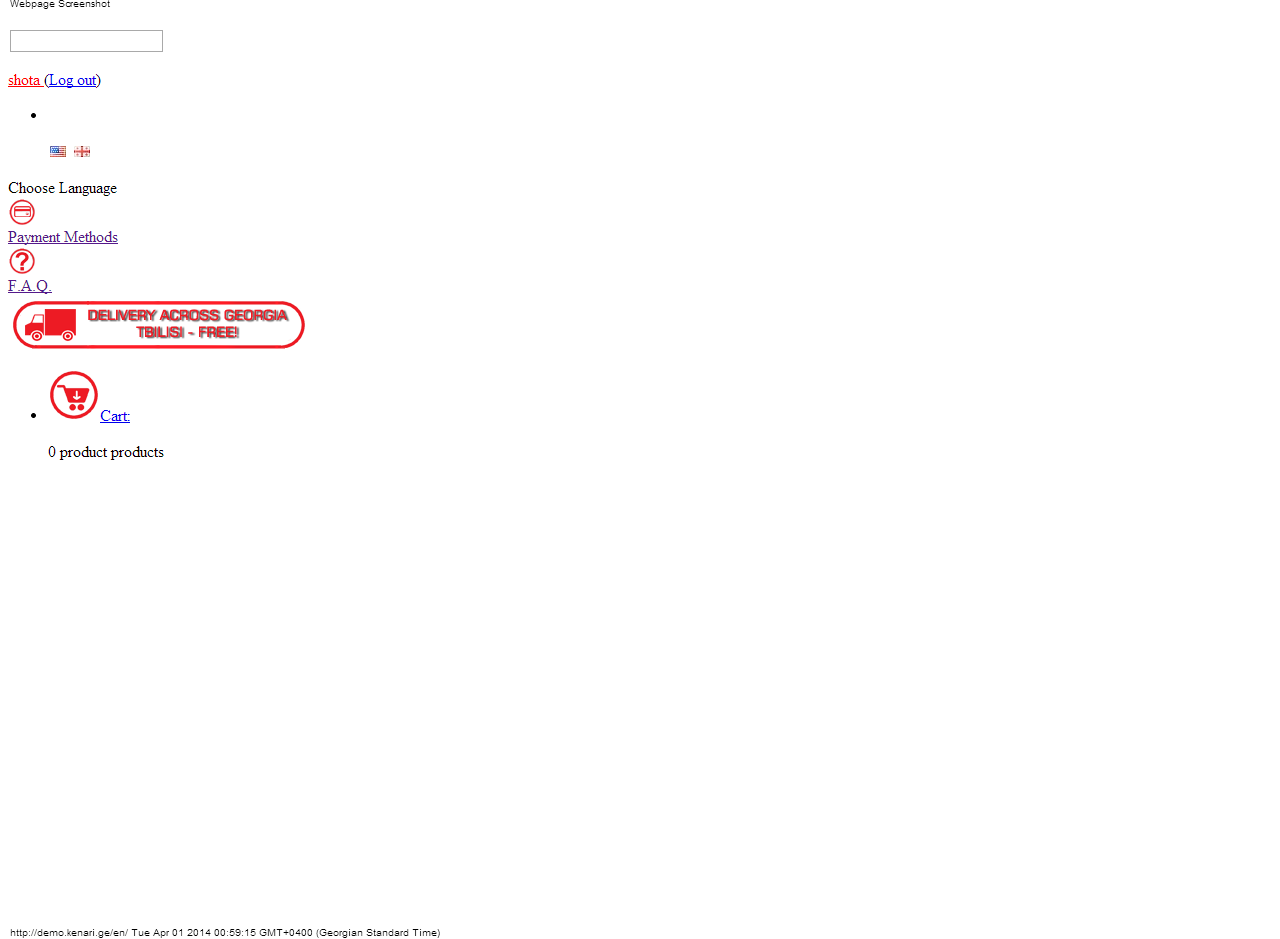

PascalVG Posted March 31, 2014 Share Posted March 31, 2014 Hi sickshot, No solution yet, but maybe an idea that gets you started. I have a javascript that checks the body for instances of the currency (I believe you use GEL and ლარი, right? If you add the following code to themes/<your theme folder>/header.tpl (just above the line {$HOOK_HEADER} INside the <head>...</head> tag )) {assign var="hdr_language" value=Context::getContext()->language->id}<script> $(document).ready(function() { if ({$hdr_language} == XXXX) { var replaced=document.body.innerHTML.replace(/GEL/g,'ლარი'); document.body.innerHTML=replaced; } });</script> (and Replace XXXX witht the language ID of your Georgian language in PrestaShop) In Localization->Currencies, use GEL as Unit of Currency. What it does is, when the Language changes to Georgian, it will replace the GEL with ლარი. This sounds great, but I bumped into a few problems: - After replacing the body text with the new 'replaced' (in the line: document.body.innerHTML=replaced;), not all javascripts seem to work anymore, like the shoppingcart won't fold open, the top menu- drop down menu's won't open etc. - When adding some product to the cart, I expect that the added product still has the GEL as currency unit, as it won't be 'translated' on the fly, only one time, when loading the page the first time. So, this won't fully work, but it may give you some idea how wo do the translation. Maybe someone else has a great idea where to put this code to make it work everywhere and correctly with the diverse scripts... My 2 cents, pascal. 1 Link to comment Share on other sites More sharing options...

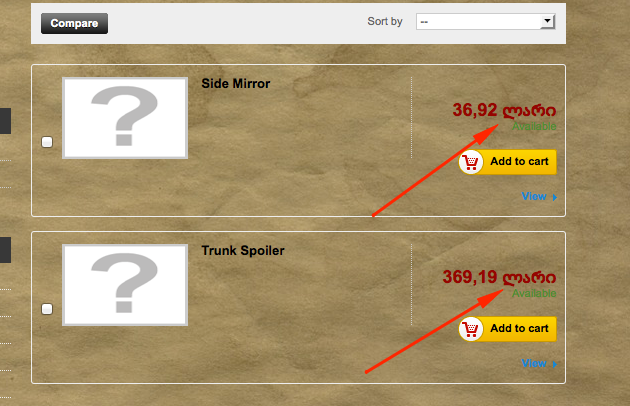

sickshot Posted March 31, 2014 Author Share Posted March 31, 2014 hello and thank you for your replays! Pascal you're right thats exactly my case I'll check and see whats happens then I'll get back with the results.. El Patron No. sound silly but we dont have a symbol we use only GEL when needed in English as USD is used... 1 Link to comment Share on other sites More sharing options...

sickshot Posted March 31, 2014 Author Share Posted March 31, 2014 (edited) thank you Pascal, I did it, but site messed up . my code looks little different as I can see, maybe theres something to do with the PS version? i'm running 1.4.7 I'm unable to post my code in post so I attach it.. Tools.php Edited March 31, 2014 by sickshot (see edit history) Link to comment Share on other sites More sharing options...

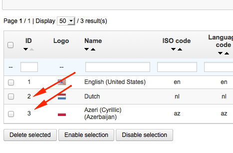

PascalVG Posted March 31, 2014 Share Posted March 31, 2014 Hi sickshot, Don't add the name of the language, but it's ID number: So for example, if your language ka has an ID of 2: Don't add: if ((int)Context::getContext()->language->id == ka) $c_char ='ლარი'; but if ((int)Context::getContext()->language->id == 2) $c_char ='ლარი'; That should do the trick. pascal Link to comment Share on other sites More sharing options...
