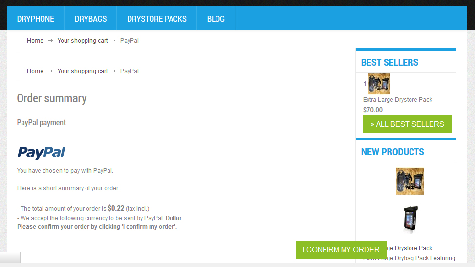

cantcloseaccount Posted October 9, 2013 Share Posted October 9, 2013 I helped janoloco with this offline. shop 1.5.5.0 1.2.5 had several different internal issues. loaded old 3.5.5 and payment path worked fine. Anyone having 'one page checkout' redirect loops, error returning from paypal (blank screen), no payment taken etc, uninstalling and re-installing still showing express checkout...etc... try the attached 3.5.5 v3.5.5-PayPal.zip Tried rolling back paypal as I have the issue mentioned with redirect loop (apologies for posting multiple threads) Have 3.5.5 up and running now, but after payment is made in paypal, the customer is redirected to a confirmation page (attached), and then when they click confirm, it sends them to: /modules/paypal/express_checkout/payment.php with a blank screen. Payment goes through, but order doesn't show up in backend. Link to comment Share on other sites More sharing options...
benjamin utterback Posted October 9, 2013 Share Posted October 9, 2013 Tried rolling back paypal as I have the issue mentioned with redirect loop (apologies for posting multiple threads) Have 3.5.5 up and running now, but after payment is made in paypal, the customer is redirected to a confirmation page (attached), and then when they click confirm, it sends them to: /modules/paypal/express_checkout/payment.php with a blank screen. Payment goes through, but order doesn't show up in backend. Hi, I'm wondering if you were able to test v1.2.6 . If you are using 1.5x then this would be the module you should use. Link to comment Share on other sites More sharing options...
