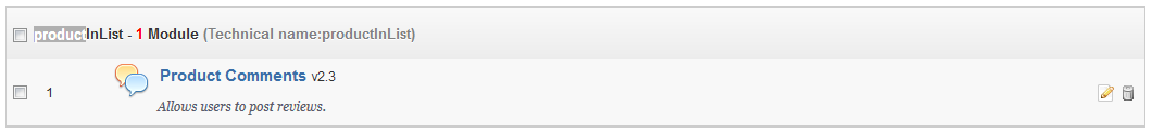

NemoPS Posted September 4, 2013 Share Posted September 4, 2013 Oh, you're following my tut Can you check if the module is listed in modules->positions under that hook? You might need to check 'display non positionable hooks' Link to comment Share on other sites More sharing options...
rgwhitaker Posted September 4, 2013 Author Share Posted September 4, 2013 Nemo: Yes. The productInList appears in the Modules > Positions list! It's the last one. But, for some reason, the stars do not appear. Vekia: I don't know how to do a {debug}. Do I need to do debug now that I've determined that the "productInList" hook appears in the Modules > Positions list? Link to comment Share on other sites More sharing options...
