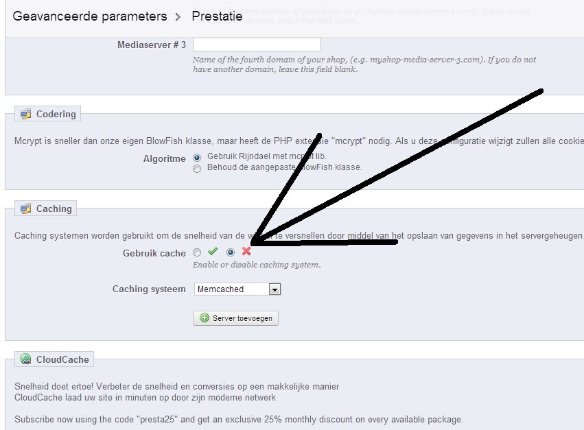

musicmaster Posted September 6, 2013 Share Posted September 6, 2013 Nortom, Soesoe, As you have a caching error, can you try to switch the external caching (memcache, etc) off? This is under Advanced Parameters -> Performance. See picture. Link to comment Share on other sites More sharing options...
Soesoe Posted September 6, 2013 Author Share Posted September 6, 2013 Dear Musicmaster, Your tip helped alot for the frontoffice It was on indeed, so I switched it off and when I click a category on my site it takes around 2 seconds instead of 5 seconds, nice improvement On backoffice I didn't notice anything Thanks for your help, hope it helps the others too Link to comment Share on other sites More sharing options...
nortom Posted September 6, 2013 Share Posted September 6, 2013 Yes this improve the back office, but the front site is slower So it's a caching problem? Link to comment Share on other sites More sharing options...
