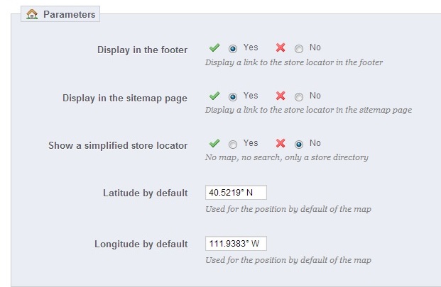

NOSaint Posted July 23, 2013 Share Posted July 23, 2013 (edited) Hello All! I upgraded to PS 1.5.4 and I've noticed the Store Locator page of our site is incorrect. Regardless of which version I use in the BO...the page in the FO is incorrect. For example, if I use the option for the Google map to appear, it shows my Store in China :/ If I use the option for the store photo to appear instead of the map, no photo appears at all...just image question mark. Any ideas or fixes as to why this is happening? I'd be happy with a resolution to either problem. http://www.knittwitt...ntroller=stores Edited July 24, 2013 by NOSaint (see edit history) Link to comment Share on other sites More sharing options...

vekia Posted July 23, 2013 Share Posted July 23, 2013 can you show me your lat & lon from your BO ? i'm a kind of specialist in this case coz my master thesis was related to the google maps Link to comment Share on other sites More sharing options...
NOSaint Posted July 23, 2013 Author Share Posted July 23, 2013 Gladly! I've saved with the degree...without the degree symbol...with directions, without directions...not sure what's wrong :/ Link to comment Share on other sites More sharing options...
vekia Posted July 23, 2013 Share Posted July 23, 2013 use this: lat: 40.5219 lon: -111.9383 without degree symbol and directions Link to comment Share on other sites More sharing options...
vekia Posted July 23, 2013 Share Posted July 23, 2013 and use it both for map lat lon and store lat lon Link to comment Share on other sites More sharing options...

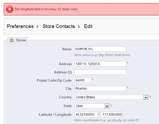

NOSaint Posted July 23, 2013 Author Share Posted July 23, 2013 Now I'm getting an error message. I was able to change it on the map page...but the attached is what I get when I try to change it on the store page. And it defaults to adding all the zeros at the end. Link to comment Share on other sites More sharing options...
vekia Posted July 23, 2013 Share Posted July 23, 2013 hello, maybe the same as with favicon, try to change values manually in the database? check table ps_store Link to comment Share on other sites More sharing options...
NOSaint Posted July 23, 2013 Author Share Posted July 23, 2013 Weird, it's showing up correctly in the database. Do you think the country code is correct? Link to comment Share on other sites More sharing options...
vekia Posted July 23, 2013 Share Posted July 23, 2013 hey, it's not showing up correctly, you have to use -111.9383 not 111.9383 - coz it is in china 1 Link to comment Share on other sites More sharing options...
NOSaint Posted July 24, 2013 Author Share Posted July 24, 2013 Touchdown! You're the man Vekia! I had to change it in the ps_table because it wouldn't allow me to change it in the BO. But once I did all problems solved :-) Link to comment Share on other sites More sharing options...
