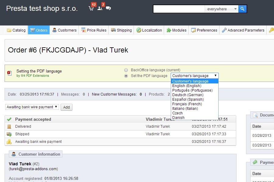

tuk66 Posted June 13, 2013 Share Posted June 13, 2013 You can print invoices in customer's language as well as all languages installed in the shop with the M4 PDF Extensions module. Link to comment Share on other sites More sharing options...

tuk66 Posted February 24, 2015 Share Posted February 24, 2015 Invoices are printed in administrator's language in Back Office and customer's language in her account. As I know there is no chance to choose a different language for invoices. I can imagine to print invoices in Back Office in: - customer's language - selected language For bulk printing the first option can result in mixed languages, so every page can be in a different language. Everything mentioned above does the M4 PDF Extensions module. See http://www.presta-addons.com/154-large_default/pdf-extensions.jpg. Link to comment Share on other sites More sharing options...

tuk66 Posted October 21, 2020 Share Posted October 21, 2020 As I wrote, I suggest to use the M4 PDF Extensions module - https://www.presta-addons.com/en/prestashop-modules/3-pdf-extensions-prestashop.html I have already done several different kind of invoices and you are not limited in languages showed on the invoice. You can even have product names in any language or more languages at once. So in your case, the whole invoice can be in French regardless the customer's language. Of course, Japanese version isn't contain "little squares" as Chinese-Japanese-Korean fonts are available. Link to comment Share on other sites More sharing options...
