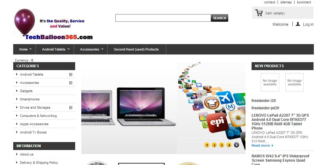

SteliosAl Posted January 31, 2013 Share Posted January 31, 2013 (edited) Hi Guys I had the common issue where the block was displaying the Euro currency even if i tried to select the other currencies enabled! I have uninstalled the module and reinstalled and didnt work..i have then reset the module and the currency now appears erroneously just over my categories section completely misplaced on the left column of the website as seen in the attached file! Please Help! Thanks Edited February 4, 2013 by SteliosAl (see edit history) Link to comment Share on other sites More sharing options...

SteliosAl Posted February 1, 2013 Author Share Posted February 1, 2013 Seems like noone knows how to fix this issue? I have uninstalled installed the module, reset the module and still displays erroneously as the attached image shows Link to comment Share on other sites More sharing options...

SteliosAl Posted February 1, 2013 Author Share Posted February 1, 2013 Hi SteliosAl, What is the default shop currency? It is in euros.. i had the issue where the currency wouldnt change when clicked on it.. then uninstalled and reinstalled currency block, then reset the currency block and now the block appears erroneously as shown in the attached thumbnail in the post.. when hovering over it the drop down menu with the rest of the currencies appears on the right column where 'new products is'!!! please have a look i enabled the site! Thanks Link to comment Share on other sites More sharing options...

SteliosAl Posted February 1, 2013 Author Share Posted February 1, 2013 did you try changing position? header of pages? in a default 1530 install it's in position 13 but I know that on one test shop I have the same problem...and sort of gave up on it because, well it was a test shop I don't get the option to move it in liveedit.. which file should i attempt to edit to move its position? thanks,. you can see it if you visit www.techballoon365.com hover over currency and the drop down appears on the right column! Link to comment Share on other sites More sharing options...
PrestaHeroes USA Posted February 1, 2013 Share Posted February 1, 2013 ...back office--Modules-->Positions don't use live edit..for this anyway http://screencast.com/t/N2S7DxW44AKz 1 Link to comment Share on other sites More sharing options...
SteliosAl Posted February 4, 2013 Author Share Posted February 4, 2013 ...back office--Modules-->Positions don't use live edit..for this anyway http://screencast.com/t/N2S7DxW44AKz So Simple yet so annoying! fixed it! how do i mark the thread as SOLVED? thanks a lot! i didnt know that if you remove and readd a module it gets dispositioned! Link to comment Share on other sites More sharing options...
