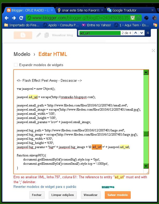

PU1JFC Posted April 22, 2012 Share Posted April 22, 2012 . . Greetings! Flash - Effect Peel Away In Blog, Blogger, Blogspot . . . What to do? Please look image below: Thanks. PU1JFC [email protected] http://cruzradio.blogspot.com . . Link to comment Share on other sites More sharing options...
