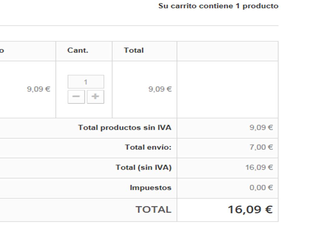

parry27j Posted January 4, 2015 Share Posted January 4, 2015 (edited) Hi!I am using PrestaShop 1.6.0.9.I have added a tax rule for our local Spanish Sales tax rate at 21%. All of my products have this listed as the tax rule to follow. In our area I am required to charge this flat tax rate to all purchases regardless of the shipping destination. when I enter the prices for the products the tax rule is not showing directly I have to click 2-3 times on save and stay button then it shows in the back office and then it comes and I have to select it every time and the separate line of tax is showing in the shopping cart but tax is always showing 0. I have changed all the things but unable to show the tax in the shopping cart. I am also required to show the amount of tax on a separate line in the checkout process.Currently I have the settings as follows.Product set up: Tax Rule is set to my special tax rule added as an additional option in the state taxes.Tax Options:Enable Tax: YesDisplay Taxes in Cart: YesBase on: Invoice AddressUse EcoTax: NoThe taxes are not being caculated nor are they being displayed in the shopping cart or during the checkout process. Is there something I need to be doing differently?This is the last thing to do before I go live and if I can't get it fixed. Thank you for your assistance in advance! Edited January 4, 2015 by parry27j (see edit history) Link to comment Share on other sites More sharing options...
sdancer75 Posted July 26, 2016 Share Posted July 26, 2016 Hi! I am using PrestaShop 1.6.0.9. I have added a tax rule for our local Spanish Sales tax rate at 21%. All of my products have this listed as the tax rule to follow. In our area I am required to charge this flat tax rate to all purchases regardless of the shipping destination. when I enter the prices for the products the tax rule is not showing directly I have to click 2-3 times on save and stay button then it shows in the back office and then it comes and I have to select it every time and the separate line of tax is showing in the shopping cart but tax is always showing 0. I have changed all the things but unable to show the tax in the shopping cart. I am also required to show the amount of tax on a separate line in the checkout process. Currently I have the settings as follows. Product set up: Tax Rule is set to my special tax rule added as an additional option in the state taxes. Tax Options: Enable Tax: Yes Display Taxes in Cart: Yes Base on: Invoice Address Use EcoTax: No The taxes are not being caculated nor are they being displayed in the shopping cart or during the checkout process. Is there something I need to be doing differently? This is the last thing to do before I go live and if I can't get it fixed. Thank you for your assistance in advance! I have the same problem. Did you find any solution ? Link to comment Share on other sites More sharing options...
