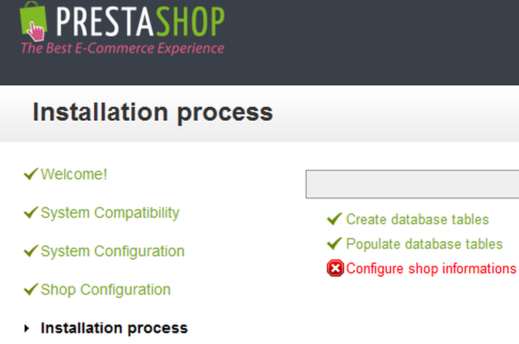

I tried to install prestashop on godaddy hosting company.
I created database and made everything by the protocol.
After completing step 4 - "shop configuration" the gray window appears and than nothing.
it get stucks.
I entered my store domain and saw that the store is up and "working".
how can i know if the installotion went clearly?
thanks ahead,
Neap.

I too am using Godaddy hosting and installation gets stuck after completing Step 4 (same as above descriptions). The result of this is that it seems my site is up and running, except there is no way for me to access the back office as there is no admin account created.

I may have found a solution and a possible bug in prestashop.
As I am located in Hong Kong, I kept choosing Hong Kong as the location as well as the timezone.
And it seems that was what was causing step 4 to get stuck from moving forward. I chose France, and it worked fine. I then re-did everything and tried Hong Kong again, and same problem. Now I chose USA and it works fine again.
So those of you getting stuck on step 4, try changing your country.
