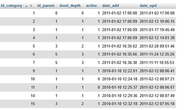

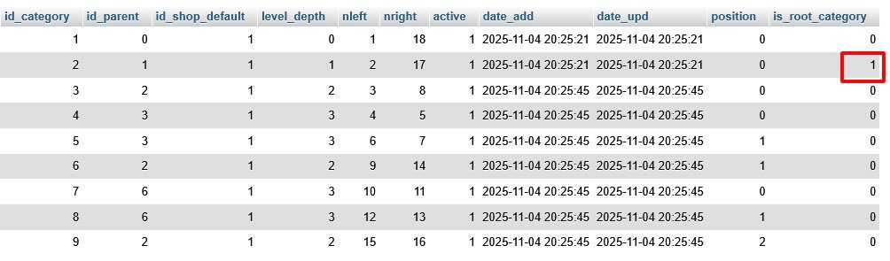

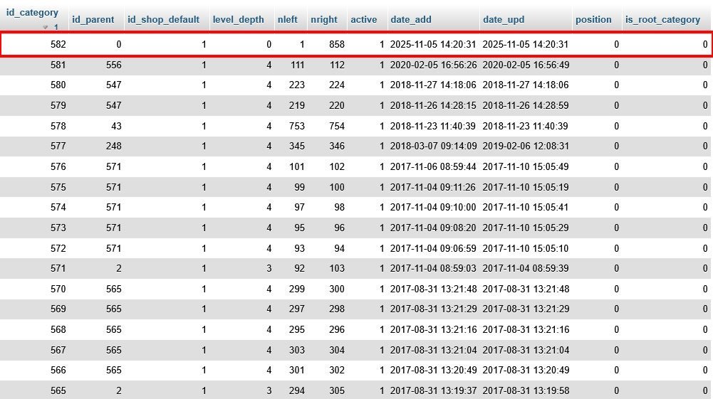

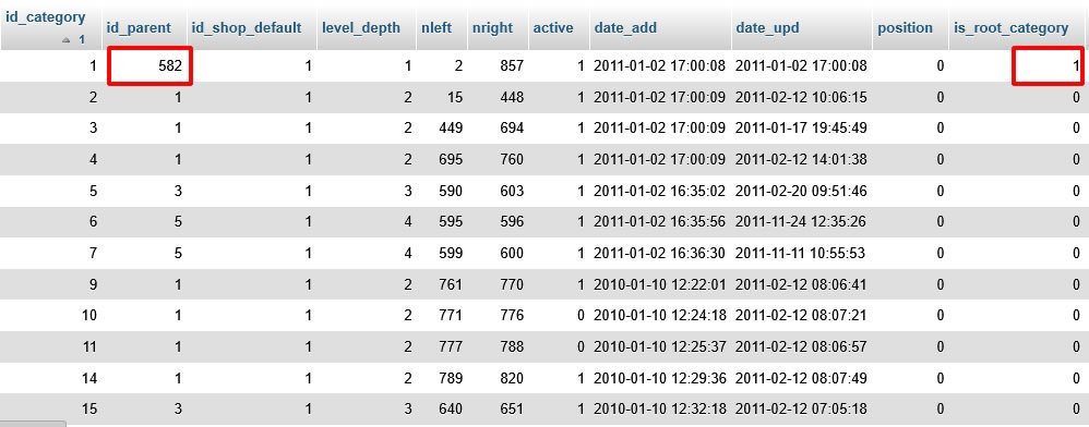

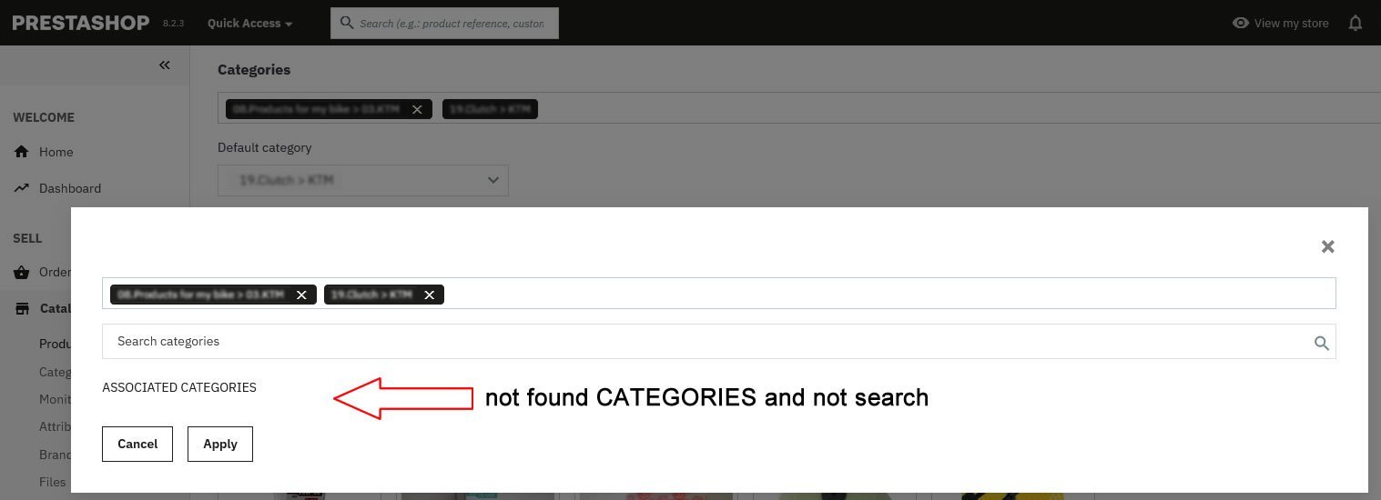

maniakpresta Posted November 6, 2025 Share Posted November 6, 2025 Hello. We migrated from Prestashop 1.3 to Prestashop 8. We discovered that we cannot manage the add or edit of categories to products. What we saw is that in the 1.3 database, category 1 is (HOME) and (root). In the Prestashop 8 database, category 2 is (HOME) and (root). In the database of 8 after the migrate, category 1 is (root) and category 2 is (HOME) Also, category 1 has id_parent (582), a category created during migration that did not exist in 1.3 and is not processed in the Prestashop back end (The object cannot be loaded (or found). First of all, I would like to ask if it is possible to migrate from Prestashop 1.3 to 8 and if there is a solution to the above problem. Thank you. Link to comment Share on other sites More sharing options...

musicmaster Posted December 3, 2025 Share Posted December 3, 2025 The new category is "root". It comes below your Home category. It was introduced in version 1.5 together with multi-shop. As it is created during the update to 1.5 it will have a high id number. Your category tree problems signal some problem with the nleft and nright fields. You could try my free Prestools. It has an Integrity Checks function that includes an option to regenerated this tree. I made some upgrade tools (Copy_shopdata and UpgradeHub ) but they won't go further back than 1.4.9 at the moment. Link to comment Share on other sites More sharing options...
Reha Ultimate Posted December 10, 2025 Share Posted December 10, 2025 In PrestaShop 1.5+ the category structure was changed, and the system expects: ID 1 = Root ID 2 = Home When a shop is migrated from very old versions (like 1.3), these IDs often remain reversed. As a result, the Back Office cannot correctly load or attach categories to products. In your migrated database the structure is incorrect: Category 1 is not Root Category 2 is not Home Category 1 even has an invalid parent (ID 582) This breaks the nested-set structure (nleft / nright) and causes exactly the issue you describe. The fix is: Set category ID 1 to be the real Root category: id_parent = 0 Correct values for nleft, nright, level_depth Set category ID 2 to be the Home category, with: id_parent = 1 Make sure all other categories connect under this tree properly. Regenerate the category nested set (nleft / nright) after correcting IDs. Prestools or the built-in Category::regenerateEntireNtree() can rebuild the tree. Once Root is ID 1 and Home is ID 2—as PrestaShop 8 requires—the product category selector will work normally again. Link to comment Share on other sites More sharing options...
