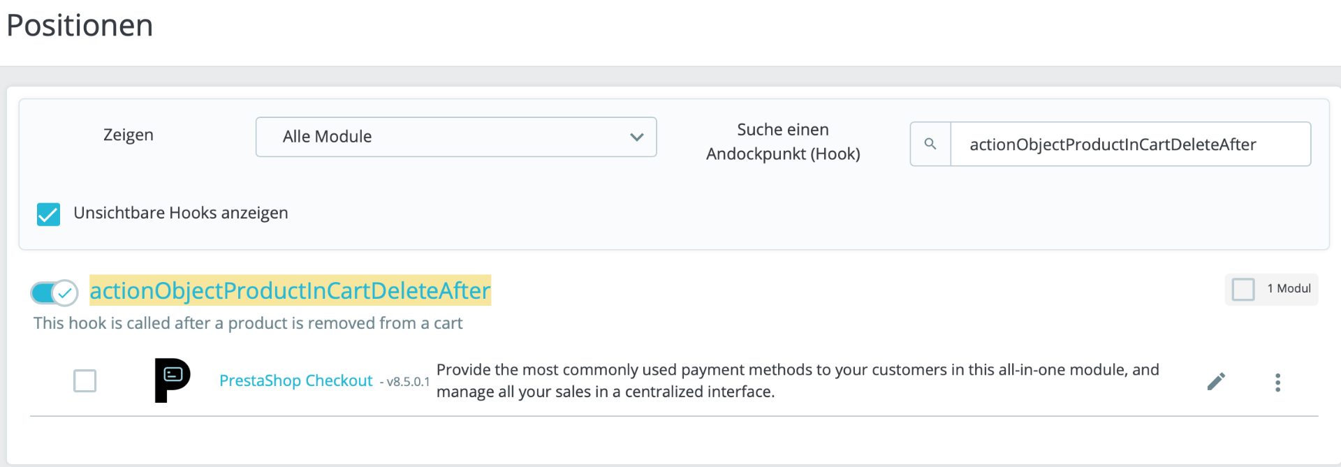

El Patron Posted Saturday at 02:30 PM Share Posted Saturday at 02:30 PM Usual suspect: a module hooked on cart-delete Go to: Design → Positions (in older builds, “Improve → Design → Positions”). Search the hook also select: Display non-positionable hooks In the search bar at the top-right of that page, type one of: actionObjectProductInCartDeleteAfter or (for legacy modules) actionDeleteProductInCartAfter If a module is registered on that hook, it will appear in the results table. Sometimes the problem module is using an older or slightly different hook name: actionObjectCartDeleteAfter actionCartSave actionObjectCartRemoveProductAfter actionCartUpdateQuantityBefore Link to comment Share on other sites More sharing options...
harald.thomas Posted Saturday at 02:34 PM Author Share Posted Saturday at 02:34 PM only one module registered: Link to comment Share on other sites More sharing options...
El Patron Posted Saturday at 02:44 PM Share Posted Saturday at 02:44 PM 8 minutes ago, harald.thomas said: only one module registered: this looks legitimate. Did you check other hooks? Also enable debug mode and replicate issue and make sure to check error log in hosting. Link to comment Share on other sites More sharing options...

Daresh Posted Saturday at 03:25 PM Share Posted Saturday at 03:25 PM Weird indeed. Like @El Patron wrote, it may be something hooked to 'actionObjectProductInCartDeleteAfter', but the only module that is there is PrestaShop Checkout. Are you using it? If not, disable or uninstall. Link to comment Share on other sites More sharing options...
El Patron Posted Saturday at 03:58 PM Share Posted Saturday at 03:58 PM 36 minutes ago, harald.thomas said: This is the Link for the remove from car icon (X): <a class="remove-from-cart" rel="nofollow" href="https://xxxxxxx/warenkorb?delete=1&id_product=249&id_product_attribute=0&token=xxxxxxxxxx" data-link-action="delete-from-cart" data-id-product="249" data-id-product-attribute="0" data-id-customization=""><i class="material-icons"></i></a> this is normal 23 minutes ago, Daresh said: Weird indeed. Like @El Patron wrote, it may be something hooked to 'actionObjectProductInCartDeleteAfter', but the only module that is there is PrestaShop Checkout. Are you using it? If not, disable or uninstall. I did check that prestashop checkout does is hooked here normally, at least on a 9.0.0. to narrow down try the following: Disable all overrides (Advanced Parameters → Performance) and re-test. If the deletion stops, inspect override/classes/Cart.php, override/classes/Product.php, or any controller override. In Back Office go to Advanced Parameters → Performance. Under Debug mode, switch Enable Debug Mode to Yes and Save. Reproduce and collect the profiler data at the bottom of the footer of our website. This will provide a lot of insights you may not have already collected. Link to comment Share on other sites More sharing options...
