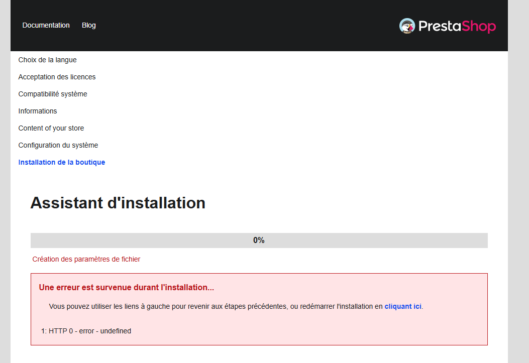

ZeSpecialK Posted January 25, 2025 Share Posted January 25, 2025 Hi all, I'll try to install Prestashop 8.2.0 on localhost with Wamp. Wamp is setted with Php 8.1.31, MySQL on 5.7.44, Apache on 2.4.62.1. I've tried differents solutions but nothing happen.... During the install process, I receive an error message 'HTTP 0 - error - undefined'. How to exit of this deadlock ? Thank you by advance ! Link to comment Share on other sites More sharing options...

ZeSpecialK Posted January 27, 2025 Author Share Posted January 27, 2025 (edited) 13 minutes ago, Nickz said: Have you seen this one? @Nickz Yes ! (see attached screenshot below) But how to set permissions to 755 on index.php and instal/index.php on a Windows NFT sys ? Edited January 27, 2025 by ZeSpecialK (see edit history) Link to comment Share on other sites More sharing options...

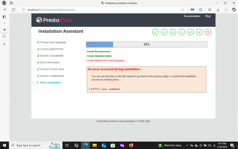

merkfritz Posted February 24, 2025 Share Posted February 24, 2025 (edited) Just tried installing Prestashop 8.2.0 on WAMP64 and received the same error message at 23% Edited February 24, 2025 by merkfritz (see edit history) Link to comment Share on other sites More sharing options...

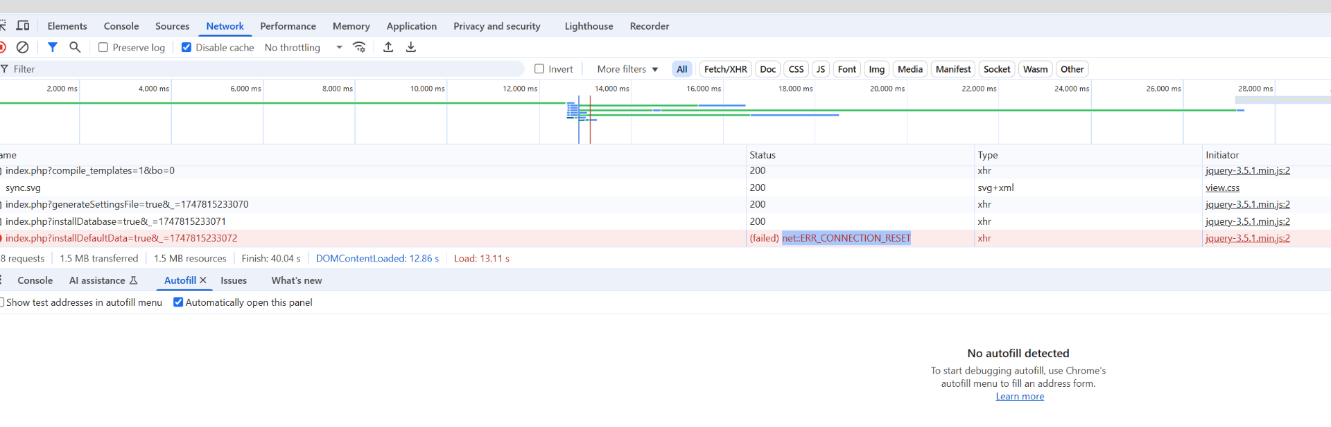

Crezco Posted May 21, 2025 Share Posted May 21, 2025 I'm getting crazy with this error, I tried almost everything. Looking Chrome development console you can see net::ERR_CONNECTION_RESET. I guess is something related with symphony but not sure. I need to work with wamp64. Any legend can help? Thanks, Link to comment Share on other sites More sharing options...
musicmaster Posted May 21, 2025 Share Posted May 21, 2025 (edited) Prestashop makes it at the moment very hard to install under Windows. Running is not a problem. So if you have the opportunity to install under Linux do that and copy the files and database to your Windows. The troubles started with version 8.0.6 if I remember well. So you can also try an older version. Edited May 21, 2025 by musicmaster (see edit history) Link to comment Share on other sites More sharing options...
Crezco Posted May 21, 2025 Share Posted May 21, 2025 Finally I solve problem. The problem was php_debug module that crashes with windows. Solution: desactivate php_xdebug from php.ini and reestart wamp64. My opinion wamp64 is a windows local server wery reliable. 1 Link to comment Share on other sites More sharing options...
