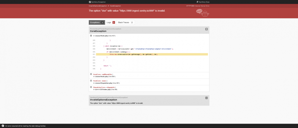

EcoPets Posted November 9, 2023 Author Share Posted November 9, 2023 Well now I am locked out of the back office. see attached. I looked in the ps_supplier table and there was only 1 supplier there and it was correct. Link to comment Share on other sites More sharing options...
musicmaster Posted November 11, 2023 Share Posted November 11, 2023 On 11/9/2023 at 9:02 PM, EcoPets said: Well now I am locked out of the back office. see attached. I looked in the ps_supplier table and there was only 1 supplier there and it was correct. Note that the DSN refers to the domain "sentry.io". Maybe your company is using some services from that company. Link to comment Share on other sites More sharing options...
EcoPets Posted November 11, 2023 Author Share Posted November 11, 2023 I have no idea what "sentry.io" is. I have no relationship with that entity that I am aware of. But this link seems to indicate it could be some part of Prestashop? It seems to follow much of what I was experiencing. There is nothing on my hosting server regarding SENTRY.IO, so maybe it is something within Prestashop? Link to comment Share on other sites More sharing options...
musicmaster Posted November 11, 2023 Share Posted November 11, 2023 28 minutes ago, EcoPets said: I have no idea what "sentry.io" is. I have no relationship with that entity that I am aware of. But this link seems to indicate it could be some part of Prestashop? It seems to follow much of what I was experiencing. There is nothing on my hosting server regarding SENTRY.IO, so maybe it is something within Prestashop? You are right. It is Prestashop that is using it. Try disabling the ps_mbo module. it has "https://###.ingest.sentry.io/###" in its settings. Link to comment Share on other sites More sharing options...
