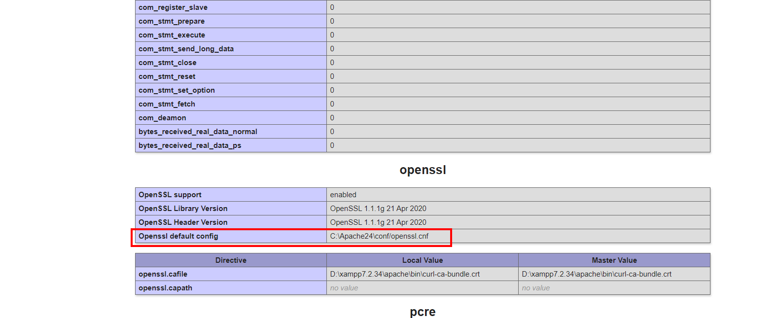

tdsoft Posted November 30, 2023 Share Posted November 30, 2023 On 8/11/2023 at 10:35 AM, acharya_02 said: i am trying to install prestashop and the following error is shown. 1. Use phpinfo() function to view Default Config OpenSSL.cnf 2.Copy file openssl.cnf from XAMPP to this directory, example: D:\xampp8212\php\extras\ssl\openssl.cnf 3. Restart Apache. 1 1 Link to comment Share on other sites More sharing options...

tdsoft Posted December 1, 2023 Share Posted December 1, 2023 I solved it in my posts. 1. Use phpinfo() function to view Default Config OpenSSL.cnf 2.Copy file openssl.cnf from XAMPP to this directory, example: D:\xampp8212\php\extras\ssl\openssl.cnf 3. Restart Apache. 1 Link to comment Share on other sites More sharing options...
Artepole Posted December 7, 2023 Share Posted December 7, 2023 On 12/1/2023 at 7:39 AM, tdsoft said: I solved it in my posts. 1. Use phpinfo() function to view Default Config OpenSSL.cnf 2.Copy file openssl.cnf from XAMPP to this directory, example: D:\xampp8212\php\extras\ssl\openssl.cnf 3. Restart Apache. Thanks Works fine on Wampserver too Link to comment Share on other sites More sharing options...
yanker Posted February 21 Share Posted February 21 I use WAMP 3.3.1 - Today 21/02/2024 I could solve this problem with this solution: 1. Use phpinfo() function to view Default Config OpenSSL.cnf --> Openssl default config (example: C:\Program Files\Common Files\SSL/openssl.cnf) 2.Copy file openssl.cnf from WAMPP to this directory, example: C:\wamp\bin\apache\apache2.4.54.2\conf 3. Restart Apache. Link to comment Share on other sites More sharing options...
