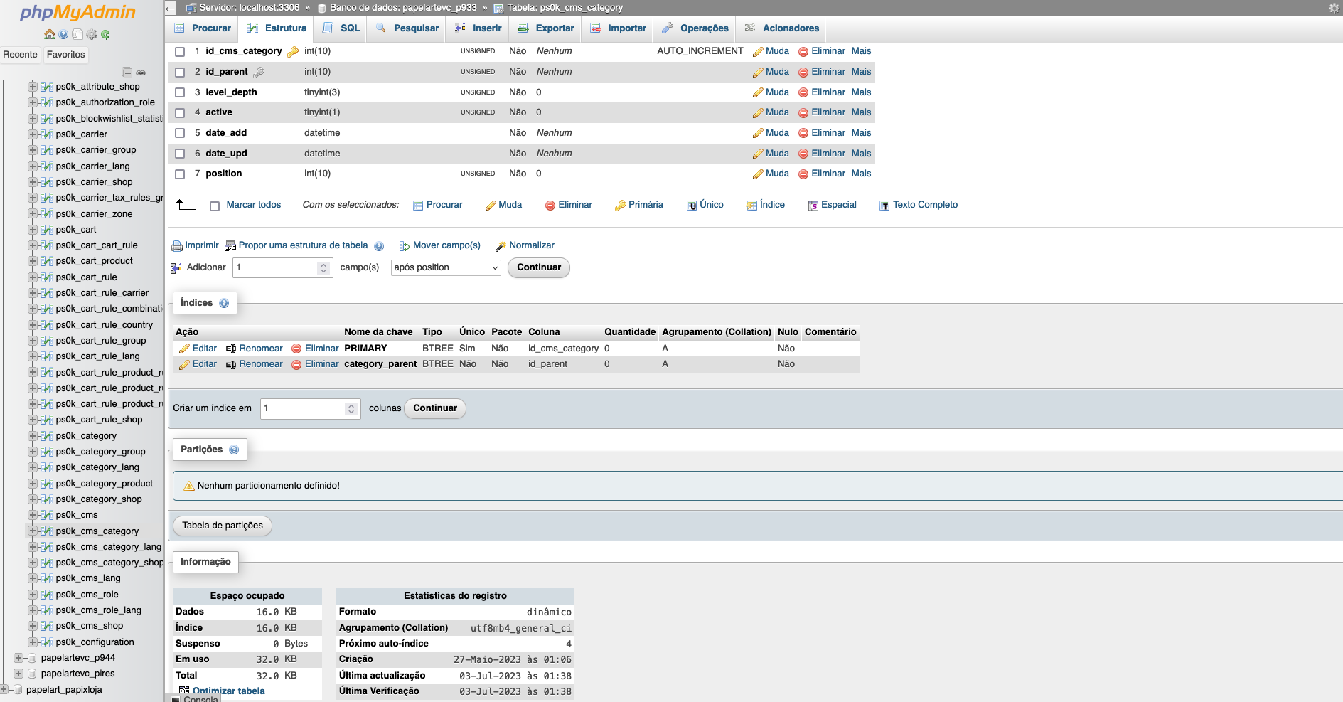

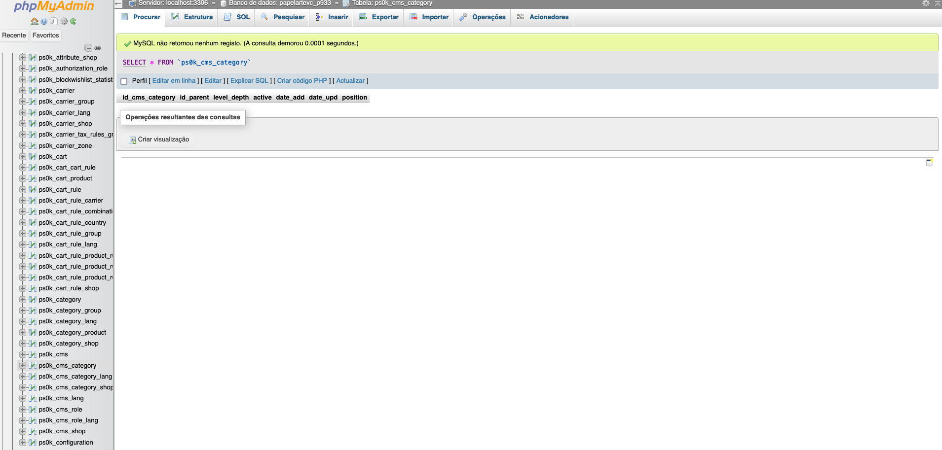

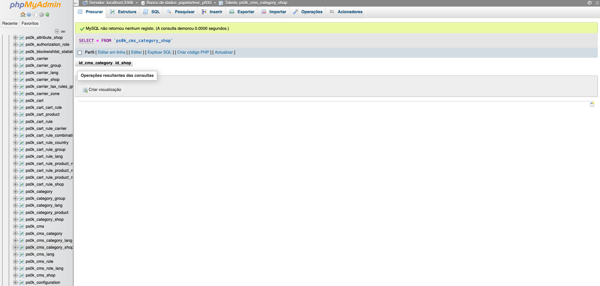

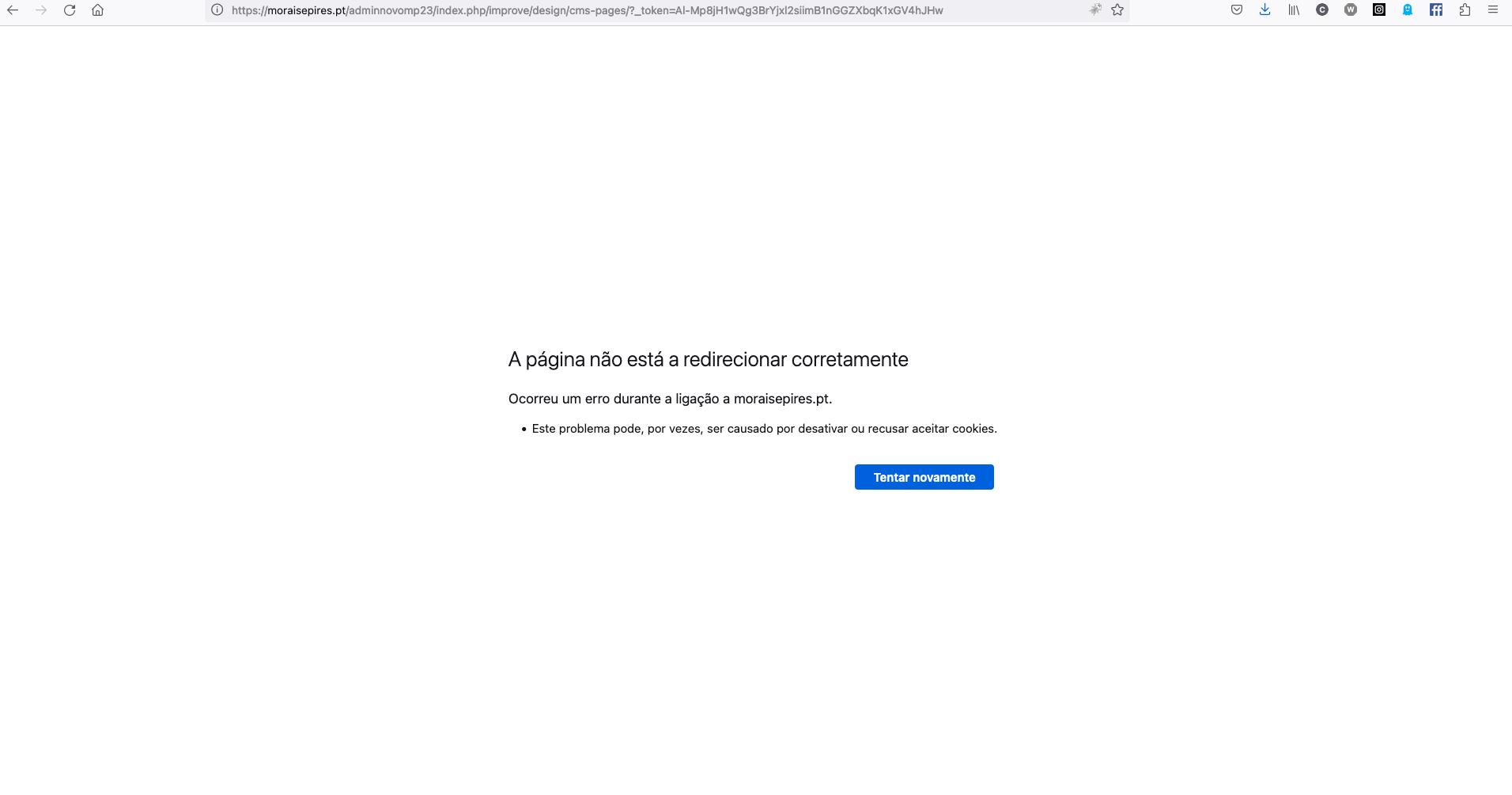

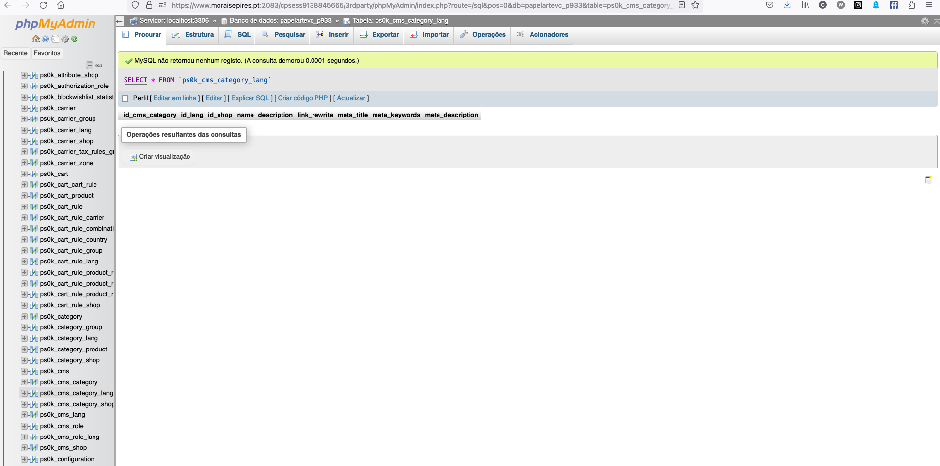

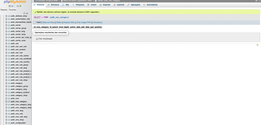

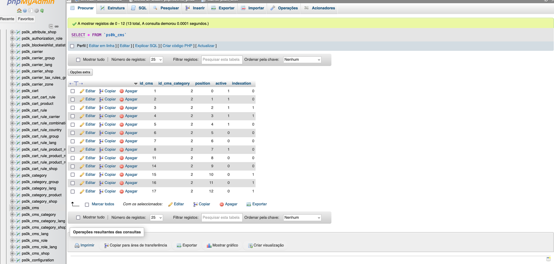

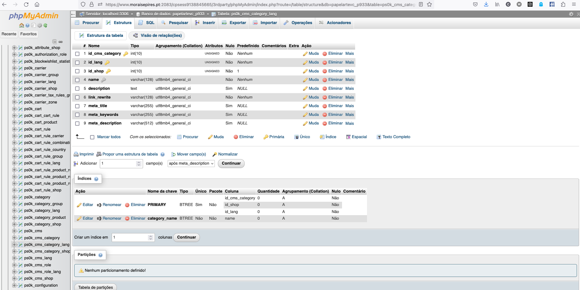

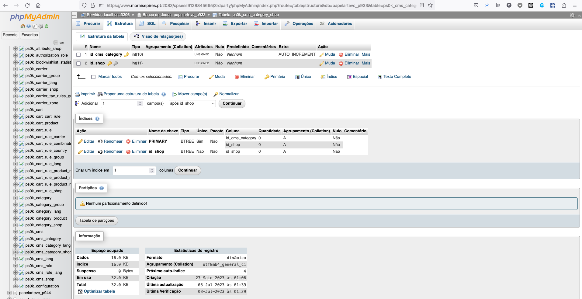

CarlosTeo Posted July 3, 2023 Share Posted July 3, 2023 Hi I have a tricky issue after migration my prestasho to 1.7.8.9. I can´t edit any CMS pages by BO ddesign > pages....cause he gave me a White page " ...to many redirections??'. My CMS are there cause I see them in ps_cms table. But...in ps_cms_category; ps-cms_category_lang; and ps_cms_category_shop the table don´t show the right figuration. only when I check de Structure it seems to be allright. (?) I´ve tried almost everything: diferente browsers, clean cash, show debug mode, unable disable module, transplant hook, several forums suggestions but nothing happens. Could some guardian angel give me a solution for this, please. Link to comment Share on other sites More sharing options...

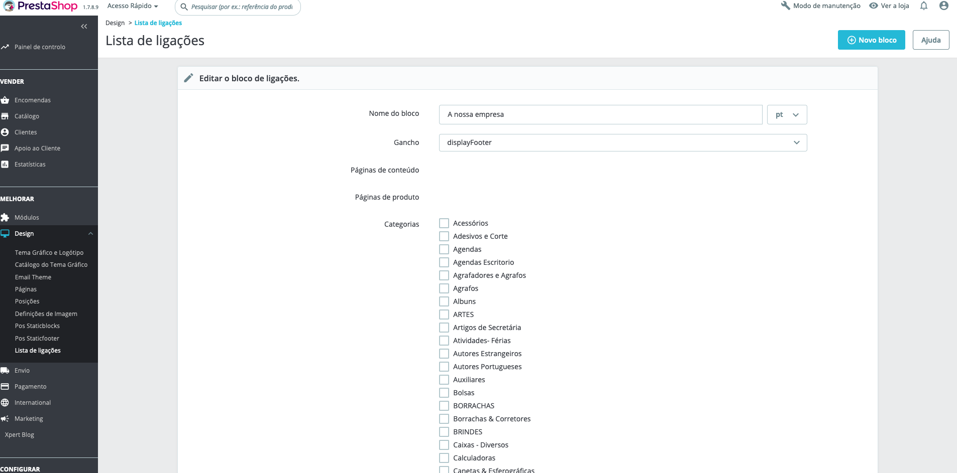

CarlosTeo Posted July 4, 2023 Author Share Posted July 4, 2023 19 hours ago, ComGrafPL said: SEO & URL: Have you set canonical to 301? Any modules for clean url's? Also on SEO & URL - Remove any "/" character at the end and "http" or "https" at the top of the Shop domain & SSL domain fields. Reset htaccess ( turn of friendly url - save - turn on ) Hi . Thank you for your help. I tried everything you suggest but with no results. As you see my Links show empty on "Product page" and "Content page". I don´t know how resolve this after hours/days trying. I call for the developers of theme but they say is nothing about theme.... Thank you for your help, again Link to comment Share on other sites More sharing options...
ps8modules.com Posted July 4, 2023 Share Posted July 4, 2023 Hi. If I'm not mistaken, you upgraded from Prestashop 1.6 to 1.7.8.9 by doing a clean installation of 1.7.8.9 and importing the database, or part of it from Prestashop 1.6. It is so ? The structure of database tables is different between these versions of Prestashop. That's why nothing works. Link to comment Share on other sites More sharing options...
CarlosTeo Posted July 4, 2023 Author Share Posted July 4, 2023 Yes ps8moduly.cz , you are right. But in the beginning it was working. I don´t know why suddendly the access to cms stops. (maybe I make a mistake to delete them and enable the module again) Thnaks Link to comment Share on other sites More sharing options...

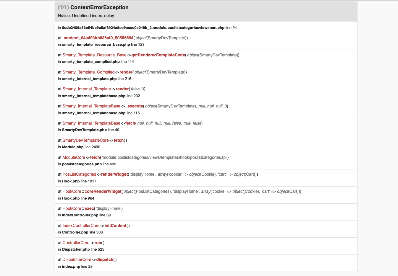

ps8modules.com Posted July 4, 2023 Share Posted July 4, 2023 The error is related to some poslistcategories module Link to comment Share on other sites More sharing options...

CarlosTeo Posted July 4, 2023 Author Share Posted July 4, 2023 1 hour ago, ps8moduly.cz said: The error is related to some poslistcategories module Apparently nothing linked to cms. I unable and enable it. Link to comment Share on other sites More sharing options...
