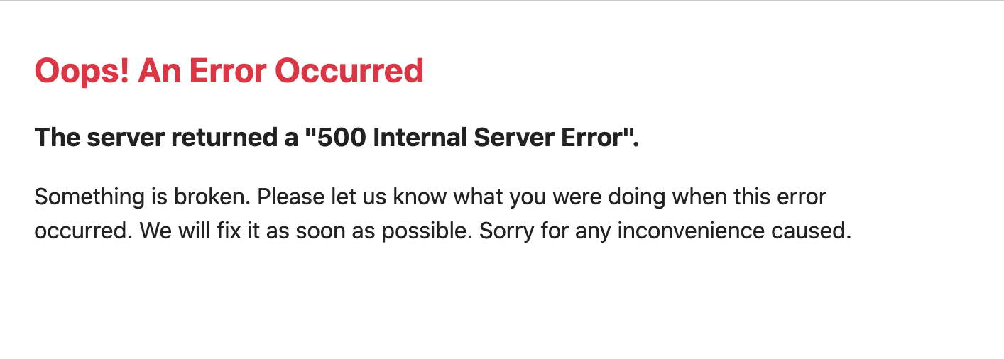

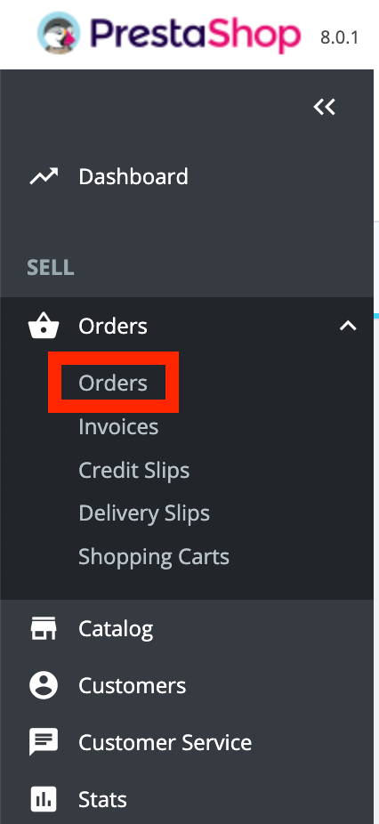

holtcomp Posted February 2, 2023 Share Posted February 2, 2023 I migrated a live site from 1.7.8.8 to 8.0.0 and the migration went okay using new version of 1 click upgrade. Unfortunately, I seemed to encounter a few problems with the new version and as the site was live my window for sorting out the issues was limited so I restored back to 1.7.8.8. I'll try again with 8.0.1 at some point. 1 Link to comment Share on other sites More sharing options...

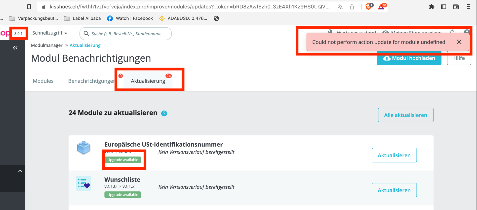

sbempire Posted February 16, 2023 Share Posted February 16, 2023 On 2/6/2023 at 5:38 AM, ps8moduly.cz said: Before upgrading to 8.0.1, you need to update all modules and mainly configure or install ps_accounts, ps_eventbus, ps_checkout, ps_mbo. Without up-to-date modules, you will run into problems after upgrading. The store must be in maintenance mode and debug mode must be disabled. I have already successfully upgraded 12 eshops 😉 Functions from PS 1.7.8.x are retained, only a few hooks have been added. The speed of 8.0.x is unmatched. Have the upgrade done by an experienced developer, otherwise you may face a marathon of several days 🙂 Upgrading to 8.0.1 went successfully. I noticed that most of the modules were deactivated after the upgrade. So I activated the modules I needed. However, the issue I found was most of the modules will need to be upgraded. unfortunately, when iI click for update of the modules, I got an error message that "could not perform action update for module undefined" as you can see in the attached screenshot. Do you have a tip how I can resolve the issues. Thank you Link to comment Share on other sites More sharing options...

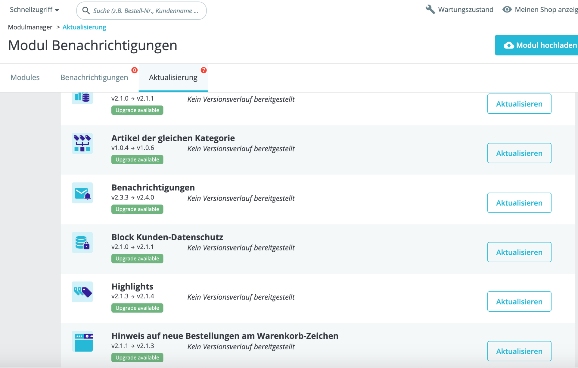

chipset Posted February 17, 2023 Share Posted February 17, 2023 17 hours ago, sbempire said: Upgrading to 8.0.1 went successfully. I noticed that most of the modules were deactivated after the upgrade. So I activated the modules I needed. However, the issue I found was most of the modules will need to be upgraded. unfortunately, when iI click for update of the modules, I got an error message that "could not perform action update for module undefined" as you can see in the attached screenshot. Do you have a tip how I can resolve the issues. Thank you I migrated from 1.6.24 to 1.7.8.8, then to 8.0.1 and the migration was very hard, but okay. The same thing happened to me on 2 of the tests. One was fixed when instead of upgrading all the modules, I did it one by one. The other was more persistent :). I finally uninstalled it, deleted it from the folder, deleted the traces from the database, then installed it successfully. The speed compared to 1.6 is much lower, but it might be because of the theme I'm using right now. Link to comment Share on other sites More sharing options...
sbempire Posted February 17, 2023 Share Posted February 17, 2023 2 hours ago, chipset said: One was fixed when instead of upgrading all the modules, I did it one by one. The other was more persistent :). I finally uninstalled it, deleted it from the folder, deleted the traces from the database, then installed it successfully. Hi chipset, thank you for your response. I migrated from ps 1.7.8.7 to 8.0.1. I am not suspecting that could be the issue. like you mentioned, I have tried individually upgrading the modules but it didn't work. For more clarity, when you said "deleted it from the folder, deleted the traces from the database" do mean uninstalling, deleting folders from file manager in the server and clearing cache to remove the traces? Thank You Link to comment Share on other sites More sharing options...

sbempire Posted February 21, 2023 Share Posted February 21, 2023 Hi, in the screenshot are the list of modules which are not responding to upgrade. Please does anybody have information regarding the modules as to why they wouldn't be updated or upgraded? Thank you. Link to comment Share on other sites More sharing options...

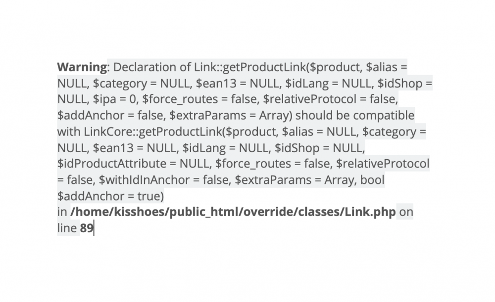

sbempire Posted February 21, 2023 Share Posted February 21, 2023 ... I saw this warning on the screenshot when I activated the debug mode. Can someone see what the error is here? Thank you. Link to comment Share on other sites More sharing options...
chipset Posted February 22, 2023 Share Posted February 22, 2023 From what can be seen, one of the other modules or themes is using some kind of override. It probably interferes for the normal installation. You can try to temporarily remove these overrides or uninstall the modules that use them. Be sure to make a backup first! Link to comment Share on other sites More sharing options...

sbempire Posted February 22, 2023 Share Posted February 22, 2023 6 hours ago, chipset said: From what can be seen, one of the other modules or themes is using some kind of override. It probably interferes for the normal installation. You can try to temporarily remove these overrides or uninstall the modules that use them. Be sure to make a backup first! ok thanks. In my case, Prestaspeed module seems to be the cause. I have renamed the module and everything seems to be working now, except from the order link which shows error message. Link to comment Share on other sites More sharing options...
chipset Posted February 22, 2023 Share Posted February 22, 2023 3 hours ago, sbempire said: ok thanks. In my case, Prestaspeed module seems to be the cause. I have renamed the module and everything seems to be working now, except from the order link which shows error message. 3 things that can help: 1. Regenerate .htaccess 2. Check if there is anything left from prestaspeed in link.php, for example 3. delete everything from folder /var/cache Link to comment Share on other sites More sharing options...
sbempire Posted February 24, 2023 Share Posted February 24, 2023 On 2/22/2023 at 7:47 PM, chipset said: 3 things that can help: 1. Regenerate .htaccess 2. Check if there is anything left from prestaspeed in link.php, for example 3. delete everything from folder /var/cache Hi chipset, thanks. It didn't solve the problem. I will see what else I can do. Thank you for you support 1 Link to comment Share on other sites More sharing options...

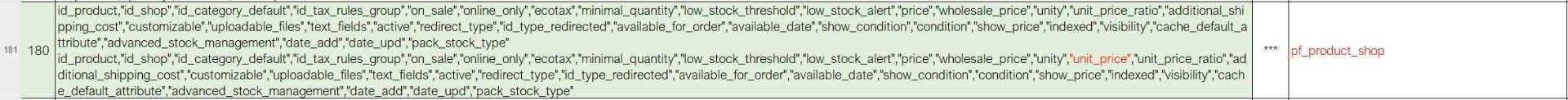

ccristian Posted January 3, 2024 Share Posted January 3, 2024 Reading about how to MIGRATE from 1.7.8.10 to 8.1.2 (manual mode, fresh install of 8.1.2 + copy the database tables from 1.7) we notice that some modules (not all) suffering from table data changes, that's why we decided to give up the idea of doing it automatically using 1-Click upgrade. for example in the ps_customer_session table in PS v8.1.2 they added at the end of table 2 new columns: id_customer_session,"id_customer","token" id_customer_session,"id_customer","token","date_add","date_upd" I noticed that some tables have changed the order of the data columns, for example ps_shop table: id_shop,"id_shop_group","name","id_category","theme_name","active","deleted","color" id_shop,"id_shop_group","name","color","id_category","theme_name","active","deleted" Conclusion, if you intend to migrate from PrestaShop v1.7.8.10 to 8.1.2 we advice you take into consideration of checking which tables are suffering from data changes and make a manual modification of the data in those tables. Please please correct me if I'm wrong... Link to comment Share on other sites More sharing options...

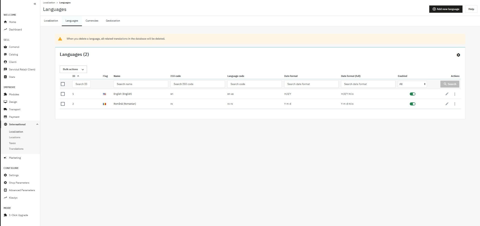

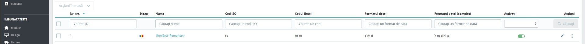

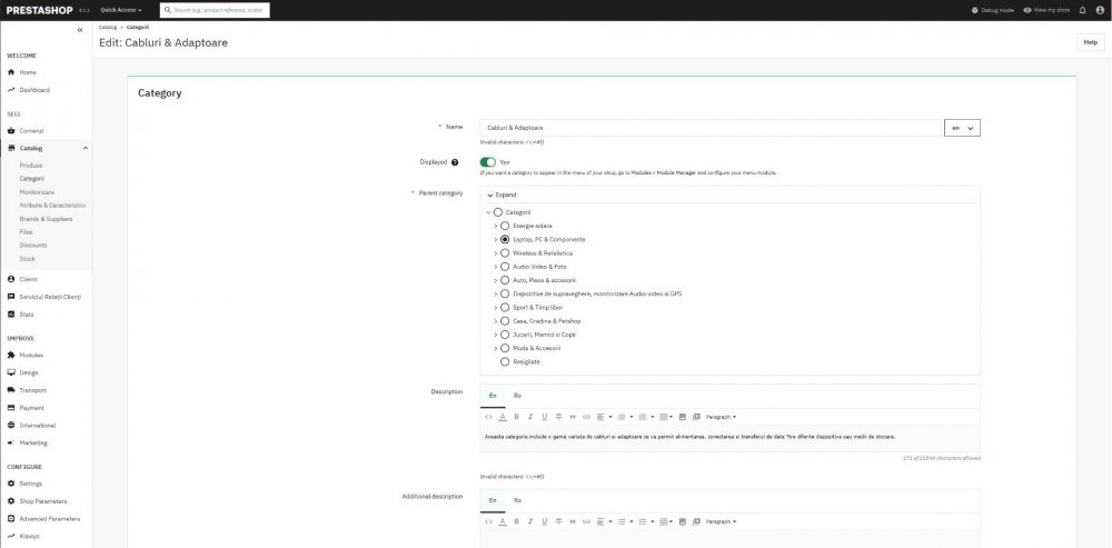

ccristian Posted January 7, 2024 Share Posted January 7, 2024 Trying to move our live store content (we did that moving the database tables manualy) from PrestaShop 1.7.8.11 (Romanian default language, no other languages installed) into PrestaShop 8.1.2 (which have 2 languages installed, English first then Romanian the second one) we notice that the content of the Category names, Description, Additional description etc. it's placed on the English language, since this is the first language in the new store. We don't want that since our products are addressed to Romanian clients....so anyone can help us understand how do we change the content of the tables structure to move the content from English (as it is right now) to Romanian language into new store? Thank you! Link to comment Share on other sites More sharing options...
ccristian Posted January 7, 2024 Share Posted January 7, 2024 2 hours ago, ccristian said: Trying to move our live store content (we did that moving the database tables manualy) from PrestaShop 1.7.8.11 (Romanian default language, no other languages installed) into PrestaShop 8.1.2 (which have 2 languages installed, English first then Romanian the second one) we notice that the content of the Category names, Description, Additional description etc. it's placed on the English language, since this is the first language in the new store. We don't want that since our products are addressed to Romanian clients....so anyone can help us understand how do we change the content of the tables structure to move the content from English (as it is right now) to Romanian language into new store? Thank you! we figured out how to do that, we changed the default store language from EN to RO. thank you anyway! Link to comment Share on other sites More sharing options...

ericshane Posted March 4, 2024 Share Posted March 4, 2024 I recently upgraded a live site from version 1.7.8.8 to 8.0.0 using the new 1-click upgrade feature. While the migration itself went smoothly, I encountered some issues with the new version. Due to the live nature of the site, I had limited time to troubleshoot, so I reverted back to 1.7.8.8. I plan to give version 8.0.1 another shot in the future. Link to comment Share on other sites More sharing options...
