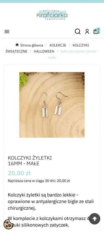

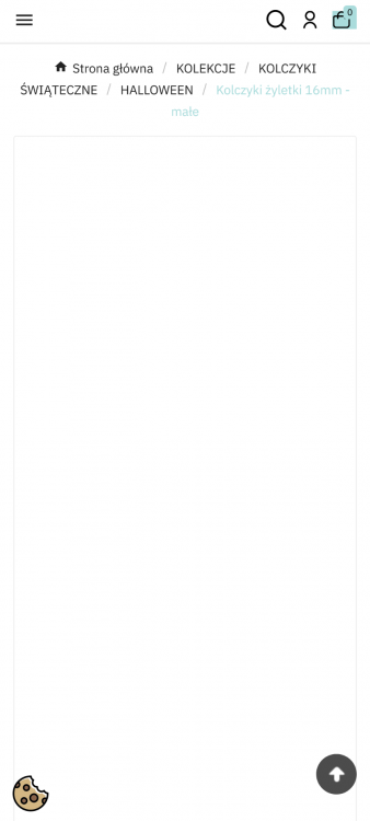

Xymor Posted July 8, 2024 Share Posted July 8, 2024 (edited) 9 hours ago, Nickz said: Developers press some of their thinking toward the customer. Its not based on UX in most cases. If that happens have a look how many people visit the gallery first. Taking Search engine and user behavior into account a gallery does not make sense. I'm not sure if I understand you correctly, but it's probably because I didn't explain it thoroughly. I'm talking about product photos on the product page, not a separate photo gallery. If I disable the blog module (tvcmsblog), each page scroll changes the correctly functioning page: to: With the blog module (tvcmsblog) enabled, everything returns to normal. But what can you expect from a company that has a link to support on its own website in the form: <a href="mailto:support@yourdomain.com"> Email us at [email protected]</a> https://themevolty.com/contact-us Edited July 8, 2024 by Xymor (see edit history) Link to comment Share on other sites More sharing options...

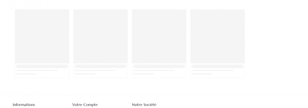

LJT Posted September 7, 2024 Share Posted September 7, 2024 Hello all i am in 8.1.7 and use a themevolty theme. It seems i have almost the same problem. My homepage fit all in the screen (no scroll) As long as i dont "move" in the page (resize it in this case), the module used dont appear... I contact the support but no news about this problem from last tuesday. If you know how to remove the icon where customers can change theme option, i need it too. best regards Link to comment Share on other sites More sharing options...

LJT Posted October 20, 2024 Share Posted October 20, 2024 Hello, the themevolty support correct my problem. They take pc PC remotly and using my session (without give themn my admin pwd) Their theme are very beautiful, but not sure that all the coding norms were respected O_o Link to comment Share on other sites More sharing options...
