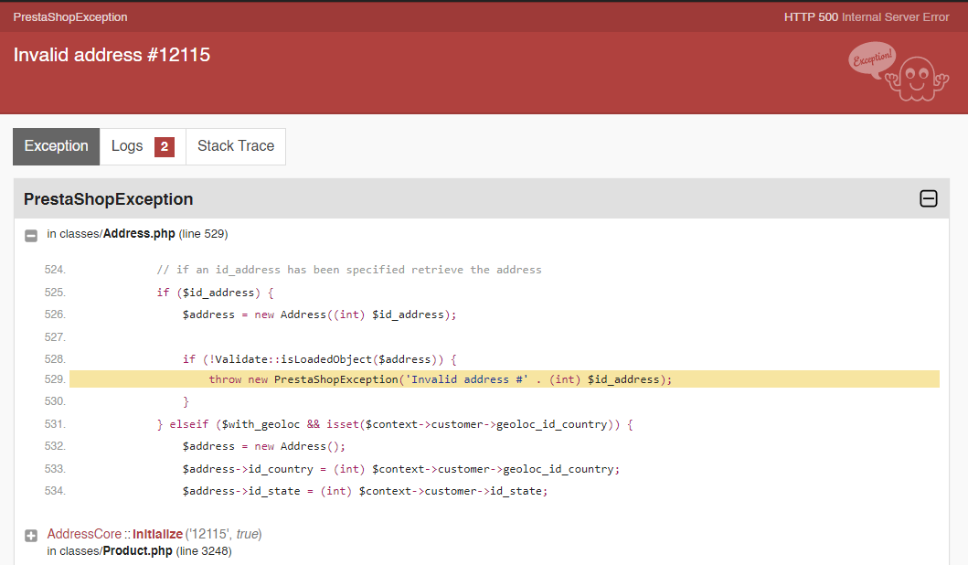

annadumi Posted September 8, 2022 Share Posted September 8, 2022 Hello, I have this issue with a customer. I checked in the database; he updated his address a few minutes before his order. I saw that a solution is to delete ps_cart content, but my question is: will it affect the BO orders section? The orders will be still there? Thank you Link to comment Share on other sites More sharing options...

annadumi Posted September 9, 2022 Author Share Posted September 9, 2022 Hello, Thank you for your answer. Hmm, the problem is that the user updated his address, and in ps_address I don't have the row with the old address (the one with id 12115 in ps). It will be ok if I duplicate a row and add the 12115 id manually? Thank you Link to comment Share on other sites More sharing options...

annadumi Posted September 9, 2022 Author Share Posted September 9, 2022 The problem is that after updating the address the row doesn't exist in the database. Initially, the user has id 12115; he makes an update and adds 12117 row. After 3 months he made another update and now he has 16555 row. The 12117 row still exists, but the first one 12115 is not in the database anymore. I checked for special characters or something like that and the text is fine. Link to comment Share on other sites More sharing options...

annadumi Posted September 9, 2022 Author Share Posted September 9, 2022 Yes, the address has all fields filled. But if I try to see more info about this customer his account refers to the old address which is not in the database anymore (I can't understand what he did but the row is missing) Link to comment Share on other sites More sharing options...
Rhobur Posted September 9, 2022 Share Posted September 9, 2022 It is normal the address is recreated with the new id what should happen though is for the other address ids to be removed form the other tables where they are referenced. Link to comment Share on other sites More sharing options...

edoluz Posted February 7 Share Posted February 7 On 11/16/2023 at 9:10 AM, c64girl said: I fixed with this if someone interested: https://prestamaniacs.com/free-modules/92-fix-invalid-address.html Thank you so much. This page helped me solving the problem: I didn't download the module but (can be a little risky because you are using Phpmyadmin and Mysql, so you should make a backup first to stay safe) I went into the ps_cart table and found the customer's carts Then I found the cart that was broken (it contained an address id that doesn't exist anymore, maybe after a PS upgrade made by an external agency who cleaned some data) and I replaced the old address id with an existing one of the same customer Now I cann access the customer's page in BO and edit it. Thank you all! Link to comment Share on other sites More sharing options...
