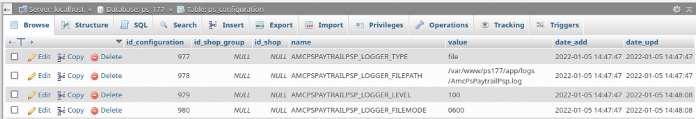

Teemu Mäntynen Posted May 14, 2022 Share Posted May 14, 2022 Modules typically save their setting to database table DBPREFIX_configuration (default DBPREFIX_ is "ps_"). Module settings aren't removed automatically by PrestaShop when a module is uninstalled. Each module needs to take care of removing its own settings during its uninstallation. Some modules ignore it or choose not to do so. Please see attached screenshot. It shows how a module named AmcPsPaytraiPsp has saved some of its setting to database. Be careful if you choose to manually delete module settings. 1 Link to comment Share on other sites More sharing options...

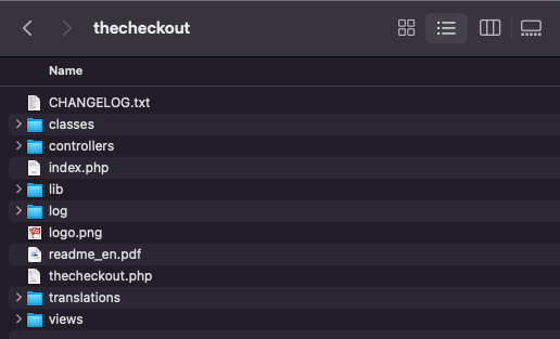

Success Posted May 16, 2022 Author Share Posted May 16, 2022 I don't find anything.. I don't even know what exacly I have to search... Would you help me a little more plz 🙂 I wanted to upload file thecheckout.php but couldn't. Link to comment Share on other sites More sharing options...
Nickz Posted May 16, 2022 Share Posted May 16, 2022 (edited) 37 minutes ago, Success said: I wanted to upload file thecheckout.php but couldn't. what kind of Hosting do you have? Looks like permission. The Module folder is there twice, one under the root folder the other under theme > theme name. Edited May 16, 2022 by Nickz (see edit history) Link to comment Share on other sites More sharing options...
Success Posted May 16, 2022 Author Share Posted May 16, 2022 (edited) I already wrote that when I uninstall The Checkout module, I also delete folders /modules/thecheckout, /themes/mytheme/modules/thecheckout and /themes/child-theme/modules/thecheckout. But settings of The Checkout module still remains. That's why I am asking you where are all other folders of that module.. I can't find it in Database.. Problem is that there is something wrong with css and I want to do it from the beginning. Edited May 16, 2022 by Success (see edit history) Link to comment Share on other sites More sharing options...

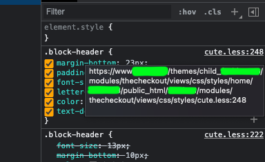

Success Posted May 16, 2022 Author Share Posted May 16, 2022 This is the problem (see photo). Something is wrong with patch to css document and I can't solve this problem. If I go to cpanel, there is no new folder "home" and further.. Link to comment Share on other sites More sharing options...
