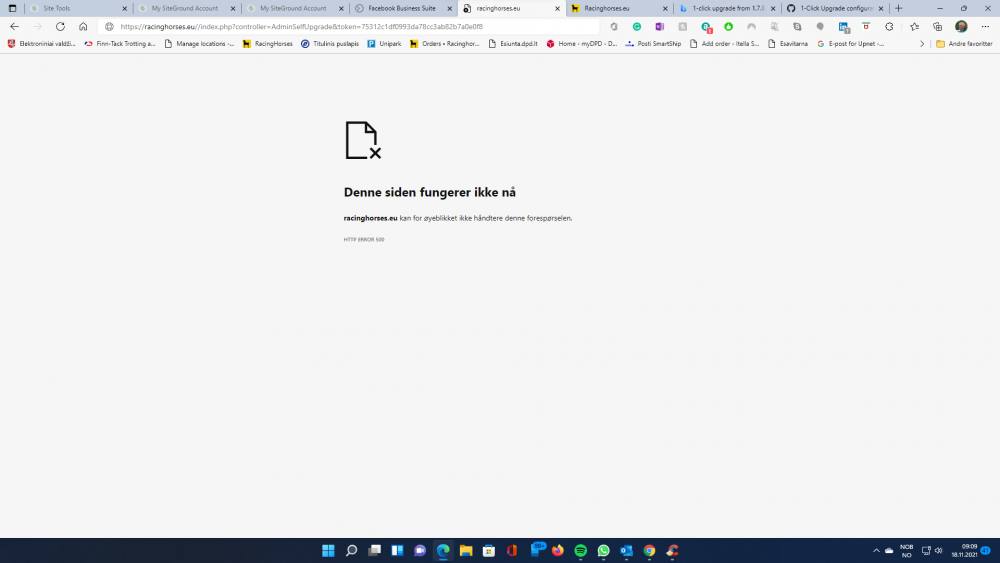

Vidar Bjerkeland Posted November 18, 2021 Share Posted November 18, 2021 I have tried to update from 1.7.8.0 to 1.7.8.1 using 1-click upgrade. When clicking on the 1-click upgrade in admin-panel, I get immediately an HTTP 500 ERROR. The log on the SiteGround server shows this error: It appears that this problem is related to the actual application and not the server. As soon as I try to open the "1-click Upgrade". the following error is being generated: 2021-11-17 12:46:59.253045 [Wed Nov 17 12:46:59.252997 2021] [:error] [pid 9066] [client 82.118.240.146:44610] PHP Fatal error: Uncaught Error: Class 'Symfony\Component\Debug\Exception\FatalThrowableError' not found in /home/customer/www/racinghorses.eu/public_html/vendor/symfony/symfony/src/Symfony/Component/Debug/ErrorHandler.php:559, referer: https://racinghorses.eu//index.php?controller=AdminDashboard&token=abb00599a85666a8b03a7cb1d49fb75f 2021-11-17 12:46:59.253095 [Wed Nov 17 12:46:59.253028 2021] [:error] [pid 9066] [client 82.118.240.146:44610] Stack trace:, referer: https://racinghorses.eu//index.php?controller=AdminDashboard&token=abb00599a85666a8b03a7cb1d49fb75f 2021-11-17 12:46:59.253101 [Wed Nov 17 12:46:59.253065 2021] [:error] [pid 9066] [client 82.118.240.146:44610] #0 [internal function]: Symfony\Component\Debug\ErrorHandler->handleException(Object(Error)), referer: https://racinghorses.eu//index.php?controller=AdminDashboard&token=abb00599a85666a8b03a7cb1d49fb75f 2021-11-17 12:46:59.253104 [Wed Nov 17 12:46:59.253071 2021] [:error] [pid 9066] [client 82.118.240.146:44610] #1 {main}, referer: https://racinghorses.eu//index.php?controller=AdminDashboard&token=abb00599a85666a8b03a7cb1d49fb75f 2021-11-17 12:46:59.253142 [Wed Nov 17 12:46:59.253125 2021] [:error] [pid 9066] [client 82.118.240.146:44610] thrown in /home/customer/www/racinghorses.eu/public_html/vendor/symfony/symfony/src/Symfony/Component/Debug/ErrorHandler.php on line 559, referer: https://racinghorses.eu//index.php?controller=AdminDashboard&token=abb00599a85666a8b03a7cb1d49fb75f I would be very thankful for any advise who can let me solve this problem with the version upgrade of my 1.7.8.0 PrestaShop Multistore. Link to comment Share on other sites More sharing options...

Vidar Bjerkeland Posted November 23, 2021 Author Share Posted November 23, 2021 please be aware that due to the latest changes the ZipArchive::extractTo functionality triggered by the module is causing a very large number of files to be opened at the same time. The limit on SiteGround GoGeek plans is 4096 which should be enough for the functionality of most applications. It appears that with the latest changes in the module it tries to open more than 16 000 files while attempting the upgrade. This is a very increased value and they are not able to adjust their servers to match the demand. So, with SiteGround, the only solution will be to upgrade to their solution> Jump Start 80,00€/mo EXCL. VAT Link to comment Share on other sites More sharing options...
Sashok Posted November 23, 2021 Share Posted November 23, 2021 5 minutes ago, cassandra8 said: I am on siteground as well and the same thing happened to me. How were you able to fix? I had updated a couple of weeks ago and just got around to opening when this happened. I tried to restore to that point but still returns a 500 error. In this case, the reason was from the server side... new kernel 1.7.8.x is more demanding on server resources (for example, the value of the ulimit parameter) therefore only works well on tuned VPS or VDS There should be a more accurate text of your error in the webserver logs or in the prestashop logs: /var/logs How may I help you? Link to comment Share on other sites More sharing options...

Arno Peck Posted December 16, 2021 Share Posted December 16, 2021 Same problem, Trying to update to prestashop_1.7.8.2 in a Siteground hosted site, and I have tis error in the log of the updater: [INTERNAL] /home/customer/www/DOMAIN/public_html/modules/autoupgrade/classes/ZipAction.php line 154 - ZipArchive::extractTo(/home/customer/www/DOMAIN/public_html/ADMIN/autoupgrade/latest/localization/CLDR/core/common/main/fo.xml): failed to open stream: Too many open files Link to comment Share on other sites More sharing options...
SmartDataSoft Posted December 16, 2021 Share Posted December 16, 2021 4 hours ago, Arno Peck said: Same problem, Trying to update to prestashop_1.7.8.2 in a Siteground hosted site, and I have tis error in the log of the updater: [INTERNAL] /home/customer/www/DOMAIN/public_html/modules/autoupgrade/classes/ZipAction.php line 154 - ZipArchive::extractTo(/home/customer/www/DOMAIN/public_html/ADMIN/autoupgrade/latest/localization/CLDR/core/common/main/fo.xml): failed to open stream: Too many open files You site is shared or dedicated. The error logs problem in file node limit of the server . Some server has file limit or space limit. It occure error at the time of unzip the file due to many files. Thank you Link to comment Share on other sites More sharing options...
