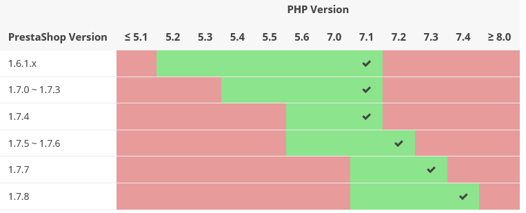

Here's little advice.
Screenshot 2021-07-17 at 15-45-42 System requirements for PrestaShop 1 7.png
34 minutes ago, webthinkers said:
thanks will try php 7.2
You need to satisfy also the prestashop requirements, curl, pdo driver and a bunch of others.
I would also go with ubuntu 18.4 there is more info for the lone developer and all packets/libraries  are distributed
Edited by Nickz (see edit history)
28 minutes ago, webthinkers said:
Right now working on Ubuntu 21.04
Good luck with that.
It more likely that you will have issues if going newest version due to linux' nature having to distribute all parcels to their infrastructure. That preocedure can cost about 6 month to 18. It won't be a problem if you are at home with Servers and php development.
