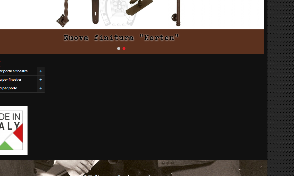

I have a shop on prestashop and today, after modifying some .tpl files of the theme and I realized that my products featured on the home were no longer visible
I went back, using my files from a few days ago with the perfect theme, but still the products on the home are not visible
Reading the code it turns out that the home is just empty
"section # content.home-page" empty
I deactivated, reset, and put back the showcase and home modules, but still nothing
I am attaching the image where it shows that under the image slider, next to the tree menu and above the image above the footer, there is nothing
Can you give me a hand?
I'm desperate
Thank you

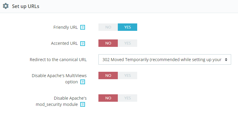

You can also try with reset disable and enable friendly urls for reset. Clear the cache after.

How does it work for the friendly urls thing? How can I proceed?
